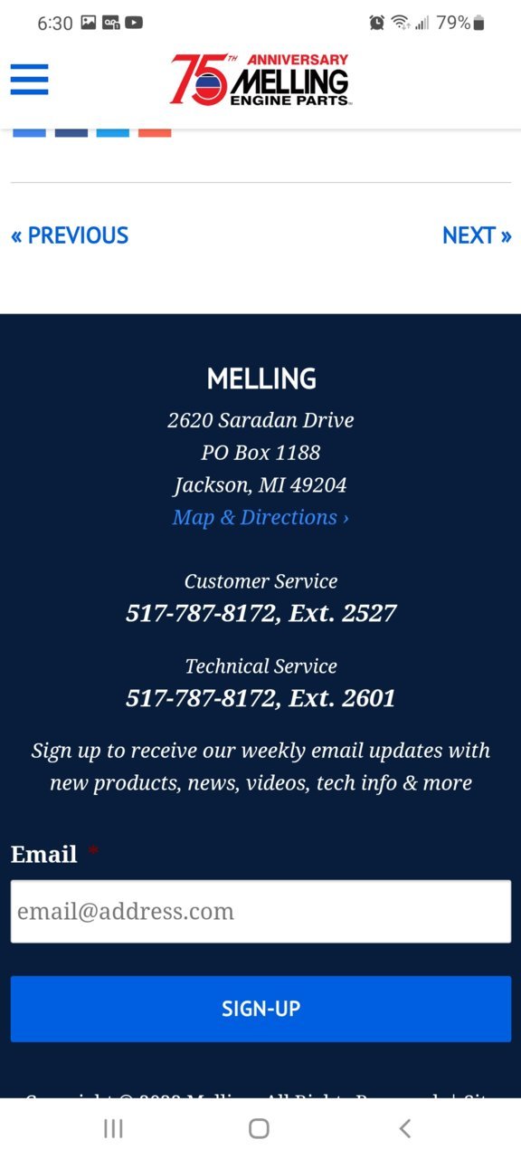

    Melling is a legit company in my hometown. They were big in the domestic aftermarket. I've ran their internals in Chevy 350 v8 builds years ago. Not sure if they are in the Toyota game now but they have a good reputation overall.

    I have looked into them. They don't have a flanged sleeve option that will work.
