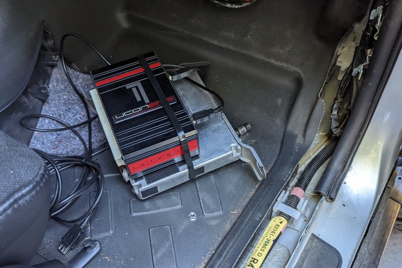

  12. Feb 18, 2022 at 2:49 PM
    jamesepoop
    jamesepoop Well-Known Member
    Feb 22, 2017
    #211394
    1,117
    California
    2007 Fj Cruiser
    0-1. Sans UCON, still stalls out with the same codes. Just an assumption if it was bum coils, they wouldn't start the car or at least make it more difficult. At least I know now. I was hoping it was the UCON to get this over with. No misfiring or none that I could observe. I have a new FPR to toss on. Crossing my fingers maybe it's overly rich due to bum FPR. Thanks so far dudes
  13. Feb 18, 2022 at 3:05 PM
    rheath08
    rheath08 Well-Known Member
    Nov 16, 2016
    #202554
    1,774
    Russell
    Bakersfield, CA
    Frankenstein's Monster
    converted AWD, RC62f swap, Supercharged
    CHECK ALL GROUNDS ON THE EINGINE UNBOLT AND CLEAN THEM. IT SEEMS ODD THAT YOUR SETTING FAULTS FOR ALL COILS.
    SORRY FOR THE CAPS.
  14. Feb 18, 2022 at 4:12 PM
    DocME
    DocME Well-Known Member
    Aug 24, 2018
    #263956
    1,583
    California
    '07 FJ Cruiser
    TRD S/C, UCON, 61# inj, 2.5 pulley, 7th inj, Roostfactor Y Pipe, URD exhaust, WAT Nomad Valve body, Dana 60, DK LT, JD FAB LCA mounts, custom roof rack...and way too many others.
    This ^ Especially since you've been in there doing some serious work in the engine lately. Might be something loose in there. Also, what you describe sounds a little like theft prevention response when the vehicle doesn't recognize the key.
    jamesepoop likes this.

  16. Feb 18, 2022 at 4:40 PM
    jamesepoop
    Feb 22, 2017
    #211394
    1,117
    California
    2007 Fj Cruiser
    Right? Nor do I think in the worst conditions that all coils would be malfunctioning/failing as it suggests. I'm thinking it's not enough time for the ECU to decide why there is a fault and is throwing the code. Will check the grounds again.
    Agreed. I tried to attach everything as how it came off. I can only think of the plastic harness clips that went brittle and cracked otherwise it's all there. Also with the solid engine mounts I don't see much moving around at all.
