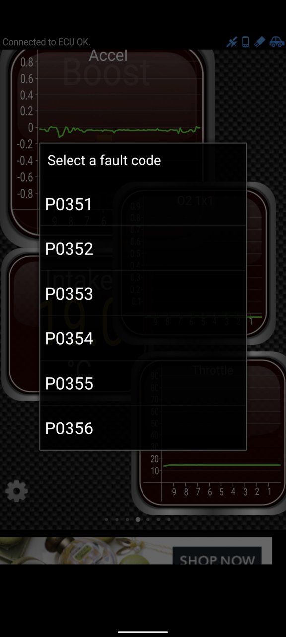

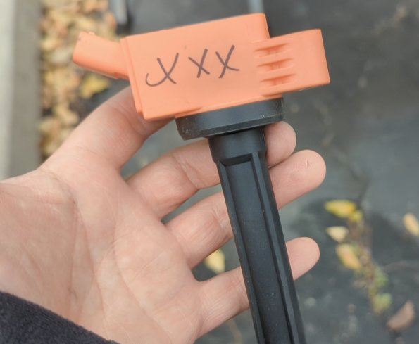

    By the way @rheath08 and everyone else. It ended up being bank 1 coil 2 passenger side. I swapped one coil at a time back into place and set off on codes when this particular coil was in place. Generic code for one single plug. Can't do anything right. No obvious signs of damage but stalled out with the same DTC.

    I believe you would test resistance of the coil pack. Some correct me here. I'll probably watch YT vid or two tonight.
    Mine were. Purchased in Aug '20. In the car, running by Dec '20
    Don't worry Jesse. You'll know what codes to look out for. P0351-6 Lol. Don't be that concerned. I'll send my bad coil pack to Ripp after. Keep positive thoughts

    Sounds like a short on the secondary coil. The supply for all 6 come from from the same pin on the ecu.

    It would set off codes P0351-6 all six coil packs malfunctioning , such that Toyota codes usually make you guess some. So I was lucky it was bank 1 and easier to move coils around. The stalling stopped as soon as I swapped to the Denso on bank 1. It's a concern but could be a one off issue. There doesn't seem to be any mfg issue on the exterior or signs of failure. So we'll have to wait until I see if I can measure any numbers off the bad coil and what Ripp will have as a conclusion. There are many others running these without issue so I must have won the lotto.
