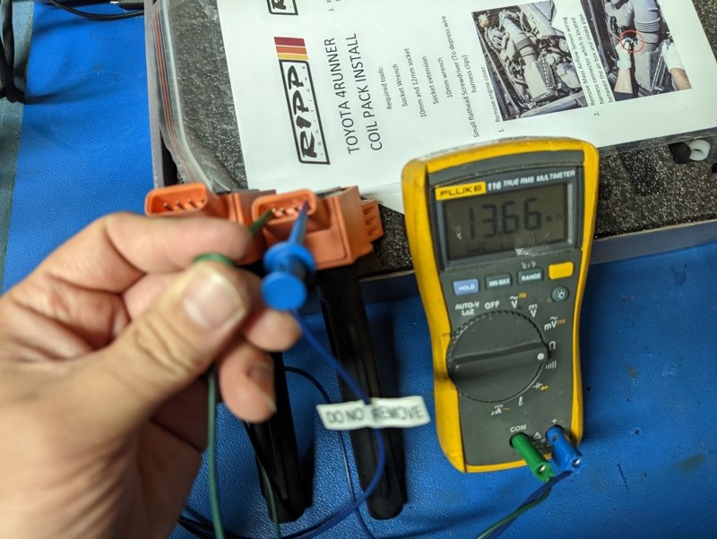

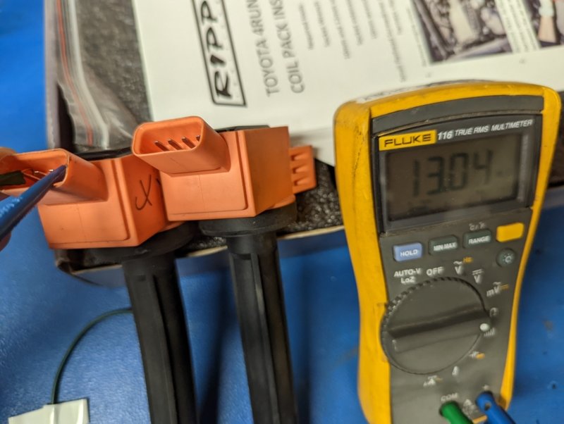

    Tested resistance on my bad and good coil. Not seeing any difference. I think once there's current applied, the issue becomes apparent. Will need to research some more

    So you think the coils are ok?
