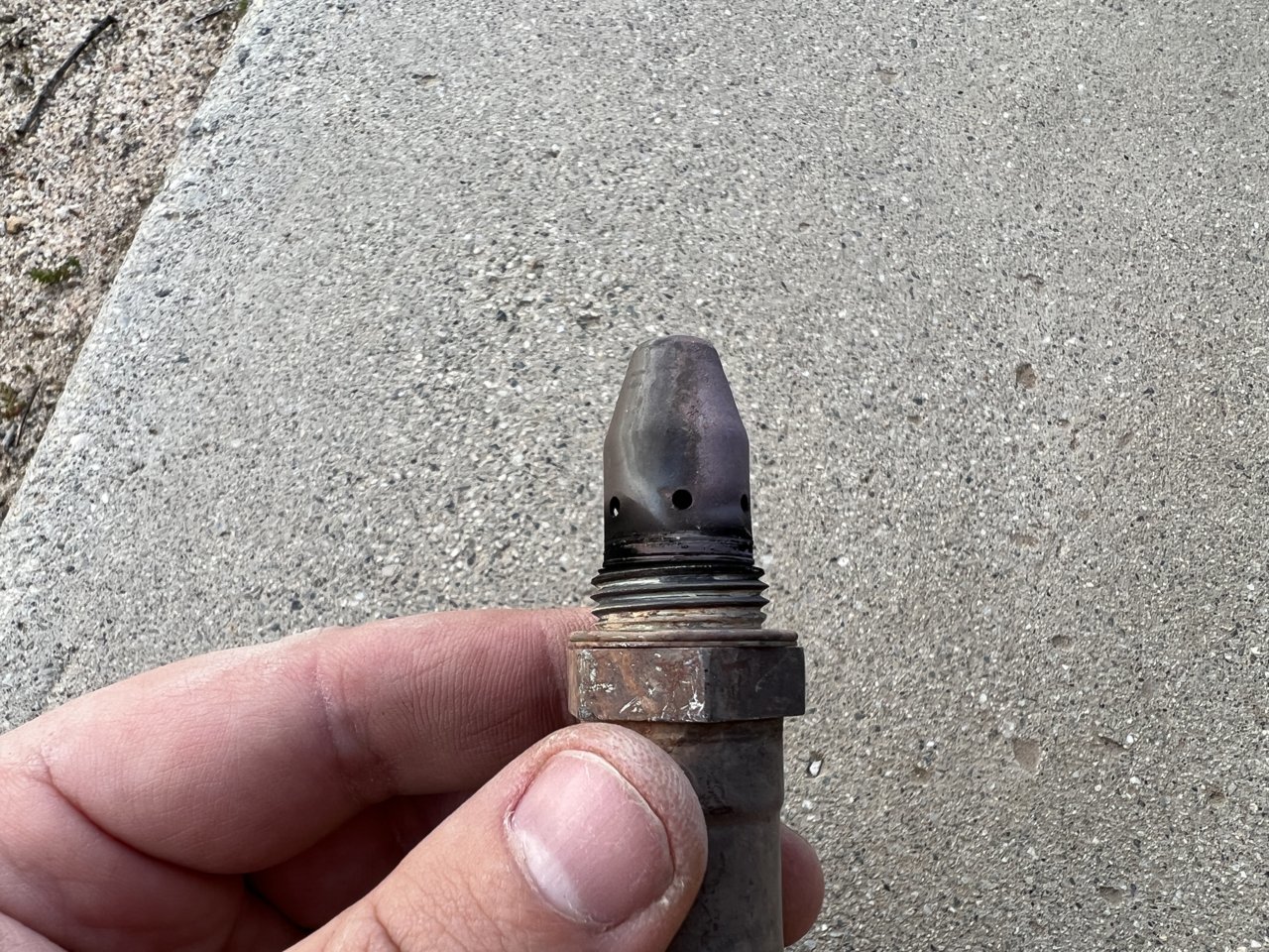

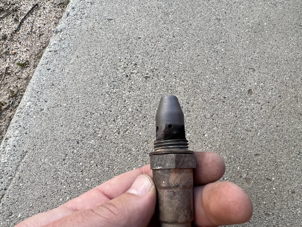

    Switching gears, I finally am replacing my bad upstream o2 sensors, which has been annoying but I already got the driverside done.
    Does anyone have any insight on what may have caused this pink discoloration of my sensor? I haven’t confirmed if the passenger side is the same yet but I will once I get it out.
    B11ACBCF-0989-4C4E-B813-507578CDAD2C.jpg 465186E8-E905-480E-80AD-13C1EF817B4D.jpg
    Also I want to thank Toyota/Denso for pre applying anti-seize and making sure it doesn’t get anywhere it shouldn’t be..

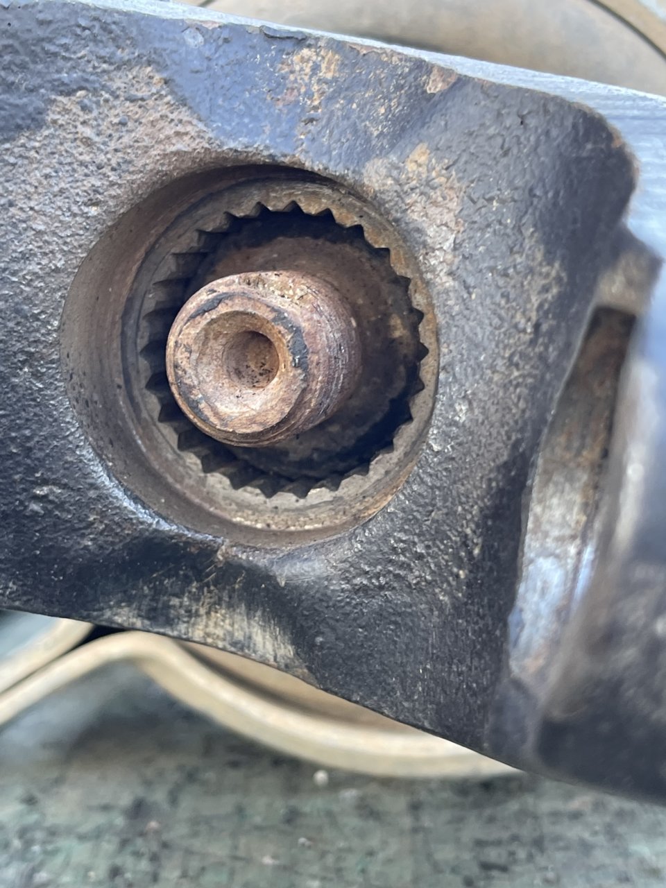

    Not S/C related but curious if anyone that has serviced u joints and carrier bearing ever seen the intermediate installed without the security nut and washer? I’m confident it was never serviced I bought the truck new but pulled apart today and bam not but or washer.
    going to order but curl is if this was normal for some years randomly. I’m thinking big miss from factory

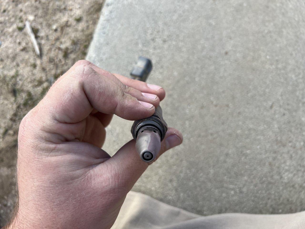

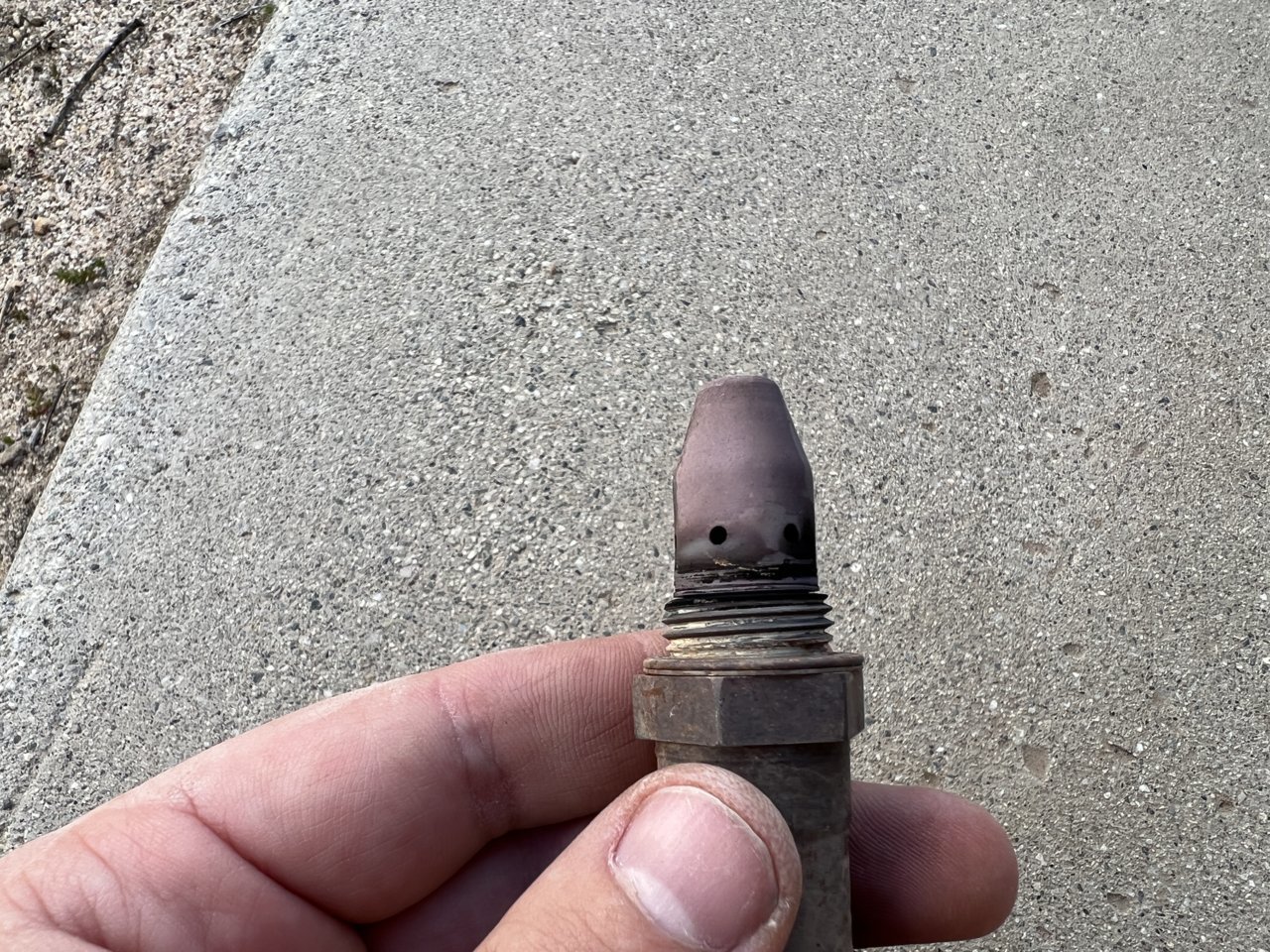

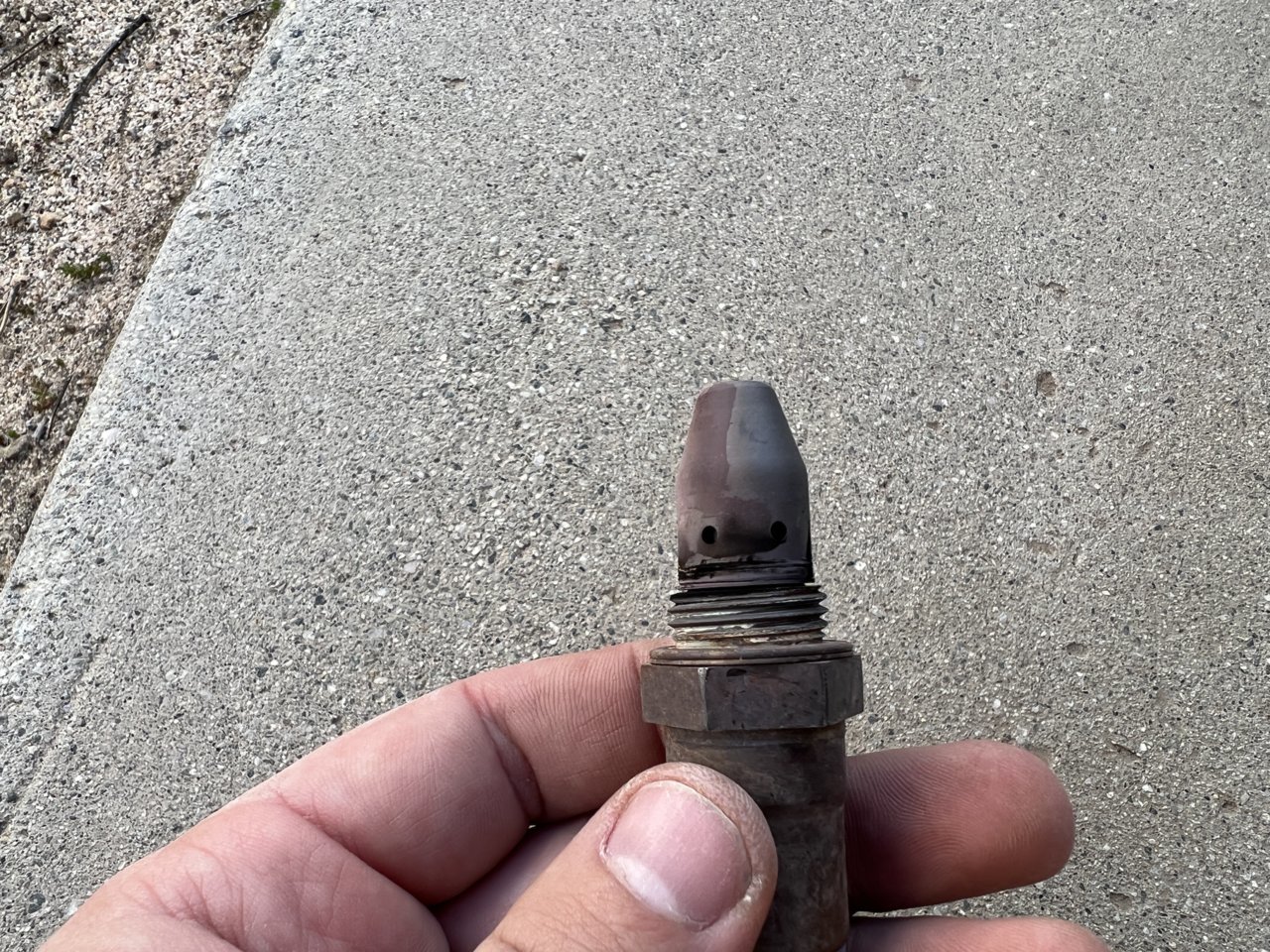

    Has anyone seen this pink discoloration on o2 sensors before? Or does anyone know what it means? :confused: Hard to say if that is normal or if it’s indicating a problem, I have tried searching around bug haven’t found anything useful yet..

    Well our coolant is pink. Only thing I can think is something is leaking coolant and it’s burning it

    From what I have read coolant usually makes it look more patchy, and I ended up having to use google instead of my normal search engine to find that the pink on o2 sensors is… *drumroll* additives in the fuel, so nothing to worry about. I was kind of hoping that the pink stuff meant something was wrong and that’s why my sensor was going bad, but I guess I just got unlucky this time around as I’ve never had to change an o2 sensor in any other Toyota before.
