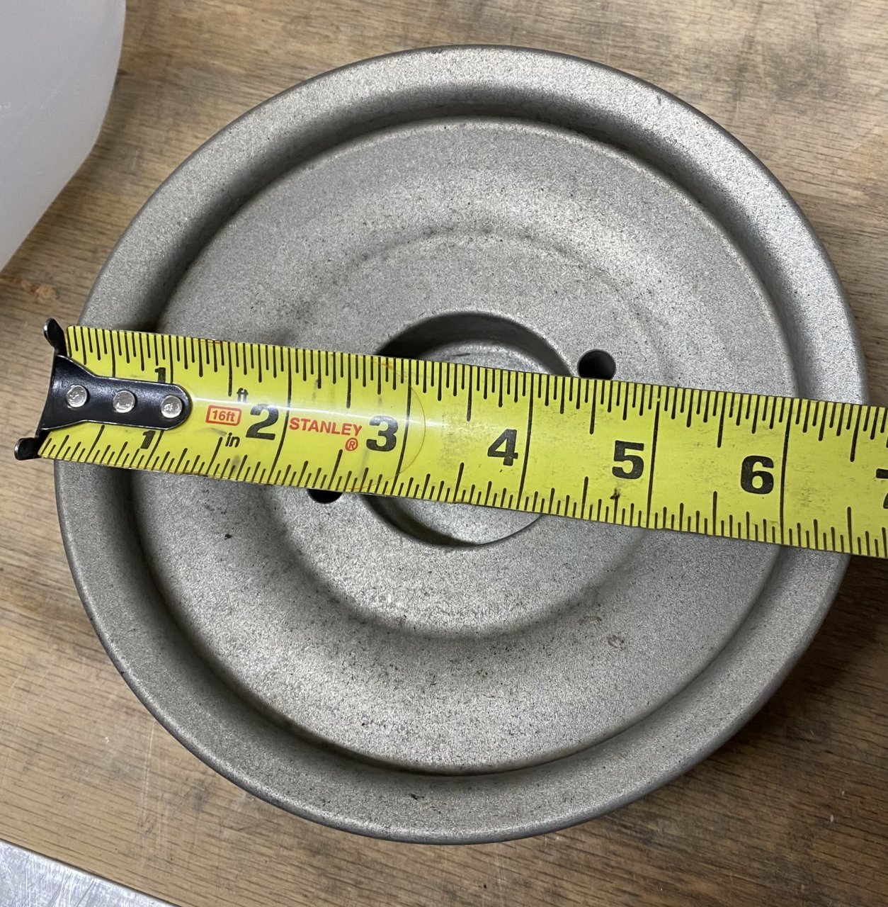

    I'm thinking I'm going to switch back to stock. Now the weak point will be the tensioner with that no slack RPM belt. Lol.
    The Roush will be a spare on the side.
    I got 13,479 RPM. That is going to be the RPM that larger idler is going to be seeing yeah?

    The stock super charger pulley was 6.89 based on your thread for crank pulleys. And that’s probably right for the larger one. Now look at the rpm on the tensioner pulley

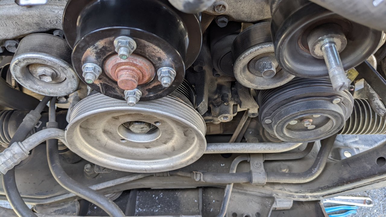

    I just want to clarify here.. are you saying that you have not replaced yours in over ten years? Or am I misinterpreting that?
    The current issue to overcome is the fact that the clearances are so miniscule that there almost isn't any space to fit the belt in between pulleys to get it on, let alone run anything larger.

    14,290 RPM on what would be a slightly smaller than the Magnuson version of the pulley, on a 6203 bearing at that, not a 6303 unless I can retrofit a 6303 in of course.

    And I can see the confusion. The recent group buy NST overdrive pulley is 6.5 inches and it’s identical to the stock TRD overdrive pulley diameter. While the obsolete larger Overdrive NST “KIT” that came with a smaller idler and tensioner pulley to compensate is actually 6.89

    In that case that brings my RPM back down to 13,481.479

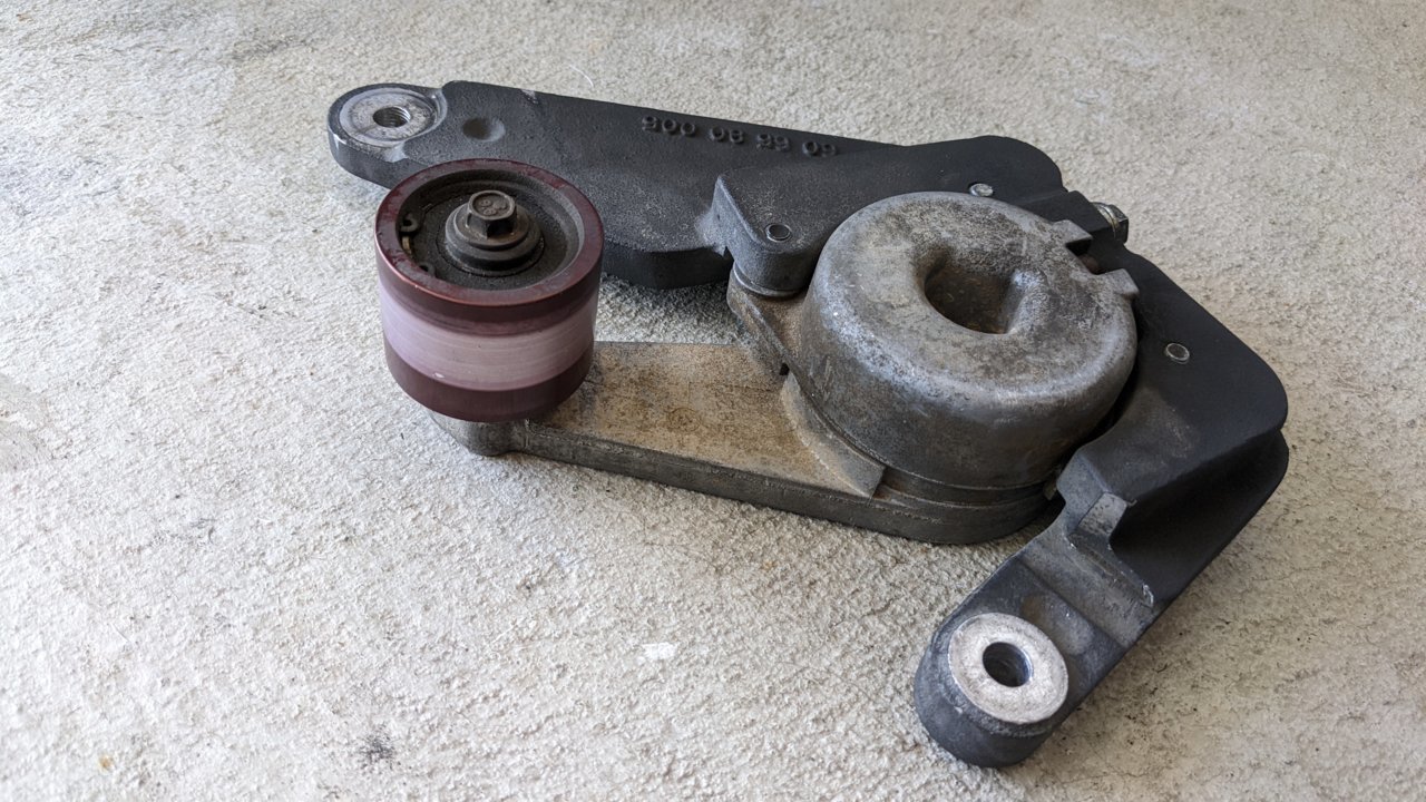

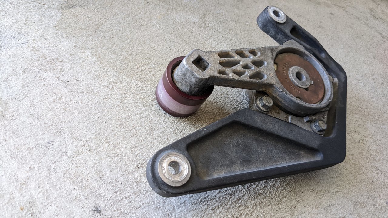

    Well, some of the carnage has been dealt with.
    It pays to keep some of the vital OE parts, especially things like the rotating assembly items!
    I am also switching back to the OE tensioner. With that being said, I REFUSE to give up the double bearing roller and it fit without issue on the OE tensioner. :D
