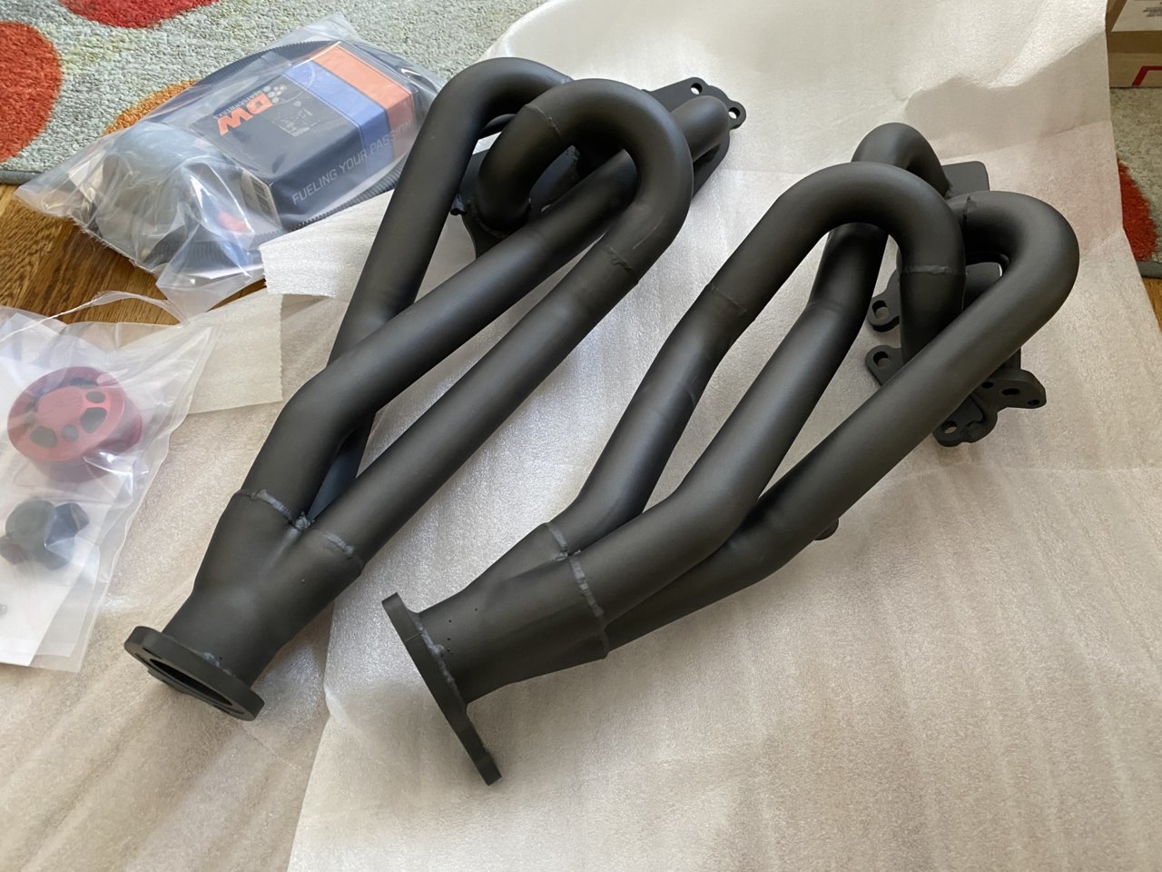

    What's he want for the Mk III?

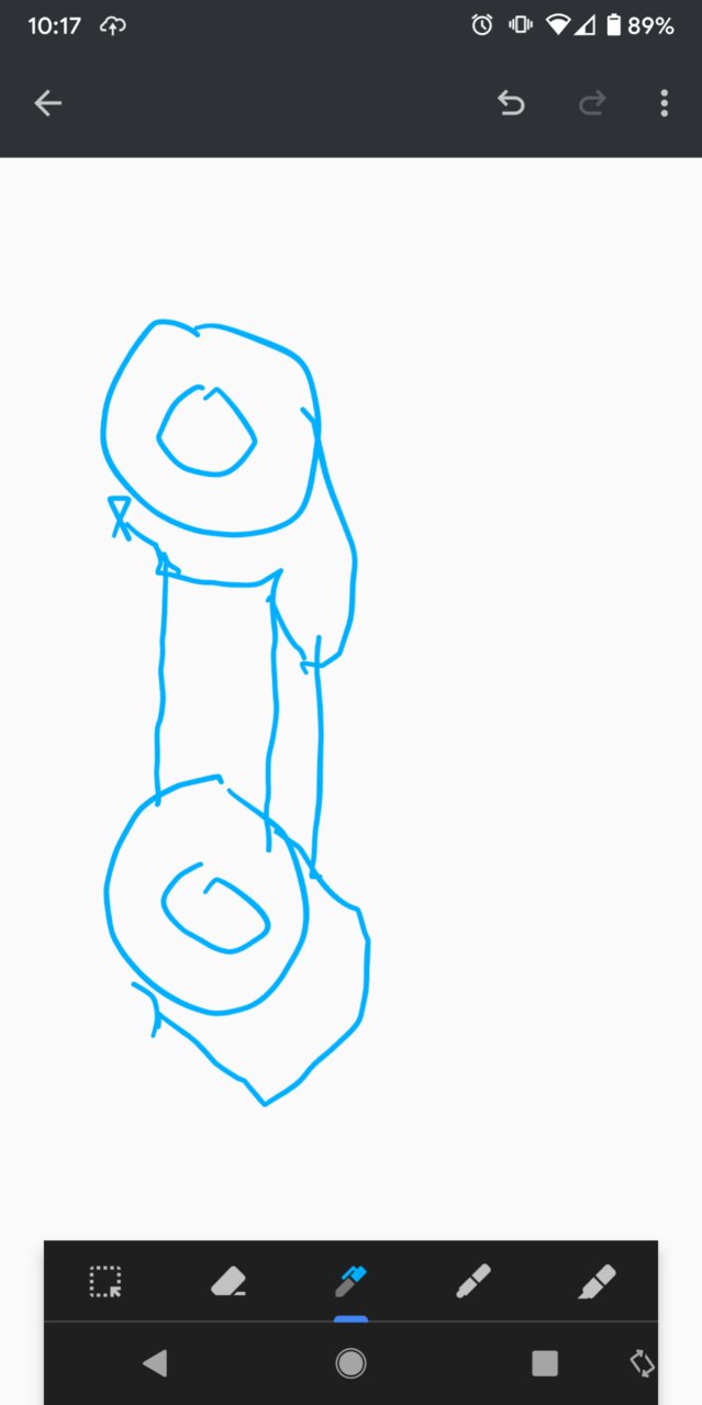

    I'm curious that since there's two spacers for each of the pulleys could a joined spacer that fits tightly on the studs lend strength to them? Keep them from flexing in the middle?
    Any engineers or machinist thoughts?
    @XPOTRPR
    @Athlaos I forget what type of engineer you are.

    URD Stainless 3" Mark3 Exhaust 2013 2015 Tacoma V6 $590.00 UCON-EMS Advanced Engine Management V-2, 2009-2015 Tacoma V6 $1,569.00 URD Spec-U LT Headers for 1GR-FE, Tacoma, 2012-2015 V6 Product Options ($75.00): Add Dual Rear O2 Simulator for 2012-2014 V6 $670 aFe Intake, Add on Scoop for Momentum GT Intake, 2005-2015 Tacoma V6 1 $123.49 aFe Intake, Momentum GT Intake, 2012-2015 Tacoma V6, Pro5R Filter 1 $411.34 URD Mark 2 Competition Y-Pipe 2005-2015 Tacoma V6 Product Options ($9.99): Include Gaskets $594.99 URD O2 Sensor Extension Harness $50.00
    I want the sims and contemplating buying the headers/sims then selling the headers. He won’t just sell me the sims. However, if someone needs them because they are buying the headers I get it.

    What type of idea are you proposing here? I know it's something regarding strength, but I can't picture what you are saying. Make a crude drawing so I can see and understand it better.

    I think what he is saying if we had spacers where inner hole is a tighter fit on the stud, vs how it is now which its pretty easy to slide the spacers on/off.

    If I got it right I'm actually understanding that he's saying to make a support for the middle of the two studs where the spacers between each of the two pulleys are.

    Ohh I think you are right. Hmm I am not sure if that would help strengthen them or make it more weight for them to hold. It would certainly distribute the forces on both studs I think but I am no engineer

    Instead of two spacers make more of a billet bar, possibly with round raised spots where the stud goes through if needed for clearance for the pulleys.Screenshot_20220302-101704.jpg
    Don't know if the bar could be attached to the block somehow but tieing the two studs togethet with a snug fit may keep some wiggle down.

    If you're going that far and replacing a bolt with a stud, why not build the spacer into the stud so that you put the inner pulley onto the stud and then install it, then you slide the next pulley onto the other side of the stud and then secure it with a nut or whatever.
    Best yet would be to support the end of the stud in a double-shear style.

    It would add weight yes, but if it's billet aluminum machining then it's sort of a moot issue.
    It would keep wiggle down indeed and would solidify the setup, from the beginning of the block/ timing cover, to the middle of it with the bar and finally to the outside where the tensioner sits.
    That would actually help relieve stress greatly from the entire thing because all of the action is happening in the middle, not the outside or the inside, so there is a greater chance of flex there.

    Nothing would be getting replaced though? The only replacements here would be the spacers that are already there with a unification bar.

    Hmmmm... I see what you're getting at. I think that would help for sure.. make them a little more rigid I suppose. My only concern would be do they need to flex individually by design for any reason? Otherwise.. I dont see why it would hurt anything.
