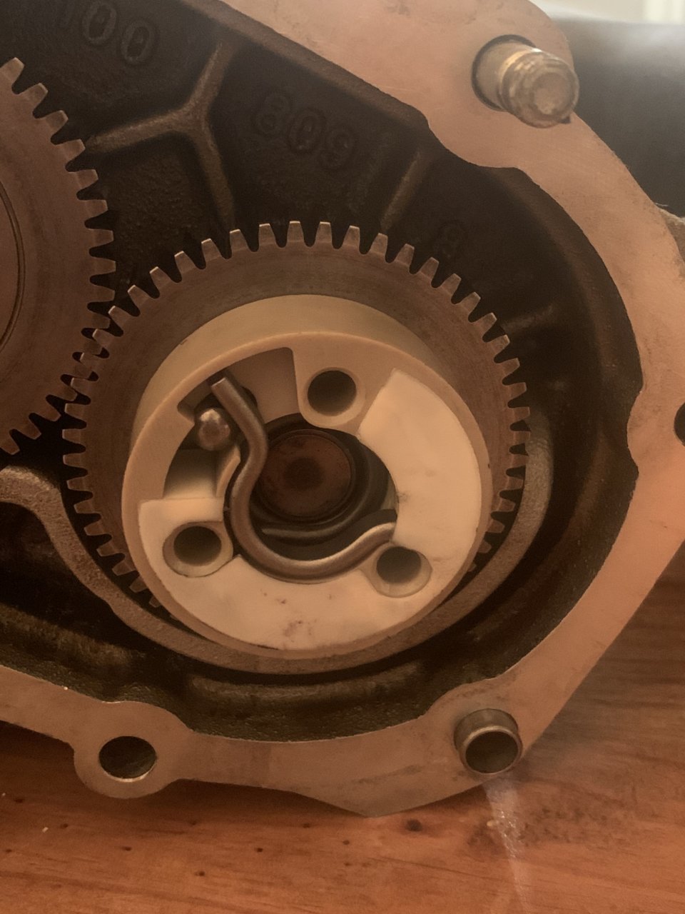

    Well, I rebuilt the supercharger. the old coupler was bad. when I separated it the snout the coupler stayed on that side. I wasn't sure with side of the spring the impeller prong was supposed to be.

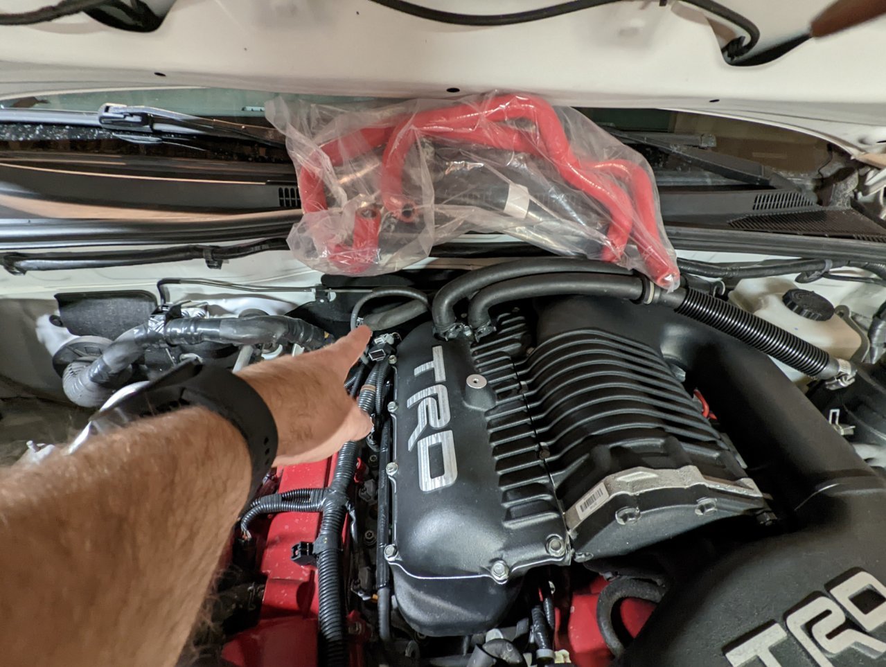

    Haven't seen them installed, but they go back here:

    Thanks man. That’s where I thought they went. You think it can be done with the blower there? Sweet valve covers by the way!

    Thanks! And I thought I could with effort, but I've been putting it off and may wait till I redo the s/c bearings cause...

    I do, but they are off the truck and so is the engine. Lol!
    I installed them with the super charger on. 1/4" ratchet and long extension with a swivel.

    I’m pretty sure the spring side faces back. Why not an upgraded solid coupler? Regardless Nice job. Did you replace the shaft bearings too?

    There is a picture on page one that shows the position of which way that coupler mounts. The way it's sitting in your photo is correct (of course consult with page one) it's my photo, but it's still good to reconfirm. I don't remember the intricate ins and outs of everything years after I did it.

    The video is helpful to an extent. But thats a stock 3.0 pulley situation. It gets way more tricky pressing out the modular hub and pressing in new bearings for us 2.3 pulleys cause the walls on the snout are super thin.

    that just seems like another annoying thing to install.... mine are also sitting on a shelf in the garage... maybe ill try when I get my Ripps coils with a pile of extensions and swivels.

    Yeah I was looking at how bad it will be for me to do the coils, specifically the drivers rear. Being a manual I think I have a couple more obstacles in the way but I think I can do it.
