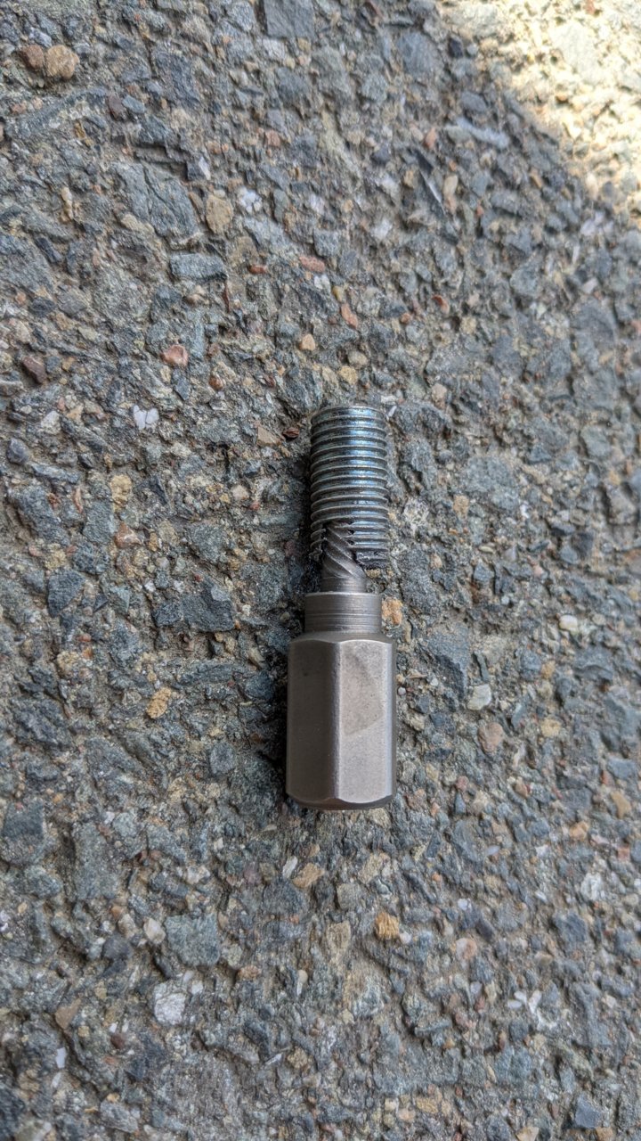

    Was kinda hoping you'd try the extractor. Next time smaller drill bit lol. Usually with the extractors, anywhere the teeth can bite into the drilled hole, will grab. Congrats Rob. Having done that timing chain jobber before, you saved a lot of time.

    My pops always used to say that the difference between a good and a great tech is their persistence. I hung onto those words especially during the extraction process because I refused to give up since everyone else was too scared to touch it and I think that's what helped me pull through. That, a diamond Dremel bit and a shiny new titanium drill bit set. ;)

    At least you didn't try to use Harbor freight easy outs. I learned my lesson breaking an HF extractor inside a broken exhaust stud on my Harley a week before a trip to the Dragon's Tail. Was forced to pull the head and use cobalt and titanium bits to drill around the hardened extractor then punch it out. Drilled out the rest of the bolt and tapped a new exhaust stud in the night before departing. 20210905_163623.jpg

    Harbor Freight tools are the devil.
    For anything hardened, I recommend using Dremel diamond bits or their Tungsten carbide bits. They work awesome even on the hardest of materials.

    Meh I’ve broken a few snap on easy outs when it shouldn’t have happened. And that was on first use of the tool

    Yuck. All in the metallurgy.
