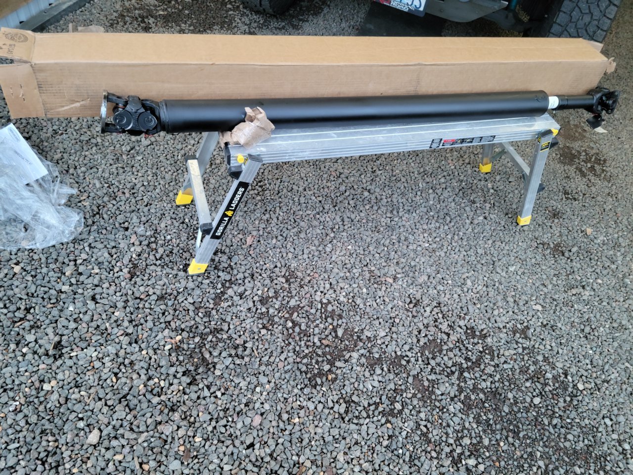

    going to bolt this on tmrw providing shims show up. looking forward to uninhibited heavy pedal soon.

  10. Mar 8, 2022 at 6:31 PM

    This picture reminds me I should regrease my fittings

    i like how they come with caramel.

    You have a might fine shaft there sir. :thumbsup:

    feedback- tom woods drivelines. on a 1-10 scale....10. customer service, knowledge, speed, etc. new hardware, full dubass proof instructions, warranty options. just impressive. without absolute correction of pinion angle the truck runs so much better. highly recommended if you have heavily modified short box trucks. very happy customer.
    im going to buy a front shaft as well.
