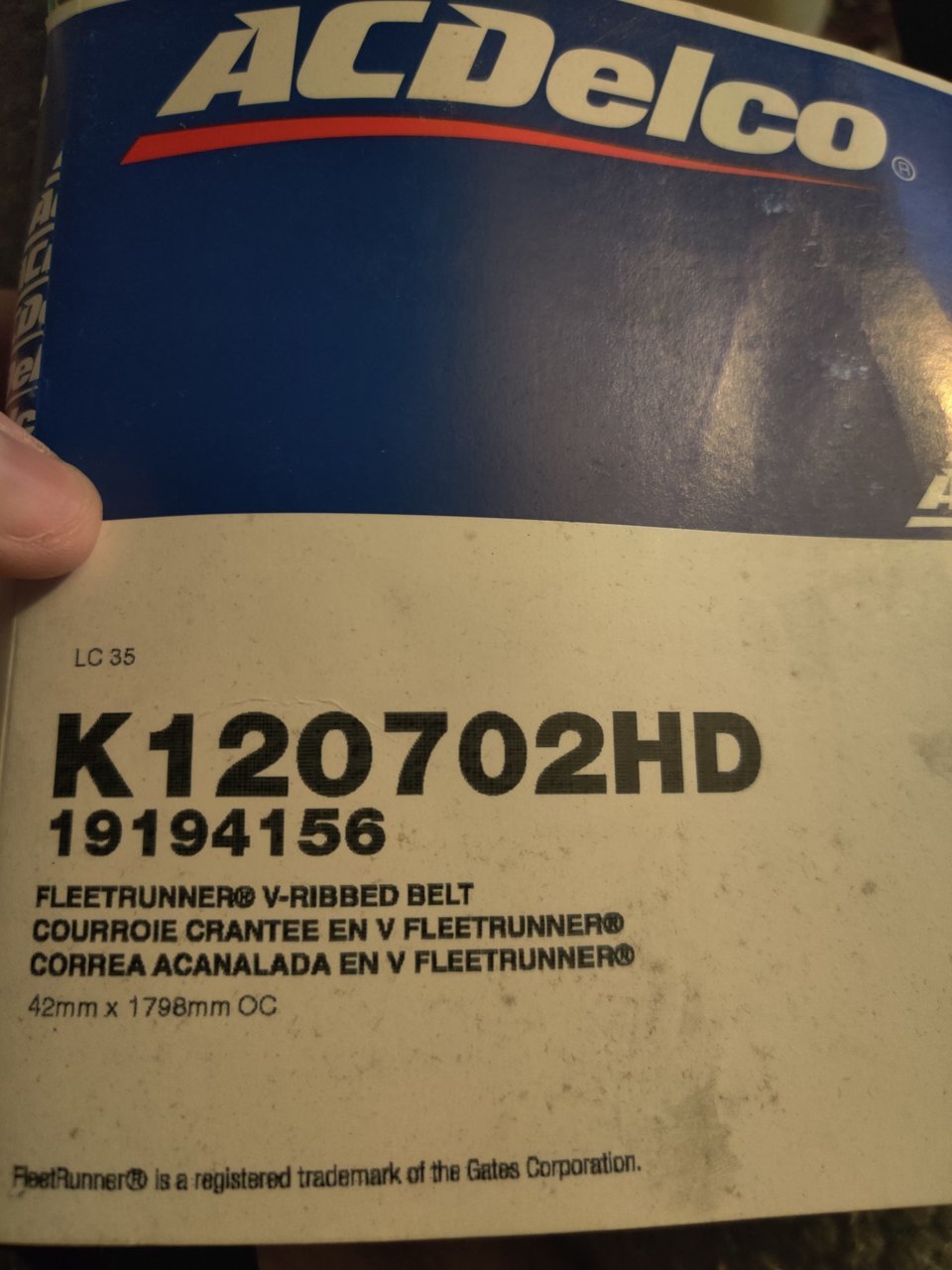

    Incase y'all need a 2.8 belt and are having problems finding a gates belt the AC Delco is the same.

    Well this is a hell of a find! A 5 rib Fleetrunner made for the smaller pulleys?

    No. This is the same 12 rib belt for the 2.8 but it's cheaper and seems more readily available. The number under the k120702hd is the AC Delco number. I've been looking for the gates belt for months and took a gamble on the AC Delco.

    So it needs to be cut?

    Yes

    I thought the 2.8 could be run with the regular belt from the install kit?

    Ah. Okay gotcha. I was looking at the part number and I was thinking to myself, there is absolutely no way this thing is a 5 rib, but let's see what Lucario has to say. Long story short, even I didn't consult with page 1 before opening my mouth regarding the subject matter. :rofl:

    It absolutely can

    Mines running the 8.25 just fine
