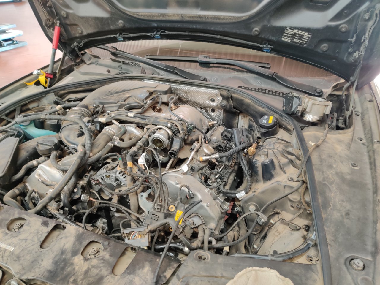

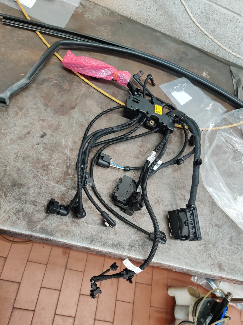

    Here is my contribution to the o2 sensor conversation. I have been waiting to start the job. Quoted at 22 hours.
    Open circuits in the harness for the o2 sensors on bank 2. New harness install.
    Starting to come out
