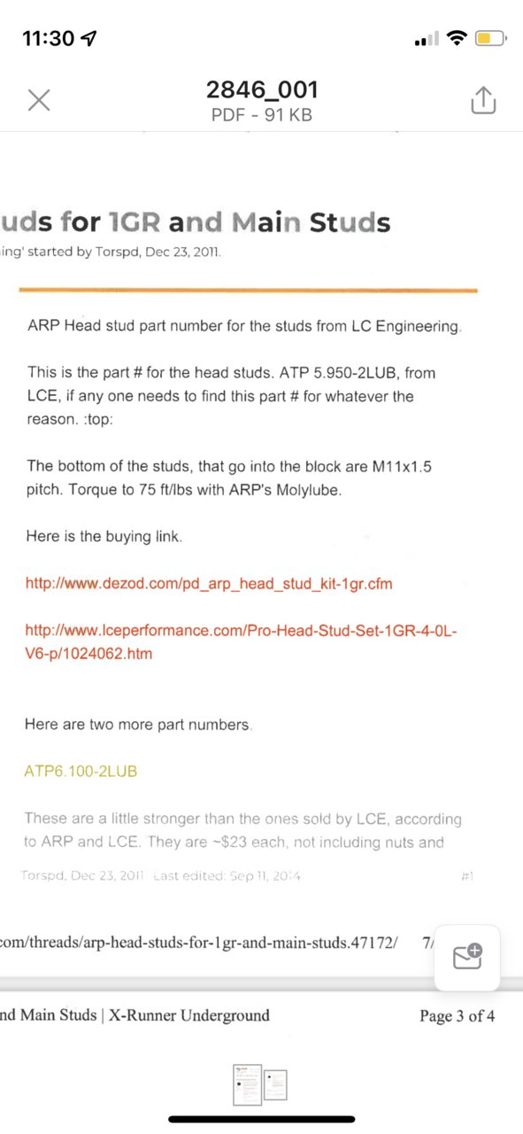

  5. Mar 18, 2022 at 11:19 AM
    racebug68
    racebug68 Well-Known Member
    Apr 8, 2013
    #101660
    1,234
    Travis
    Chandler, AZ
    05 DCLB 4x4 TRD SPORT SILVER
    I can't leave anything well enough alone
    LCE said they are out of the pro stud kits... and ARP did not give them any kind of ETA... so they have no clue if it is weeks or even months. Just straight up "we don't know".
    And on the Cometic gaskets, I called them and they said that the thinnest gasket they make, which is 0.027" thick, is the oem replacement one, Does that seem right to you all? 0.027" is about 0.686mm.. That just seems awfully thin, but maybe it is right. @rheath08 , do you have the factory gaskets that came off your rebuild, could you measure the compressed thickness of the used gasket? Or maybe anyone else that has ordered cometic could chime in on how they came to know what size to order.
    edit: I think I will go with factory gaskets. and new oem bolts. No sense in blowing budget for things that aren't going to help me.

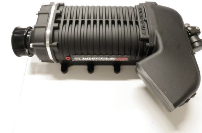

  14. Mar 18, 2022 at 9:29 PM
    12TRDTacoma
    12TRDTacoma [OP] Powered by Ford, GM, VW, and Mercedes
    Aug 20, 2012
    #85133
    16,670
    Rob
    Concordia
    12 TRD Sport DCLB 4x4 Supercharged
    Boosted
    This is what the old M112 blowers used to look like that Ford used on their Cobras and Lightning F150's. That would be the best way to do it for ours if someone was to make an adapter setup for it.
    Norton likes this.

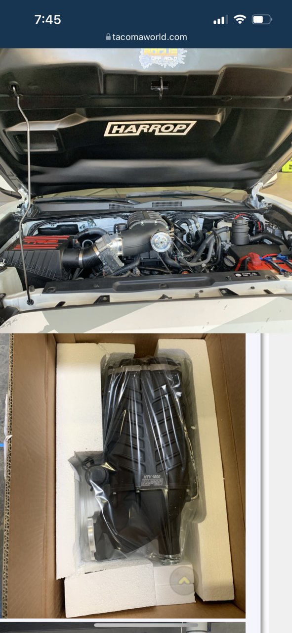

  15. Mar 19, 2022 at 4:42 AM
    o0opackersfano0o
    o0opackersfano0o Well-Known Member
    Oct 18, 2016
    #200102
    2,052
    Tony
    North Berwick, ME
    2005 xrunner swb
    Magnuson supercharger, 2.6 quick change pulley, 76mm throttle body, Doug thorley long tubes, urd y pipe, wot box with 2 step, 170 thermostat, airaid intake, urd short throw, djm 3/4
    No just got it out and into the garage. I’ll start driving it next month.
  16. Mar 19, 2022 at 4:46 AM
    o0opackersfano0o
    Oct 18, 2016
    #200102
    2,052
    Tony
    North Berwick, ME
    2005 xrunner swb
  17. Mar 19, 2022 at 5:54 AM
    findingthingsout
    findingthingsout Well-Known Member
    Dec 15, 2014
    #144330
    896
    midwest
    08 Tacoma TRD O/R A.C. MT
    Boost, armor, lights, big tires, no savings.
    That looks like a good option.
    Did the nameless one ever get that twin turbo set up straightened out?
    Last I had read was constant part modifications and sketchy fuel delivery.
