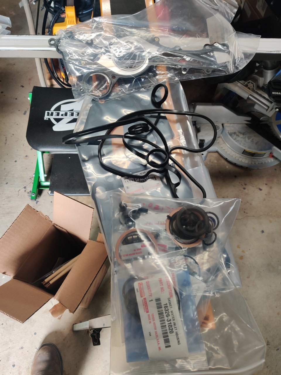

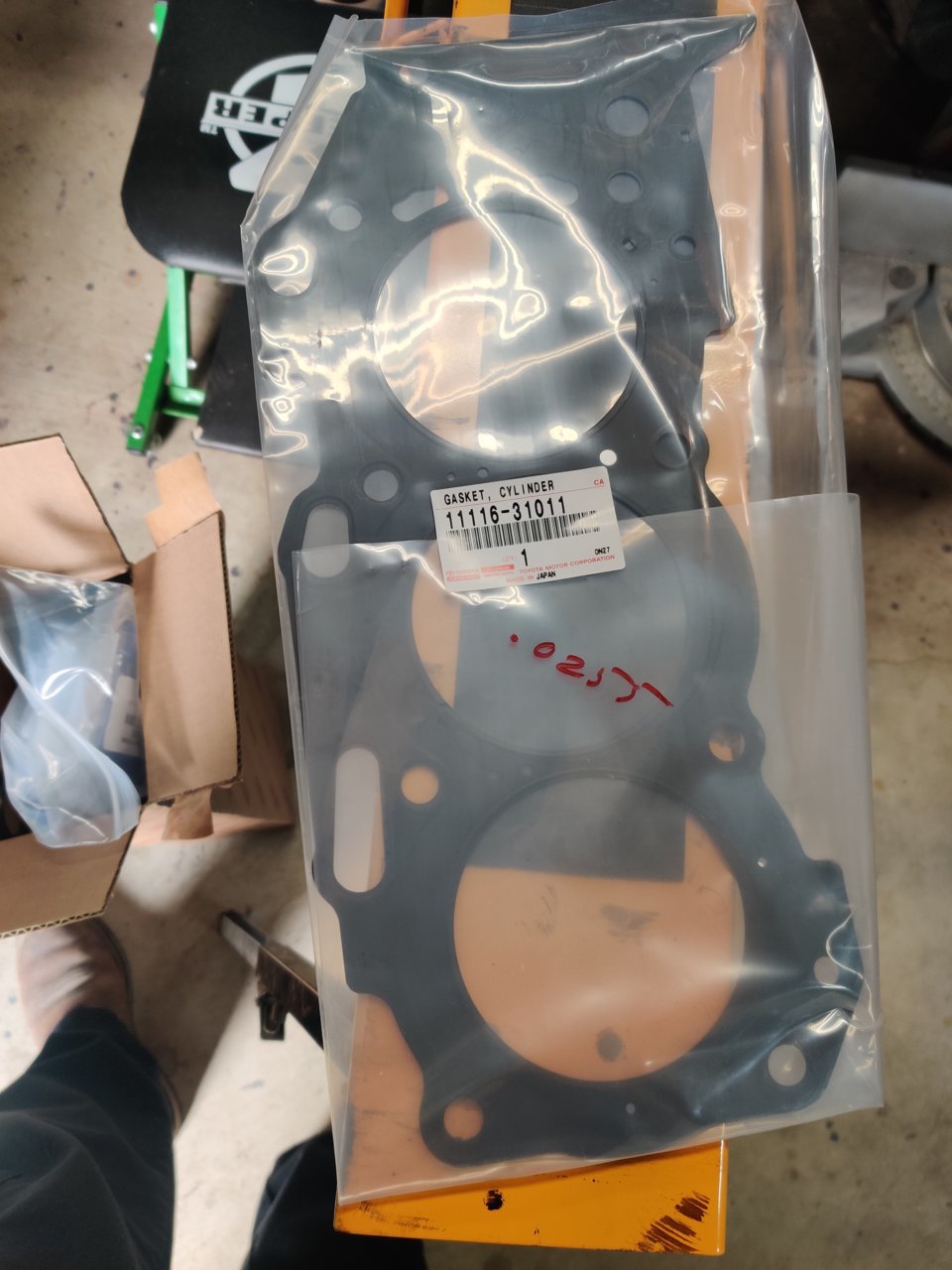

    I say get the engine rebuild kit, I did. Lol! But the kit has all. The new gasket is .0255
    As for the valve seals someone was asking about. Use vitron seals. I found them on rock Auto cheap.
    @MonkeyProof
    @racebug68
    Here are some of the others in the kit.
