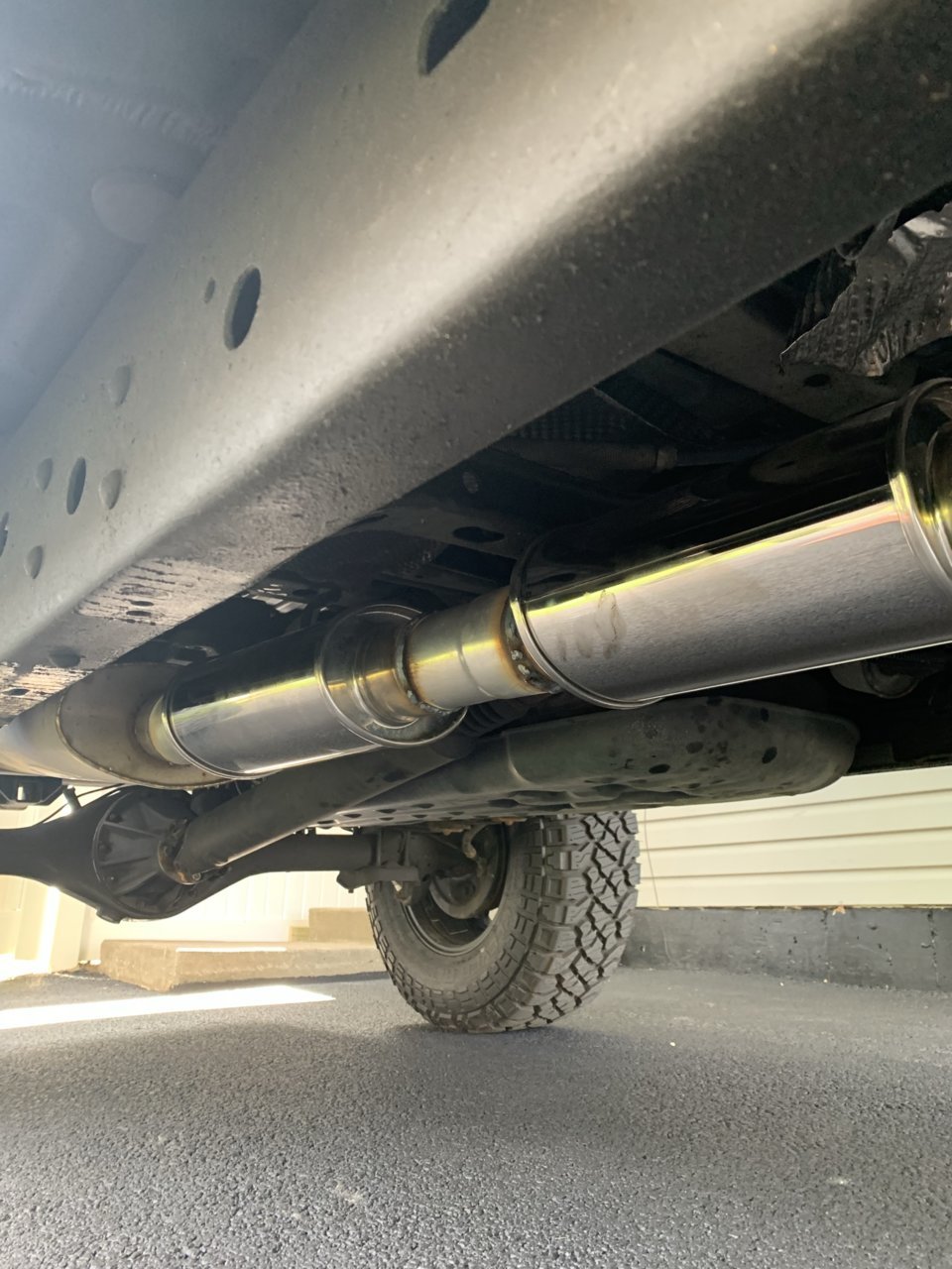

    Yes.
    You may not be happy with the sound, but I don't think I've ever seen a cleaner or shinier exhaust, especially on a truck. :bowdown:

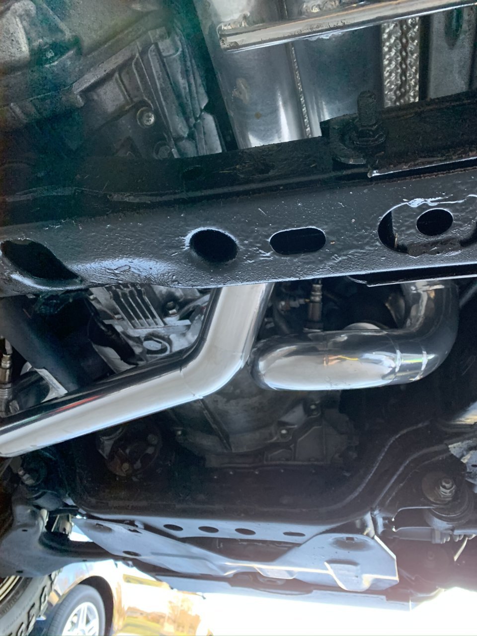

    9CF7E0F0-6818-4C51-BB39-DF45C020C892.jpg C9F42762-1A6D-4275-9687-9329A68AC90F.jpg
    Thank you sir. More for your viewing pleasure.

    Does it matter if the resonator is in front or behind the muffler? Just thinkin back to my WK HEMI with the gibson cat back and it had a resonator behind the muffler.

    Your under-carriage is cleaner than the exterior of many, including some I've seen at car shows! Well done, my friend! :cheers:

    It’s all about the fluid film for the winter. It keeps the salt from sticking and completely prevents corrosion. I just purchased a new power washer yesterday as well so now I’ll really be able to stay on top of it.

    The majority of setups I've seen in OE configurations put resonators before mufflers.

    My resonator is after the muffler. The resonator is just a small muffler, no magic there. I don’t think it matters which muffler goes first.

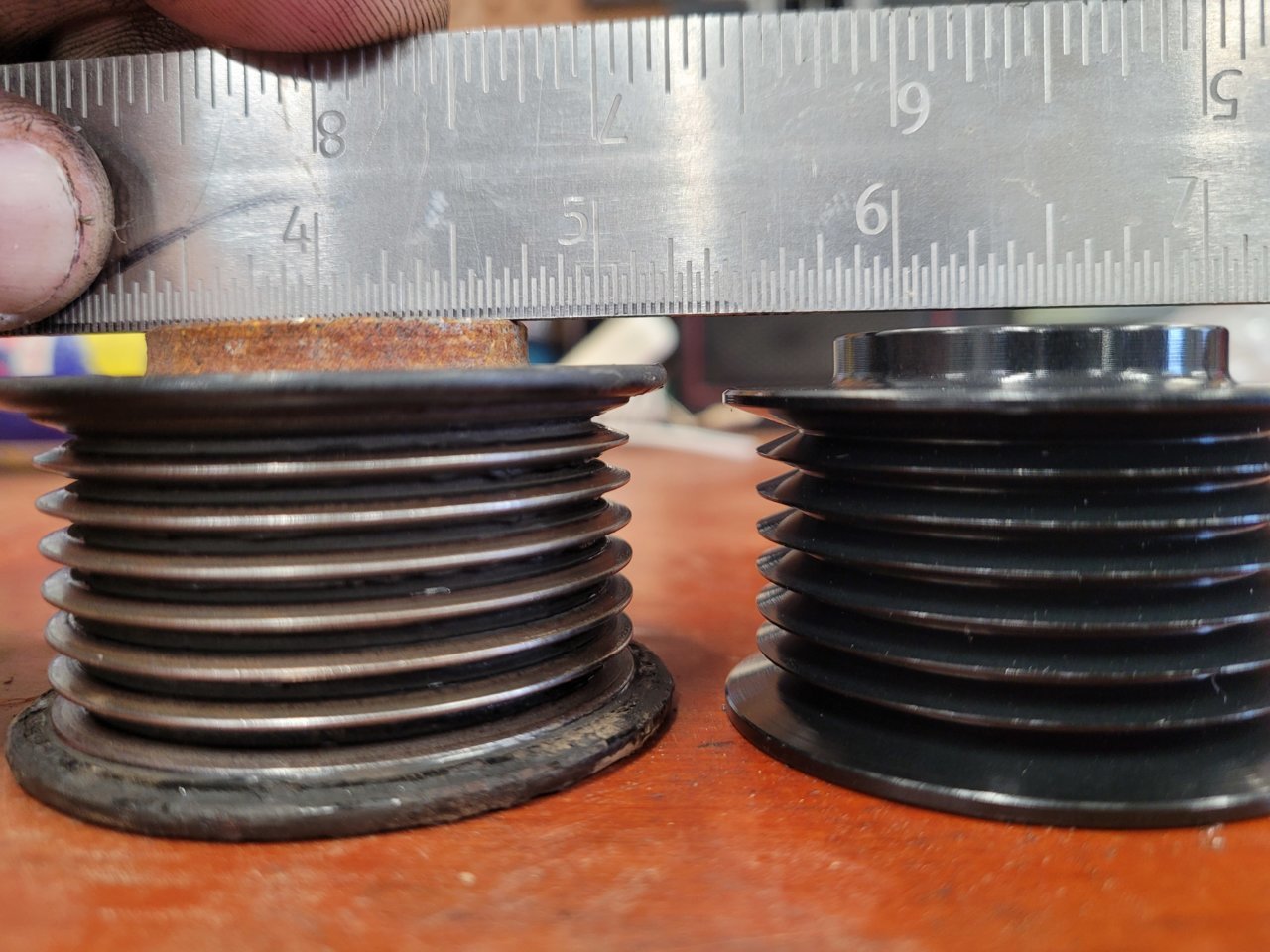

    Is everyones nst alt pulley shorter and smaller in diameter then the oem? Mine is shorter and about 4mm smaller diameter where the belt rides.

    It’s probably more important to measure the offset from the back side to ensure they ride in the same position.
    Unless that is the back side?

    Yes that is the side that goes in against the alt.

    it looks like all will line up once the base of the new pulley is flush. I have been running mine with no issues for a while.

    I’m definitely looking into the maggy xmod performance muffler and keeping my current one and one resonator.

    Mine has a very small difference between the OE pulley as well. It hasn't been an issue or caused noises but it did sort of get me paranoid for a little bit until I got over it.
    You should be okay. Worst comes to worst keep your OE one and if you need to swap it back then at least you'll still have it and it's pretty easy and fast to do.
