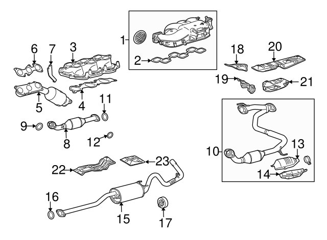

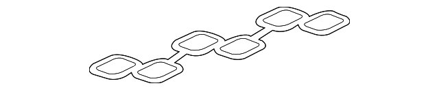

    It's a stock intake manifold gasket that in lays on the poopercharger. The one that is one gasket for all 6 ports ? https://www.sparksparts.com/oem-par...vbWEmeT0yMDE1JnQ9dHJkLXBybyZlPTQtMGwtdjYtZ2Fz

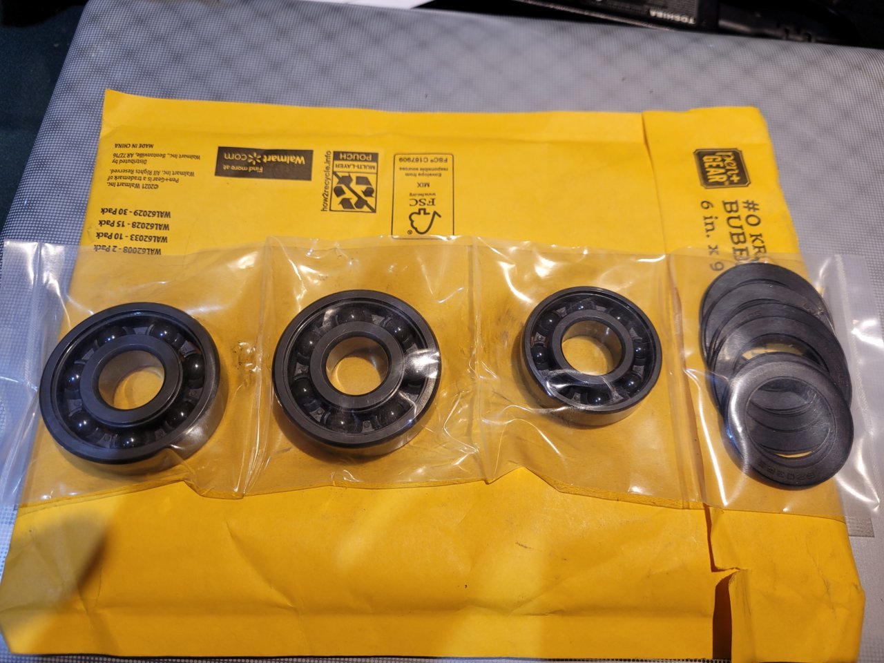

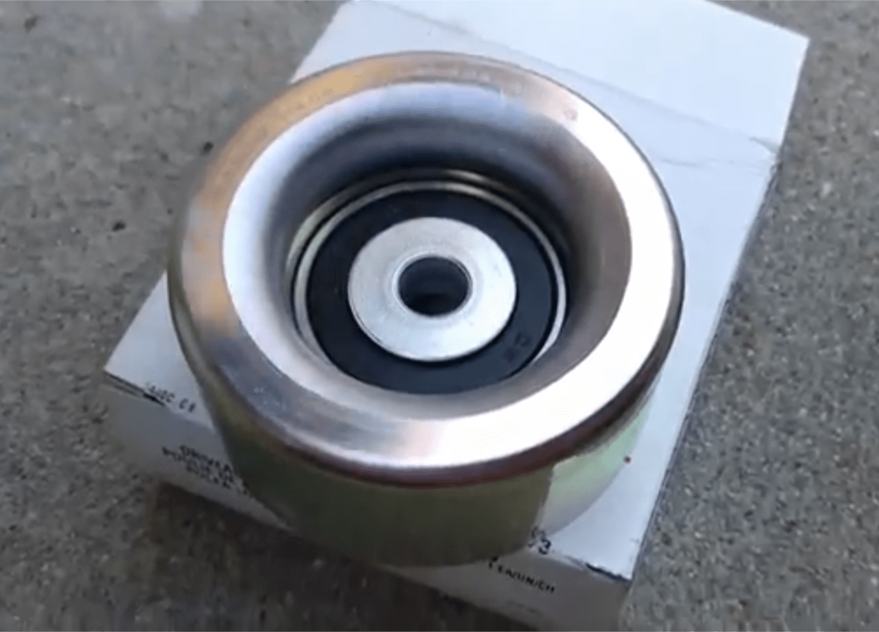

    Are the aftermarket pulleys you all are trying a double bearing pulley (it has 2 bearings pressed into it) the double bearings would give you the proper distance with the spacers.

    I'm gonna give them a try. These will be going in the tensioner, lower idler and mid idler for the S/C.

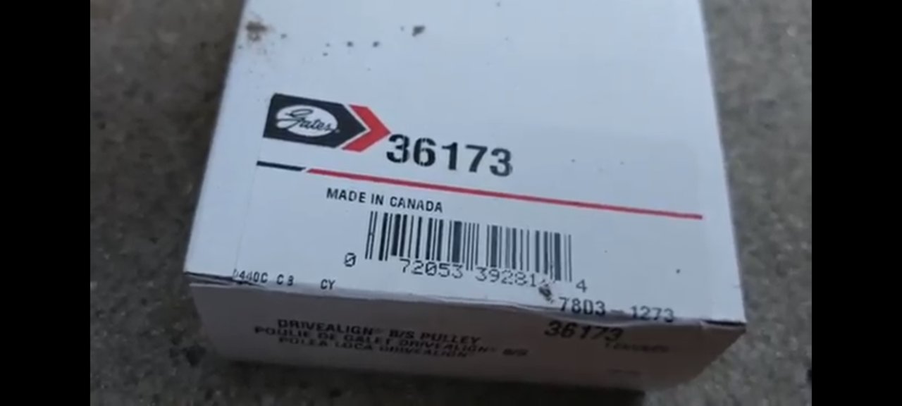

    Part #s?

    Can you post pics of how you press the bearings in/out ?

    Not cheap 260
    They have been added to page 1 with links.
    6303s are for tensioner and lower idler and 6203 is for mid idler.
    Are you referring to the side seals? I'm not sure I understand. If you mean the bearings I just used sockets and a bench vise.
