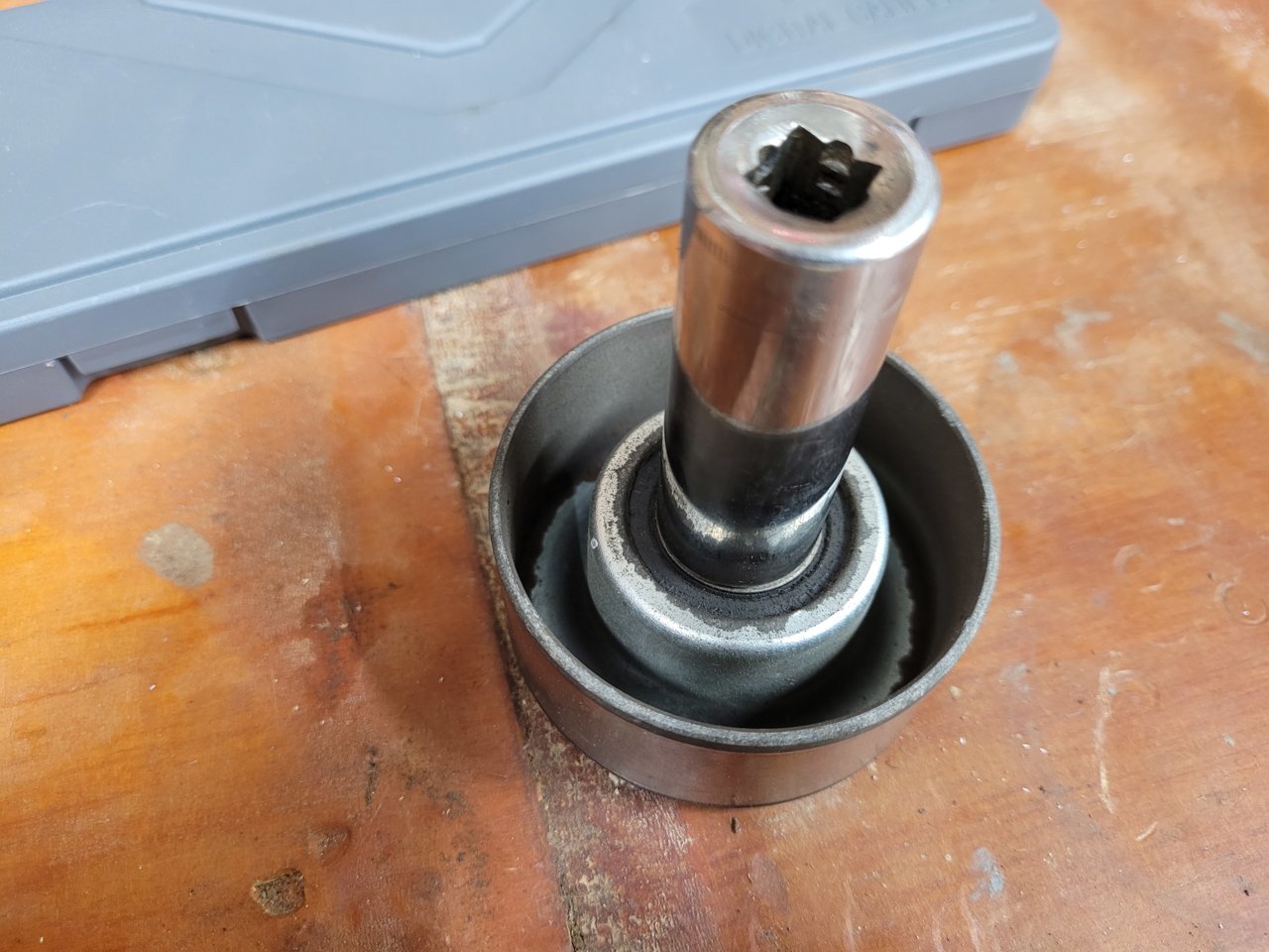

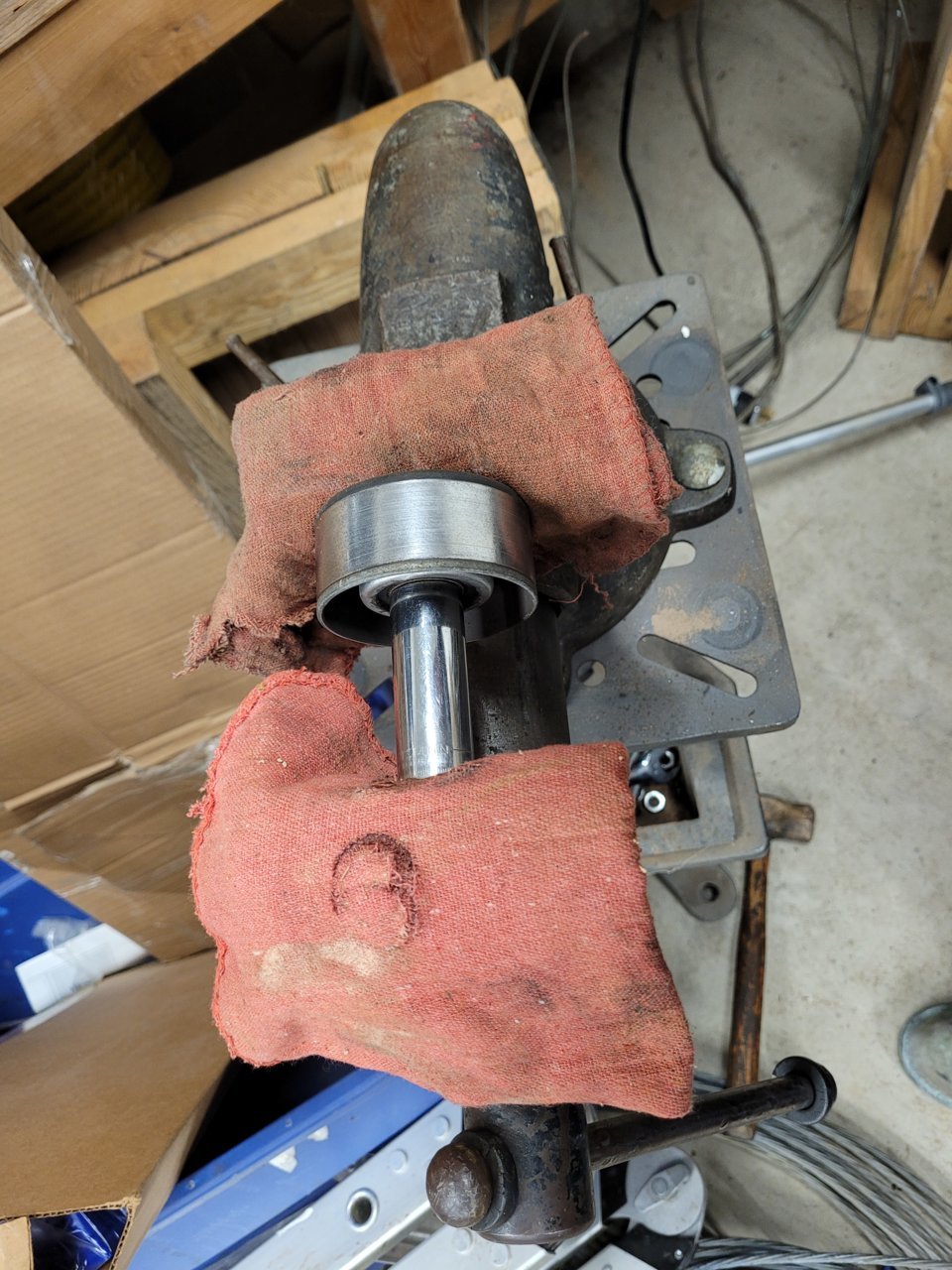

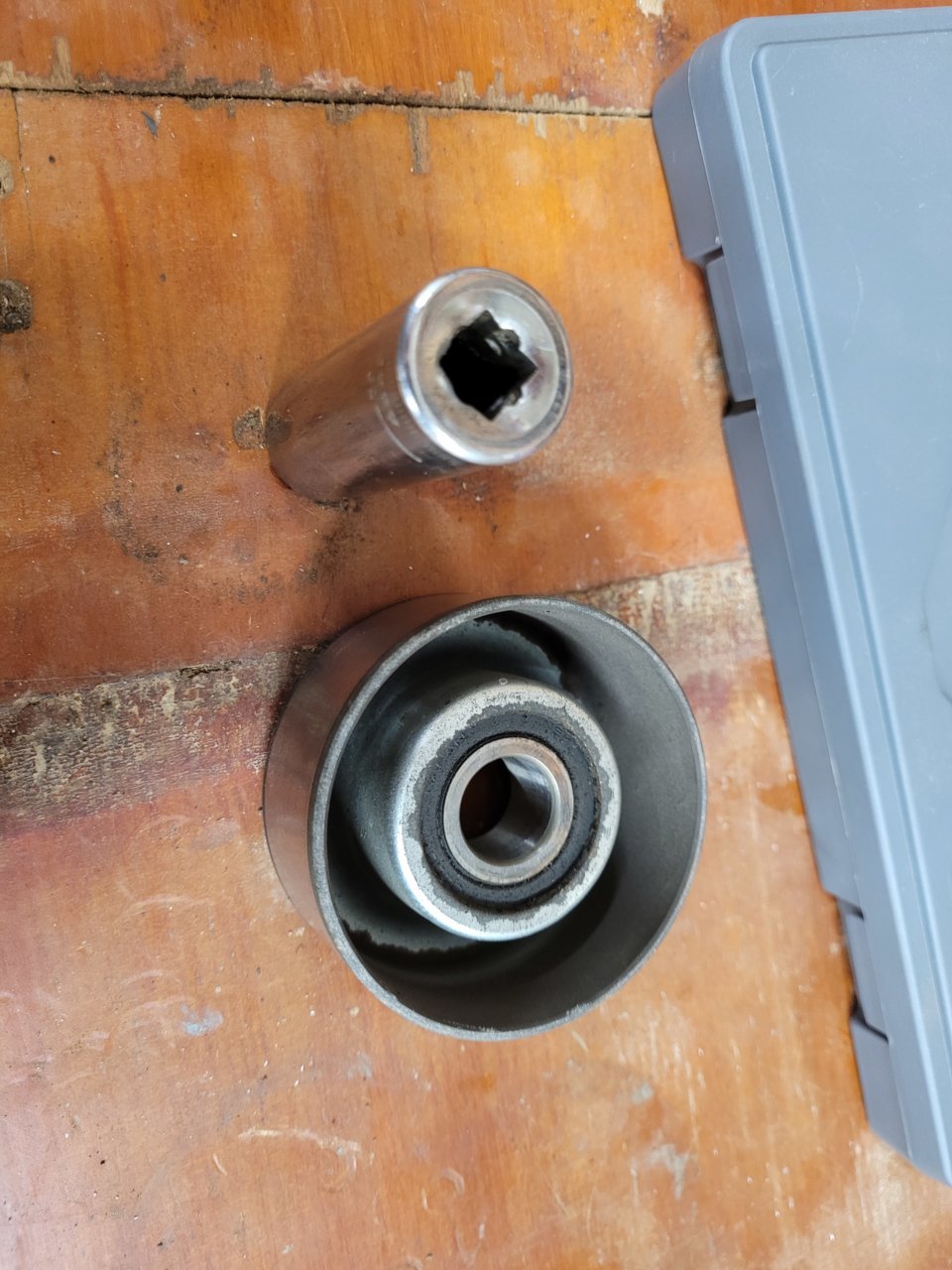

    This is pressing out the bearing. For install I'll use the old bearing and a socket that fits the outer edge of the bearing and press it in. Now I know the S/C pulleys are more flush on the ends I haven't gotten to those yet I'm replacing bearings on main belt idlers first.

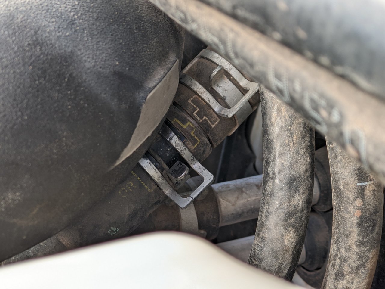

    Rotated the clamp that was causing the gouging so that the prong isn't eating the blower anymore. The clamp itself still makes contact, but at least there's no hard edge anymore. I'm going to wrap it in electrical tape to help soften it.

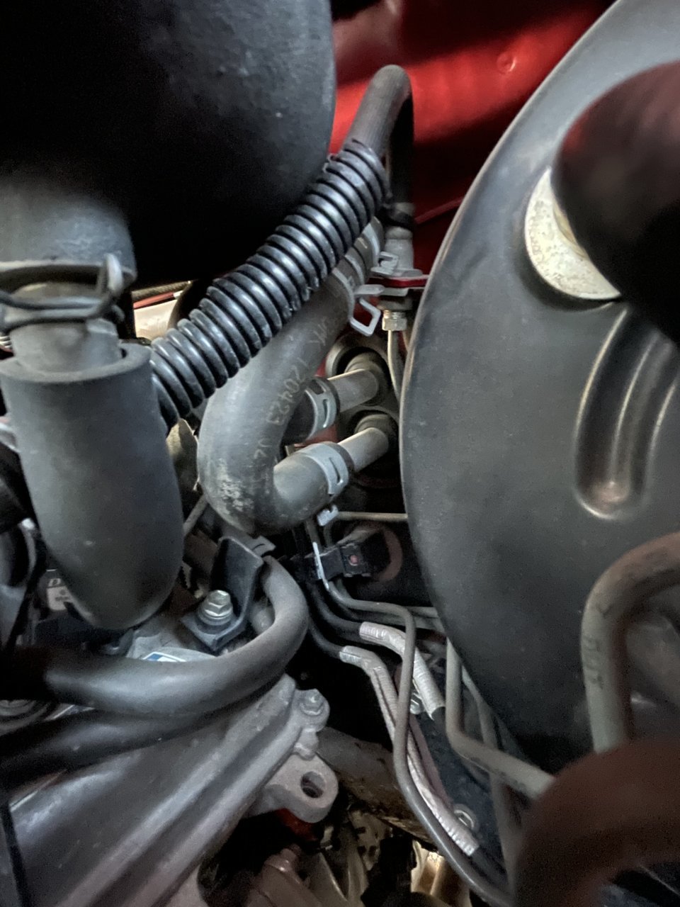

    For you manual guys out there, i rotated the constant tension clamp, and then zip tied around the heater core hose to the hard part of the line for the clutch to keep it from rubbing on the blower
    Norton and 12TRDTacoma[OP] like this.

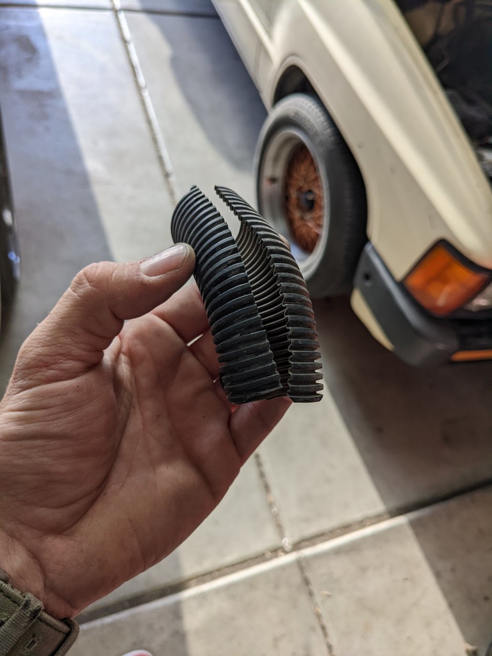

    Scratch the electrical tape... PITA to wrap it in there. Found this piece of random loom in the garage.. should work perfect. Couple zipties and done.
    Torspd, Norton, nudavinci64 and 3 others like this.

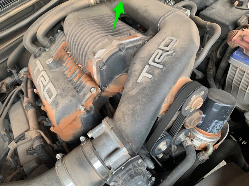

    Yup. Right on the back side of where I'm pointing:
