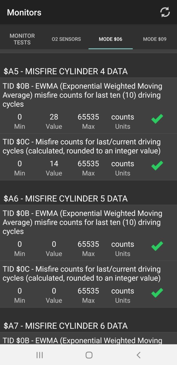

    It’s not every time, and sometimes the truck will be like half warmed up and I can just feel some sort of miss at idle. Its not harsh but sometimes when I’m out of the truck I can hear it doing it also. How does one go about collecting mode 6 misfire data? Is that something I can use the hptuner logger for or do I need a fancy scantool?

    I am not familiar with HPtuner.. but yes, a fancy scan tool would be necessary. The Fusion APP im using right now with a inexpensive Bluetooth adapter has the ability for Mode 6 Data.
    Mode 6 Data is really great to have for diagnosing potential drivability problems that does not have a MIL/DTC. For instance, my misfire at cold starts most of the time does not set a MIL/DTC, but I know its there. So going to Mode 6 I can see what cylinder(s) the misfire is happening at. In my case, #4
    Here's a screen shot of my current Mode 6 data showing #4

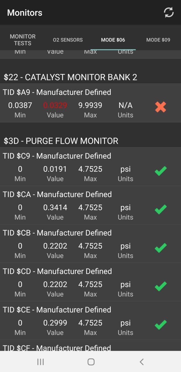

    And also im getting an occasional P0430 Pending code, which means has not set a MIL/DTC yet. Viewing Mode 6 can give me a sense if its the Cat Conv. or a 02 sensor(s) not reading correctly.. P0430 is a Cat Conv. Efficiency below threshold..
