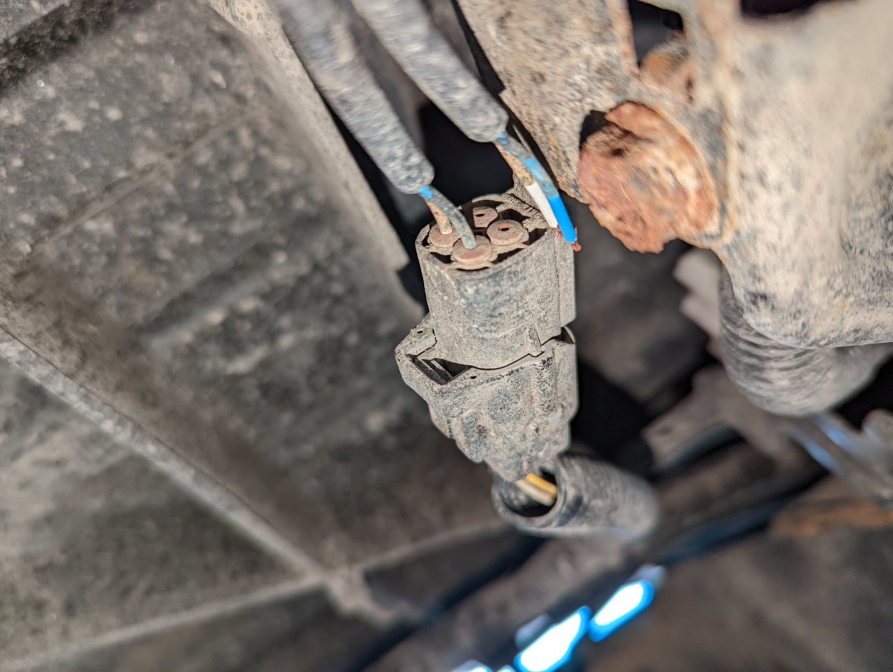

    Asked this in a wiring thread as well but random question but does anyone know if a plug like this can be repinned or reconnected? Passenger side rear abs wires pulled out of the plug and drivers side abs wires still connected. Trying to figure out how to proceed on this one.

    They can be repined. The hard part is finding the part numbers for the pins. You will have to go through the factory for them.

    You can easily disassemble/de-pin the connector , or you can order a pigtail repair connector from the dealership..
    It was easier for me to copy and paste this link rather than copying and pasting the photos.. but here's how I fixed my rear wheel sensor connector that had an intermittent fault by de-pinning and splicing in new wires..
    https://www.tacomaworld.com/threads...-bad-rear-wheel-bearing.561813/#post-18396971
