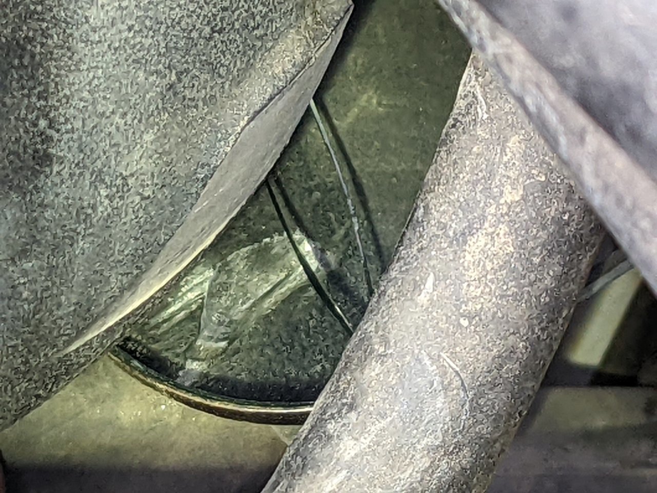

    THANKS to all of you for highlighting this issue! Mine is also affected though, thanks to the limited driving I've done in the COVID era, it looks like I caught it at a cosmetic (rather than structural) level of damage. For now, I rotated the offending clamp and zip-tied the line to keep it away from the S/C. Will probably look at something more permanent and pretty when I tackle other routine maintenance, like spark plugs and belts...

    I still got to add it to page 1.
    I can't edit page 1 on my phone for whatever reason. It could be that my phone's web browser (chrome) is glitching out because of all the media.
    Either way, this is on the pending list to be added.

    man all i wanted was to spare others the grief i have to rectify. im picky like you and i missed this!
