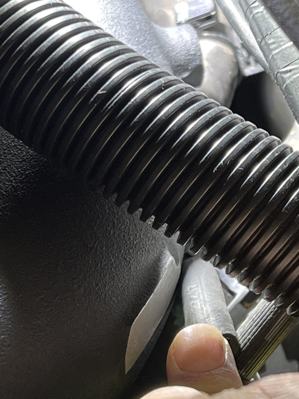

    @rheath08 @White lightning boosted did you guys find your vacuum leaks. Sounds like the exact same thing with me. I was in communication with Justin yesterday to get my truck retuned. I swapped out of my URD tcai and back into the Afe Pro Dry S setup. Upon doing my data log it was discovered my long term fuel trims are way off indicating a vacuum leak. I’m also reading lean in bank 1. Other the the FPR hose, where did you guys look to rectify this?

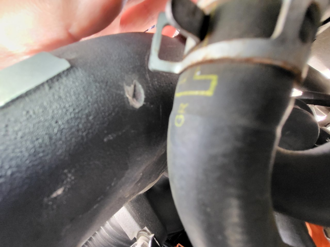

    Another update with me. So after finally looking on the back of the blower. I seem to have a very small piece scrape off from the clamp hitting that rear tube. Very minor. After having difficulty trying to move the clamp so the ear won’t hit anymore, I can up with this. Small piece of rubber hose. It fits snug on the clamp and it’s easy to checkimage.jpg

    Is there anyone that is not afflicted by the clamp rubbing on the blower?

    I'm not. The only thing it did to mine was very lightly cosmetically scratch the supercharger.

    I wasn't. checked mine but I have had the engine out a few times and the blower off a few times. I do have a mark on the back side that it might have had an issue from when I first installed the blower
