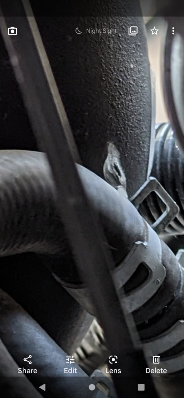

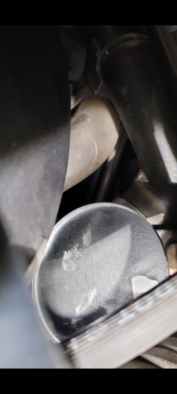

    Well that damn clamp got me twice, it was rubbing on the actual band of the clamp as well as the rounded ear of the squeeze tabs.

    Shit. I guess we all have that damn issue. Gonna be rebuilding this sooner than I thought. Was hard to get the camera in, but it feels significantly pitted

    So I have noticed with this talk about marring of the hose clamp. If you're running the HPS heater hoses, YOU DON'T HAVE THAT ISSUE! ;)

    Got mine waiting. Even more motivation to change it out now. I don't think mine came with any ring clamps but I'm gonna have to go back and check

    man i havent found a thing wrong. im baffled.

    yeah. i was in process of putting mine on when i found that problem.

    thanks for bringing it to everyone's attention!

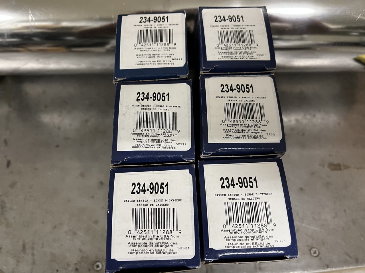

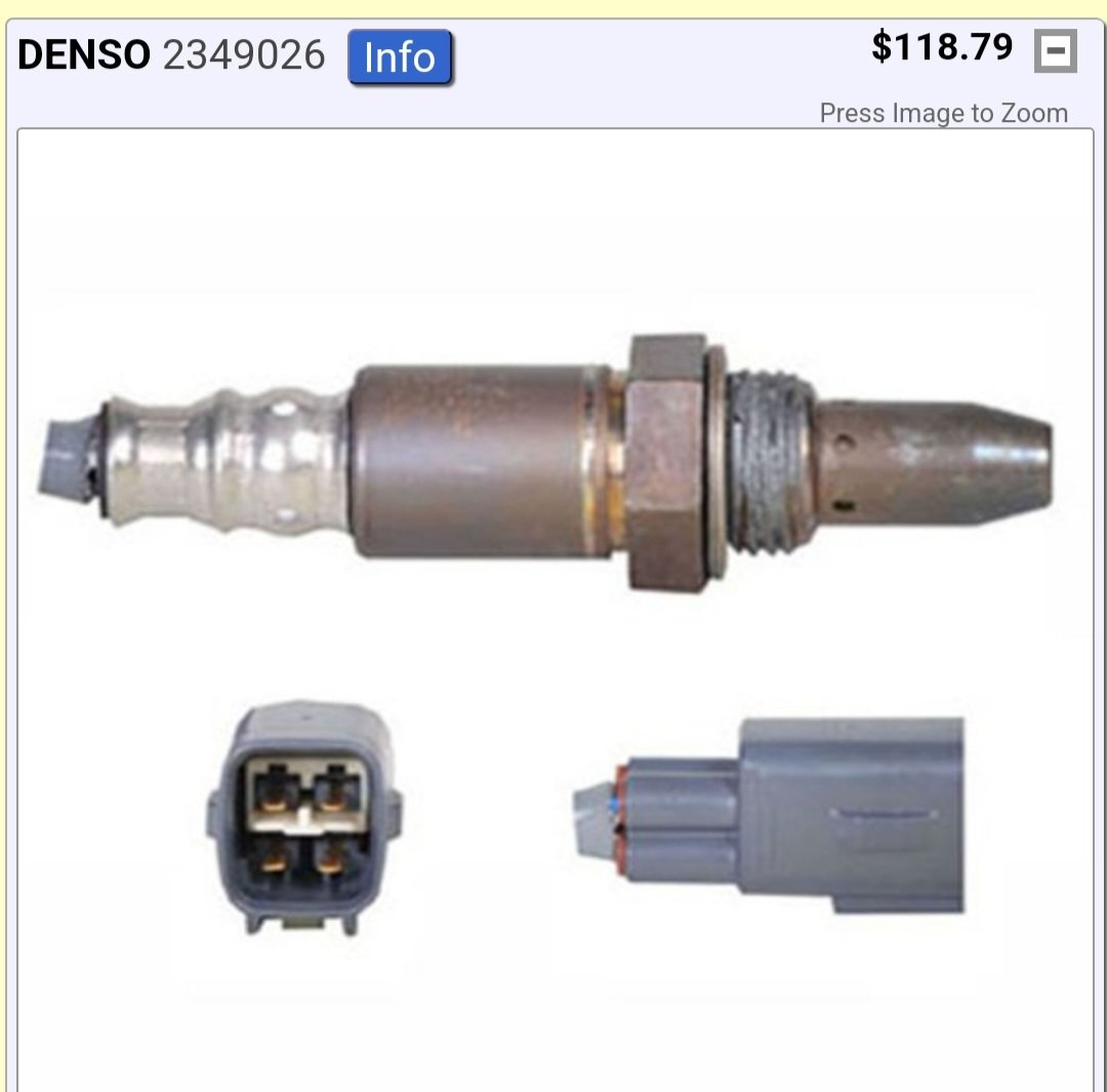

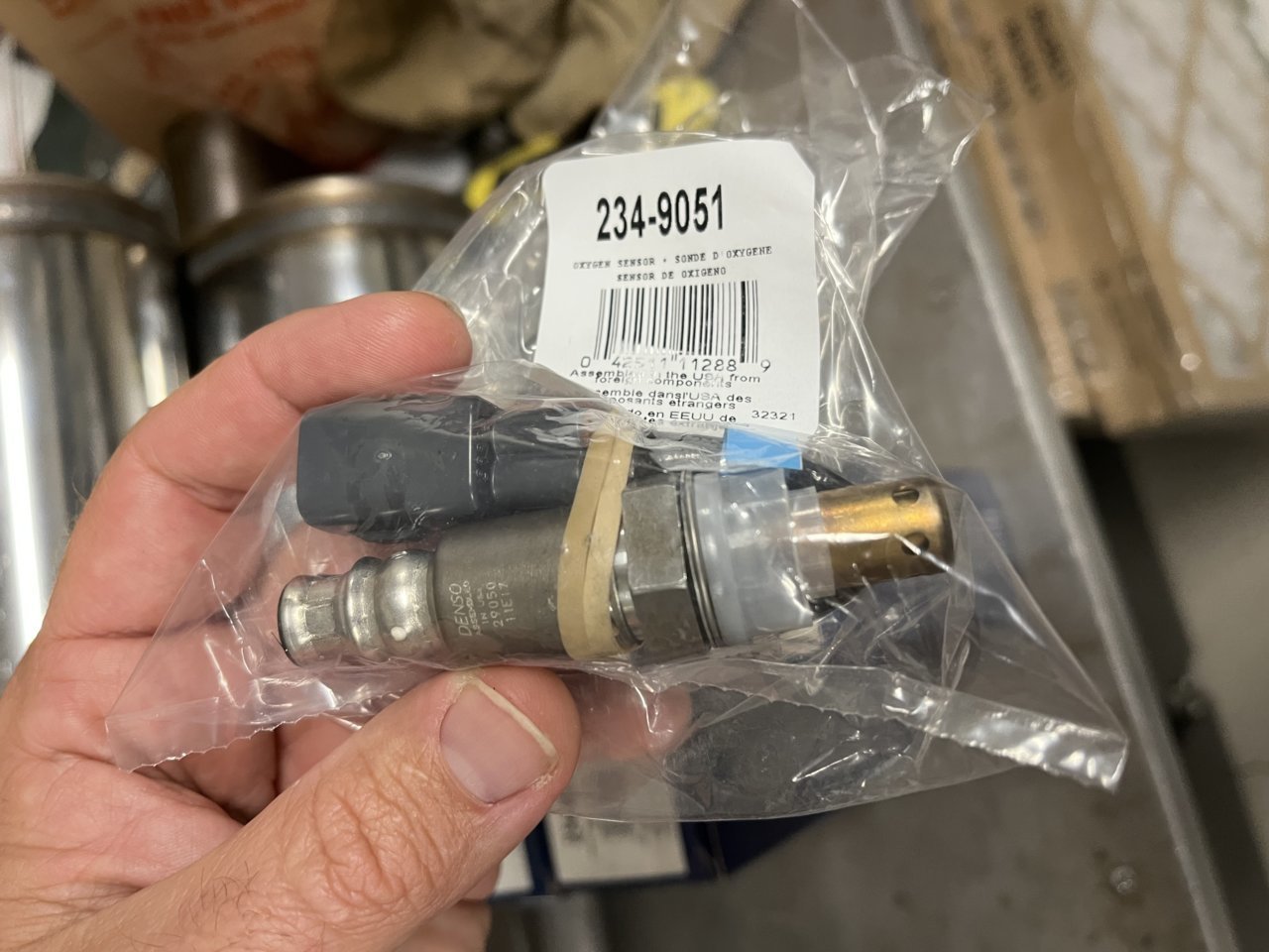

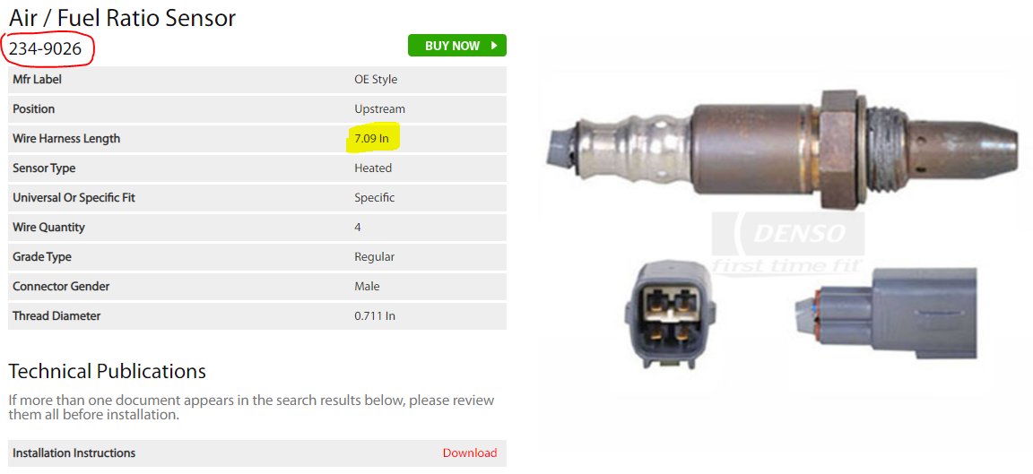

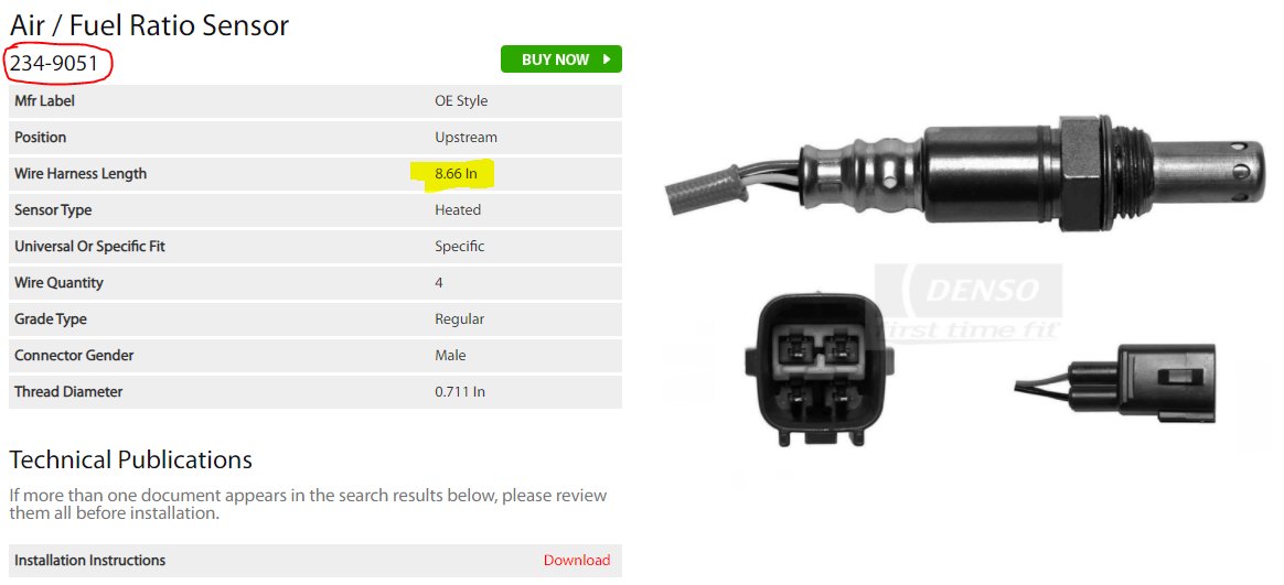

    To all of you guys with AFR sensor concerns - Here is the authority on which part number your truck should use, the Denso website. Plug in your truck info, click 'Air Fuel Ratio Sensor" and it will tell you the right AFR and O2 sensors for it.
    https://densoautoparts.com/find-my-part.aspx
    That being said, I ordered two 234-9051 AFR sensors from Amazon, they goofed up and sent me 8 in total. So I have 6 extras I'd like to sell if anyone is interested. They normally go for at least a hundred each. Let me know what you think is fair, I'm looking to recoup some money and pay it forward at the same time. Maybe $125/pair shipped? I think that is about 1/2 price when you figure in taxes and/or shipping.
    The ONLY difference that I can tell from some research on the different years and different part numbers that Denso has, is the length of the wire harness. The 234-9051 has a medium length connector compared to other years I looked at. I've seen between 6" and 12" wire harness lengths. So if you need an exact fit you might want to order the right part number. But if you have different exhaust headers, or sensor extensions for monitoring in the collector of your long tubes.. the harness length matters way less. Do your research, I'm no authority on AFR sensors by Denso... maybe someone can confirm. Let me know if you are interested in a brand new pair of 234-9051's.
    I copied some images from the Denso site below, the sensors I have are 8.66" harness, others are between 6 and 12 inches).
    These are genuine Denso, new in the sealed baggie, box, with anti seize applied, laser etched part numbers, etc.
