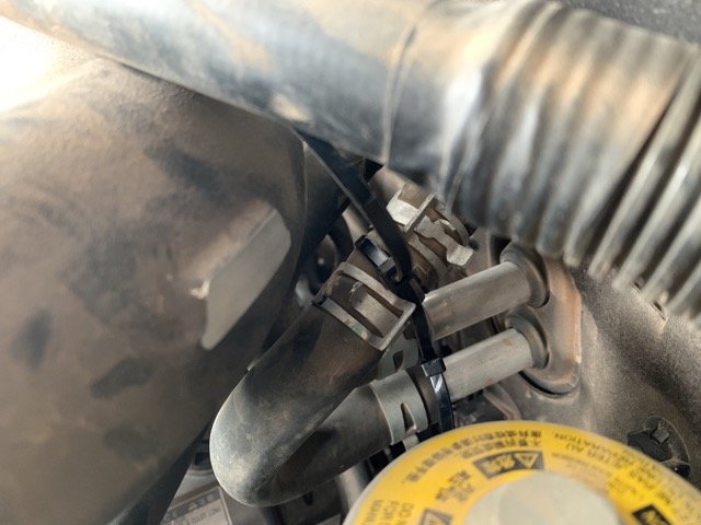

    My solution for the heater hose for now until I pull the blower off for some maintenance... zip tied the bend tighter so the clamp doesn't touch for now.

    Any of y'all Denver/Front range area people planning on doing a full bearing service on the supercharger (and are skilled to do it)?
    I'm about to pull the supercharger lid off to replace the seal that is allowing coolant to weep and will probably pull the whole blower (for fun) to install new spark plugs.
    While it's off, I'm at minimum replacing the coupler and changing the oil, but it's probably a good time to replace the bearings.
    Or if you just recommend sending it out since it may be a bear of a job or too risky, I'll do that. I now have a garage spot that I can leave the truck in a disabled state if necessary.

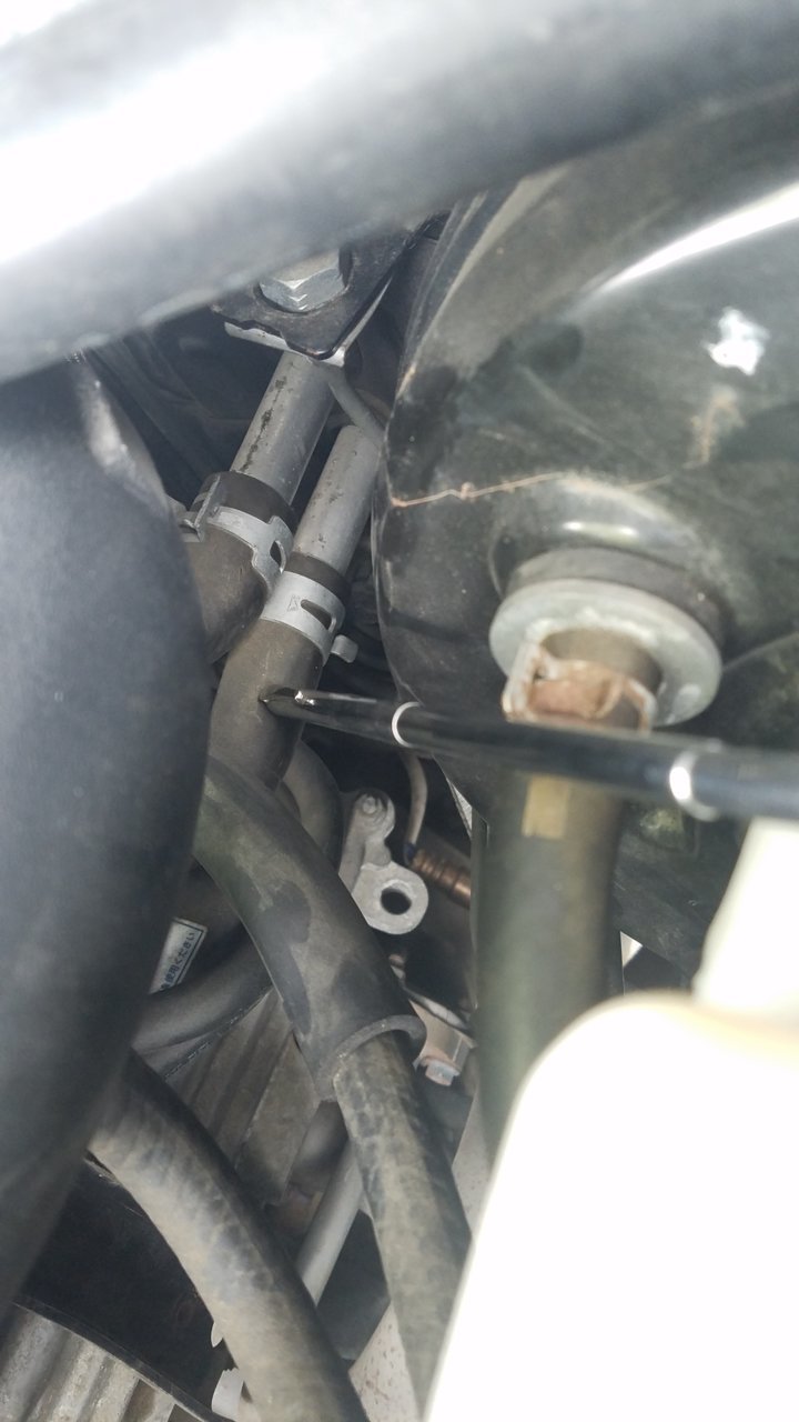

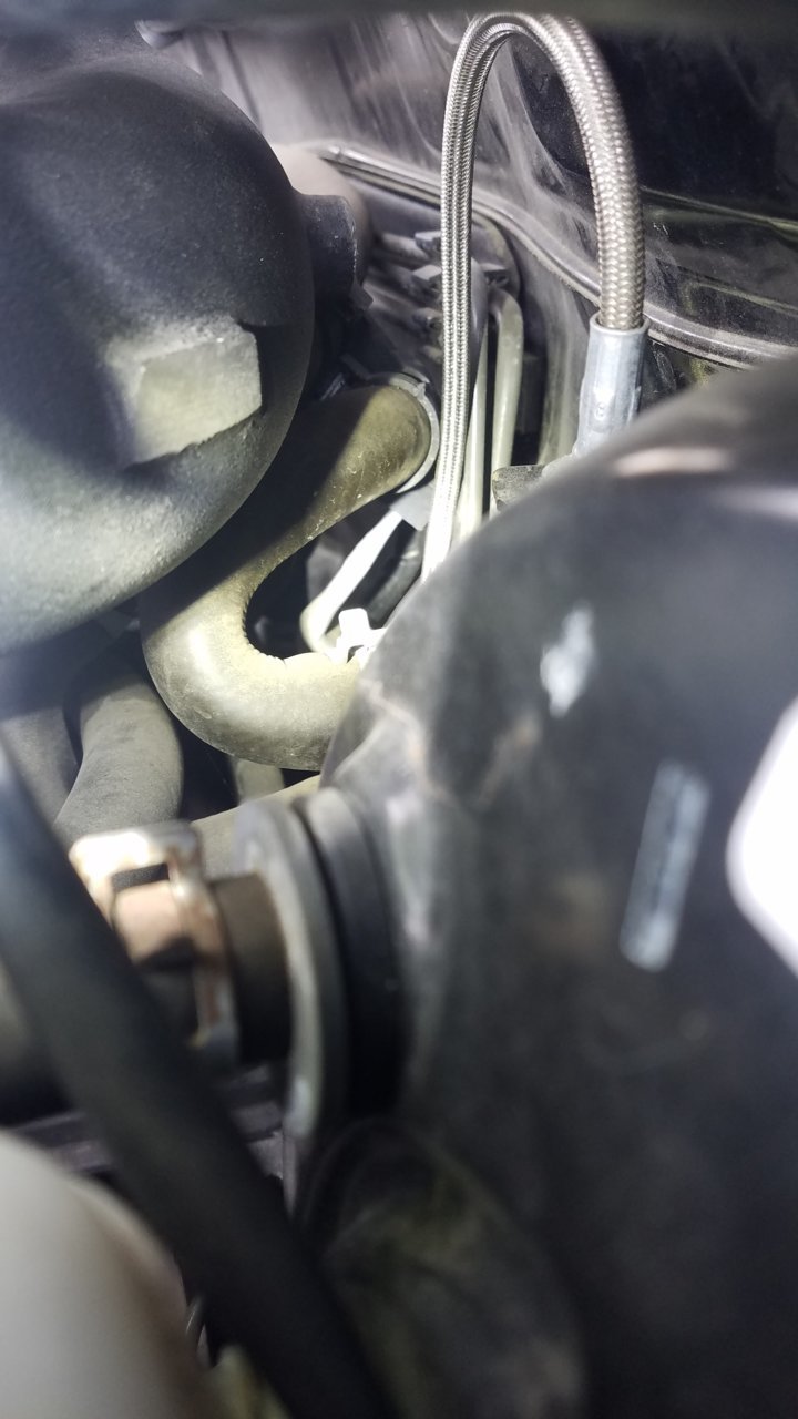

    It’s hard to see where it’s coming from since it doesn’t do it all the time. The only thing wrong with the truck that I know of steering rack is leaking.
  16. Apr 3, 2022 at 2:44 PM
    TheFang
    TheFang No Big Deal
    Jul 15, 2014
    #133985
    2,642
    SoCal
    Tacoma TRD Sport
    TRD Exhaust, URD Short Shift, TRD Supercharger, Hellwig rear sway bar, TWM shift knob, limo tint, URD Y-pipe, URD LT Headers, URD Rear O2 Sim, Custom tube front and rear bumpers, LED spot pods, K&N CAI
    Ok wow. I thought I was good.
    Nothing in sight right?
    That bugger is up underneath the SC. I'll snap a pic, battery on my phone is too low atm to flash the camera. But its there!!!

    20220403_144849.jpgThe lower house, that my pointer is on, loops up and has two clamps on it. That's the clamp that is marring my SC.

    Could I replace the tension clamp on my OEM heater hose with a hose clamp like the ones that come with the HPS hoses? Any reason why OEM and HPS use different styles?
    As that would negate the problem before it even starts for me.
