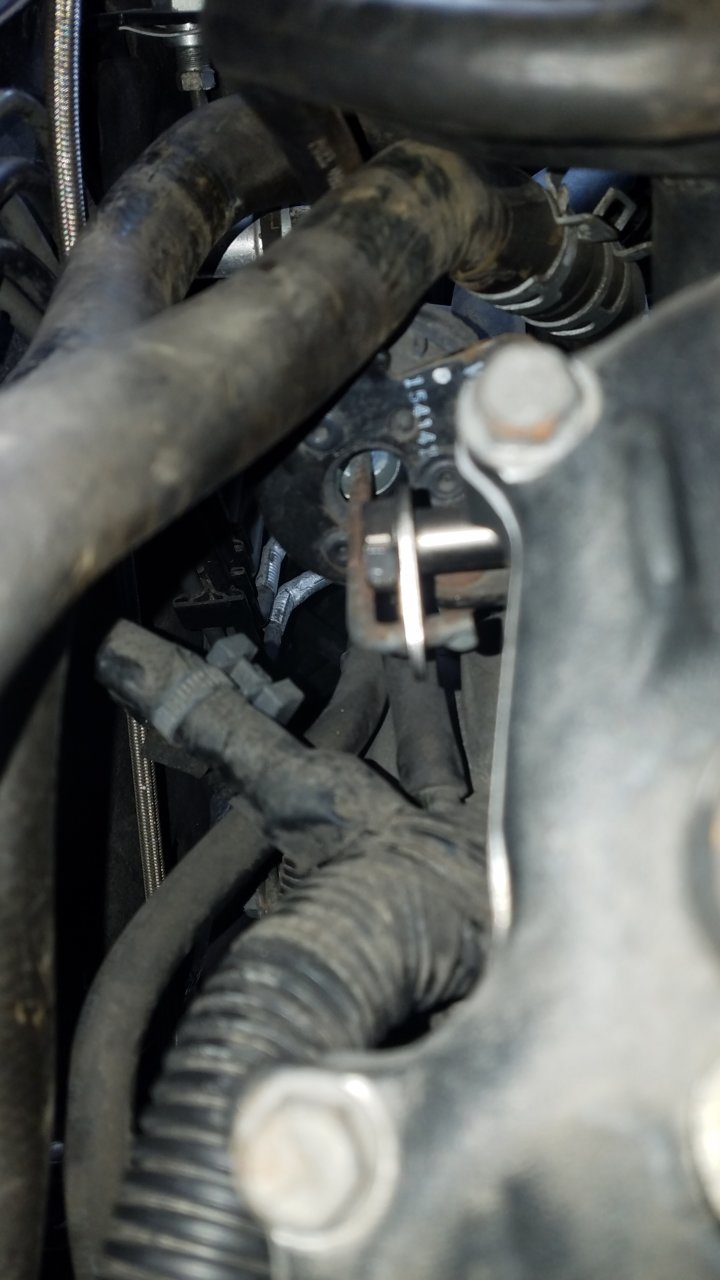

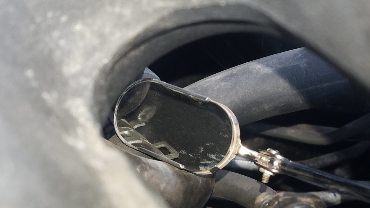

    That is taken from the top of the SC through the loop of the intake.
    Another find.... right where all these evil clamps are there is a bracket. A bracket that isn't attached to anything! Clearly this used to hold the heater hoses, but was removed to fit the SC. Anyone else have a loose bracket?

    Pic of the bracket that isn't doing anything. I took it out. It was just in the way of me manipulating the hoses.
    And then I just routed the lower hose around the actuator thingy on the back of the SC. In this pic it has the number 15414 on it. There is a nice space there that even when I move the hose to any extream the clamps dont touch anything.
    I also rotated the top clamp so the tabs point away from the SC. No small feat as there is zero room to work. I managed to push/pull the hose towards the driver side and work on it there.

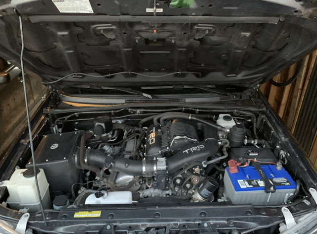

    hows this preliminary cleaning?
    ARoman83, henryp, SUMOTNK and 3 others like this.

    Acceptable :D

    I have a bottle of P21S on the way and a fresh bag of 50 microfiber cloths ready to go.

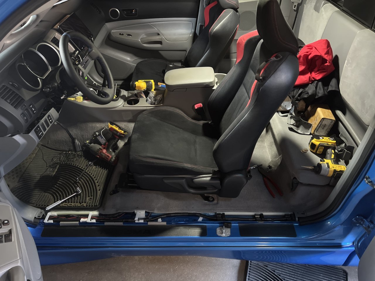

    All bolted down. As low and far back as I could go haha cuz I’m huge and all. But feels awesome. Just gotta get wiring figured out now. 09455ACB-AF1B-4DA3-8F6C-875DCFA01448.jpg

    Nice. I swapped mine out to a Corbeau similar model. The point of me doing mine was to be as low as possible as well. I found a guy on here that made me a mod using a resistor to knock out the seatbelt warning.
