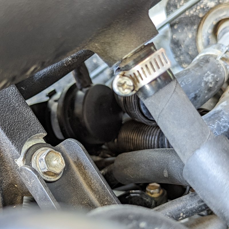

    Removed them and just zip tied.
    Wow you guys are having lots of problems. Try cutting the hose shorter towards the firewall so it pulls away from the s/c. You can see the bend is more than enough coming from the firewall. Also it doesn't have to run as long as Magnuson suggests but good to have some length for the motor rocking. Solid motor mounts will solve this.

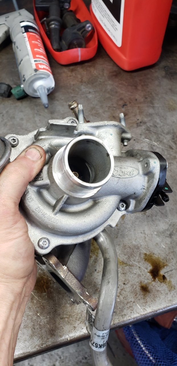

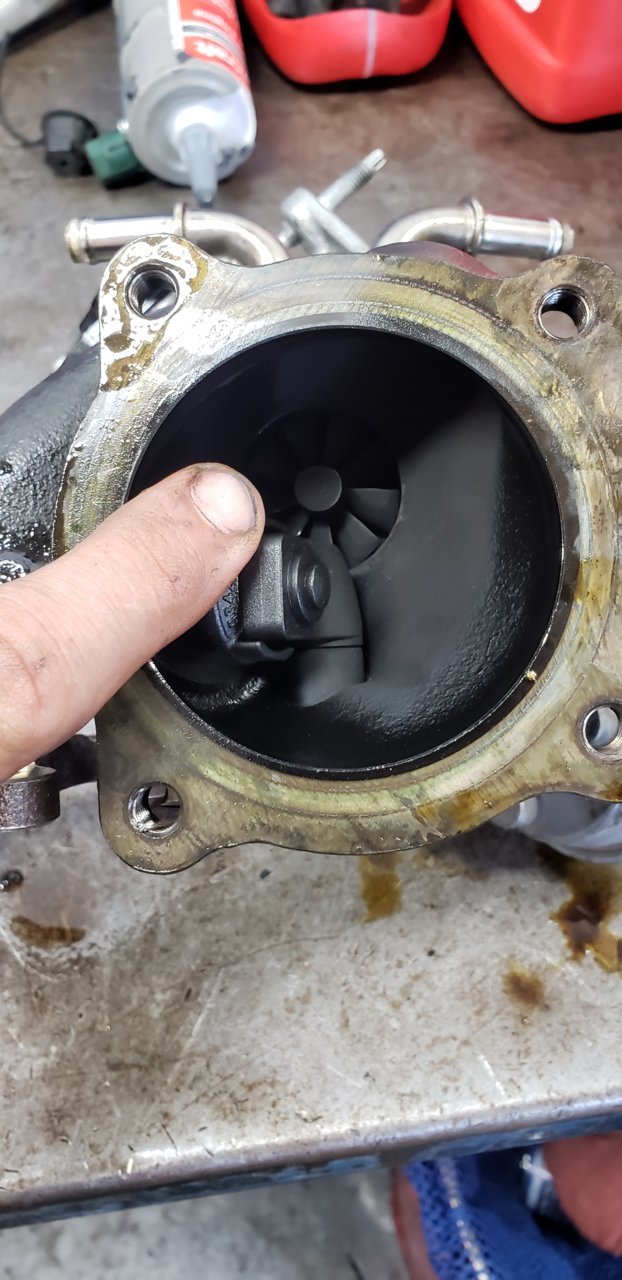

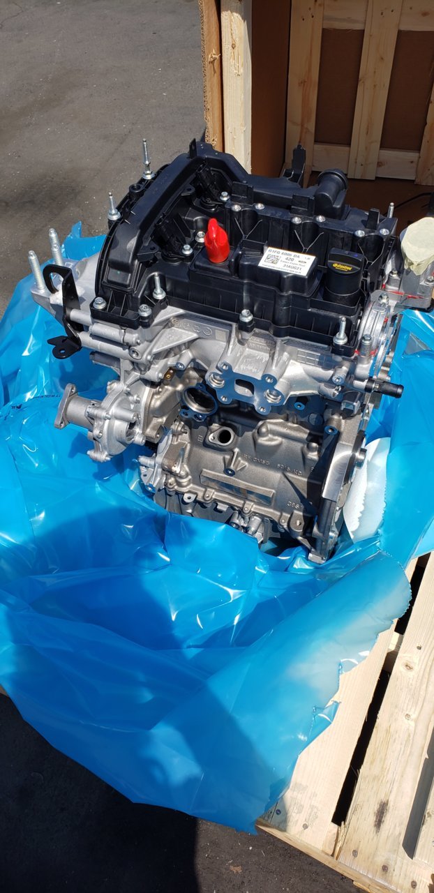

    Check out the tiny size of the Ecoboost 3 cylinder 1.0L turbo...
    This is a common problem with this motor..

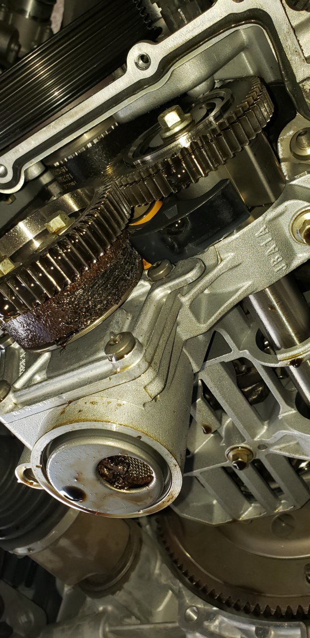

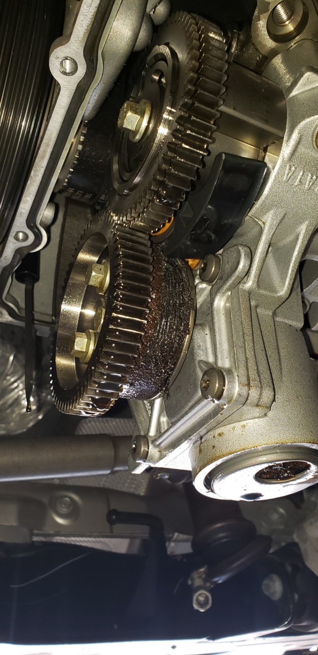

    Is that belt material or sludge build up?
  11. Apr 5, 2022 at 2:15 PM
    MonkeyProof
    MonkeyProof Power Top
    Oct 7, 2008
    #9774
    12,809
    SoCal- SGV
    Belt material. Travels everywhere and contaminates everything..
    There's only one acceptable fix, a long block. Warranty only pays 10 hours..
