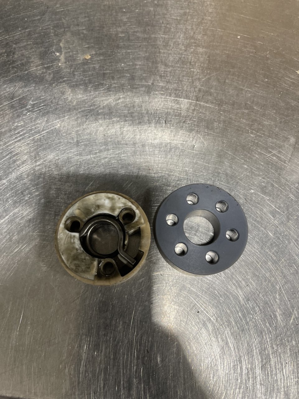

    ugh, didn't read and got busted. thought 2.7" URD pulley was plug and play so cranked it on there until i noticed it wouldn't spin. pulled it off and checked URD website. oh yeah, snout trim. i begrudgingly ordered 2.85.
    i have to replace current 2.85 setup because i got the blingy one and live in CA. i was excited to go 2.7 because i got a used one in decent shape for $60 and had visions of moar boost. now i'm out $160 for the new 2.85, $100+ for the billet 2.85, and $60 for the used 2.7. Ended up paying 2x the cost of a 2.85 by trying to be cheap with the supergrip pulley. Perfect TW math.

    The snout coupler is one of the easier mods to do. It just takes time because of the steps you have to take to remove it and reinstall it for sure.

    indeed. in my younger days i would have totally fucked this up. i backed out the press tool midway through to check progress and noticed something wrong. by the time i'm 80 i'll have it all figured out.

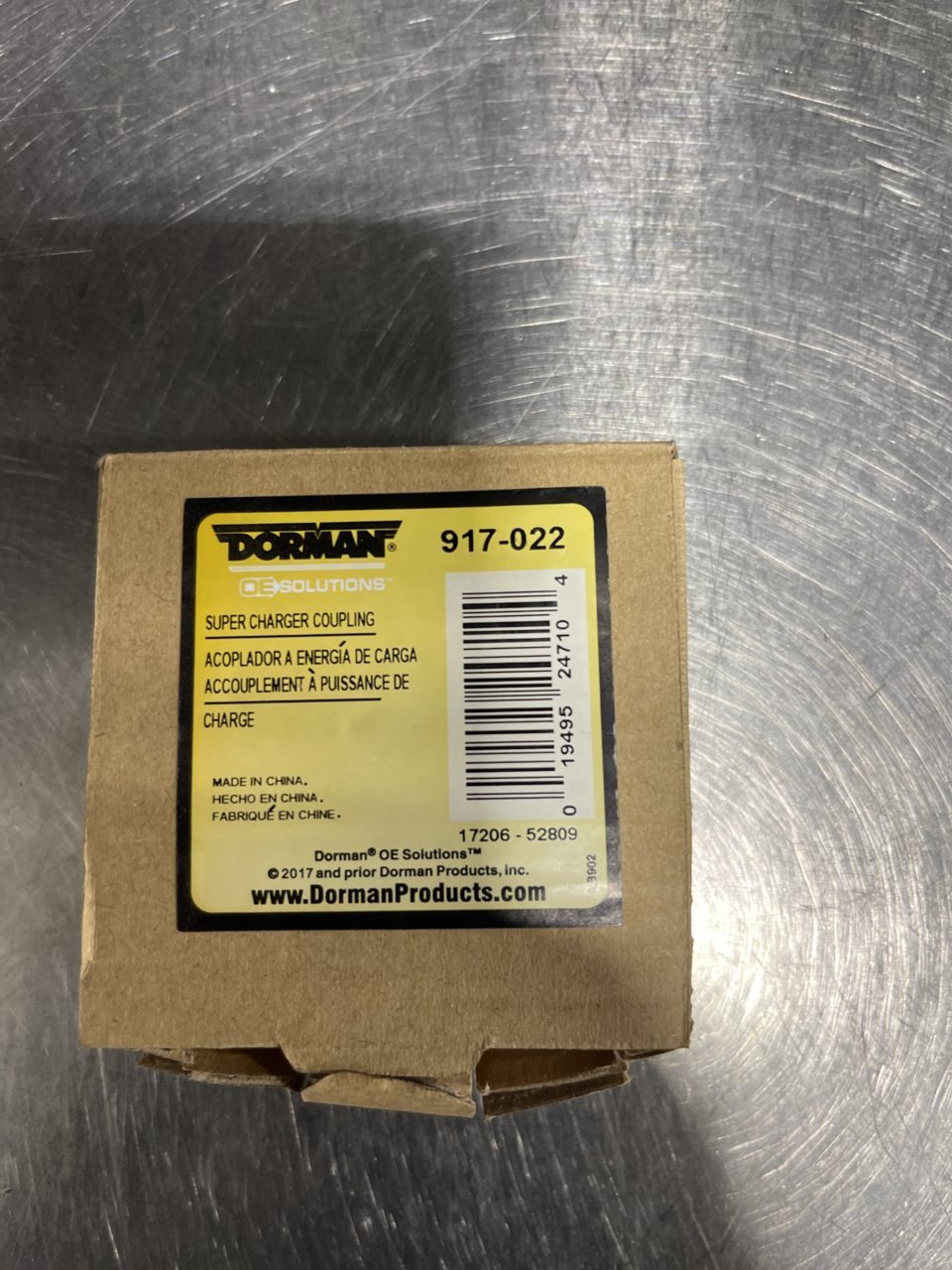

  16. Apr 13, 2022 at 8:03 AM
    vegasstaco
    vegasstaco Well-Known Member
    Mar 30, 2012
    #75953
    127
    Jose
    N,W Houston
    4x4 TRD Sport
    Many

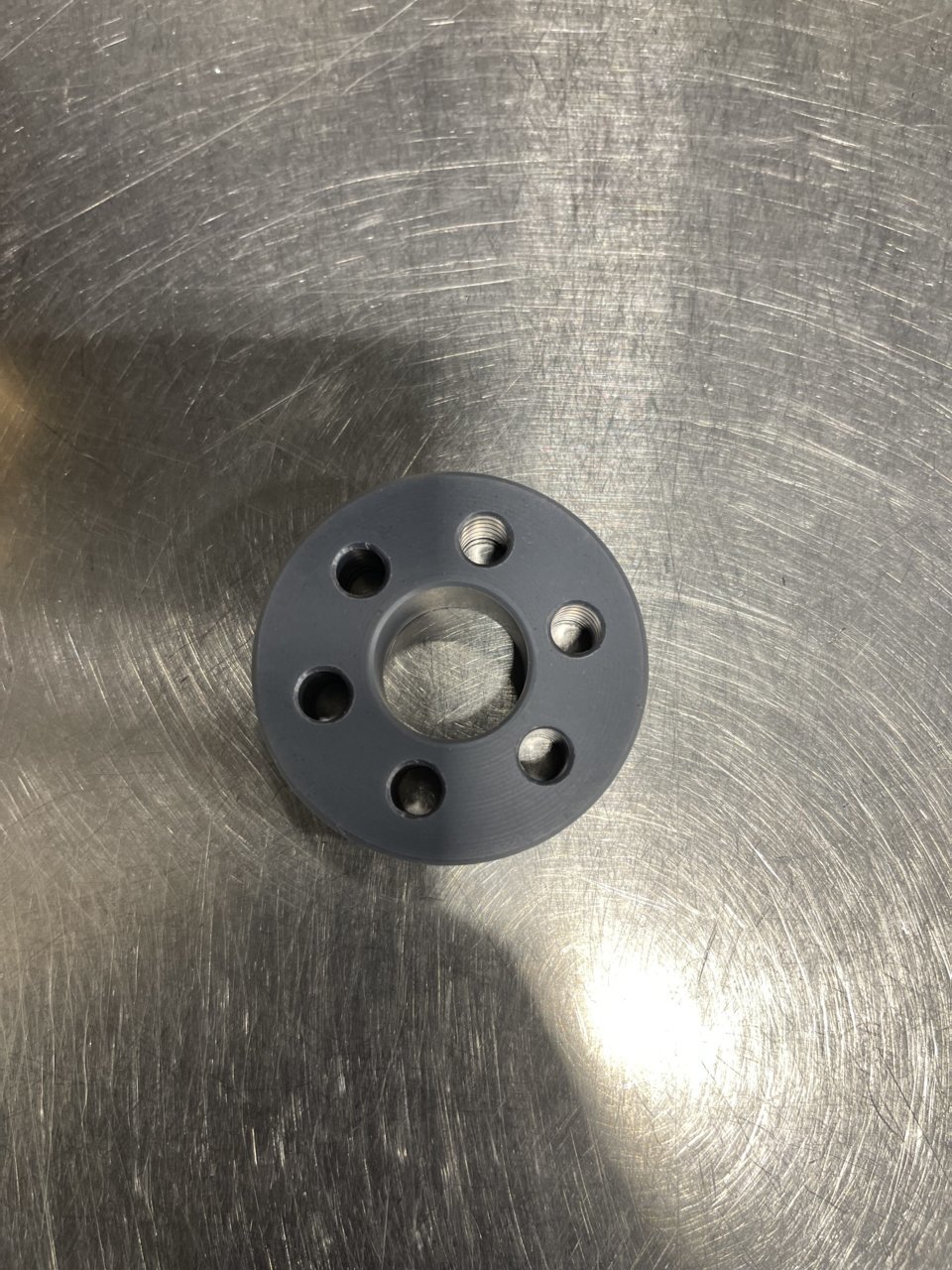

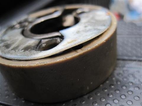

    Can I ask why or what caused to replace it?
  17. Apr 13, 2022 at 8:45 AM
    scootter82
    scootter82 Well-Known Member
    Oct 2, 2016
    #198816
    2,028
    Aurora, CO
    They blow out like pic below. Mine was worse when I removed it at 80k miles on s/c
    12TRDTacoma[OP] likes this.
  18. Apr 13, 2022 at 8:45 AM
    zachmck01
    zachmck01 Member
    Apr 10, 2022
    #394711
    9
    2013 Tacoma Trd sport
    It was rattling at idle
    DocME and 12TRDTacoma[OP] like this.
  19. Apr 13, 2022 at 10:37 AM
    DocME
    DocME Well-Known Member
    Aug 24, 2018
    #263956
    1,583
    California
    '07 FJ Cruiser
    TRD S/C, UCON, 61# inj, 2.5 pulley, 7th inj, Roostfactor Y Pipe, URD exhaust, WAT Nomad Valve body, Dana 60, DK LT, JD FAB LCA mounts, custom roof rack...and way too many others.
    My spring coupling only lated 90k. Definitely good to git it swapped out.

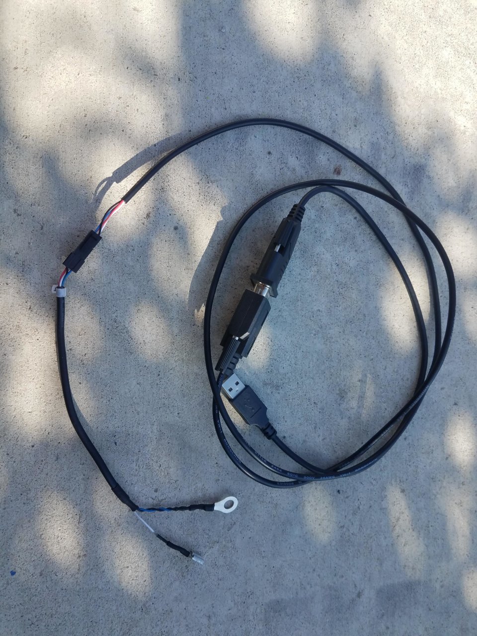

  20. Apr 13, 2022 at 11:05 AM
    JasonLee
    JasonLee Hello? I'm a truck.
    May 9, 2014
    #129454
    12,305
    Jason
    Q322+3C Denver, Colorado
    15 TRD OffRoad
    TRD Supercharger and more.
    Would the HP Tuners MPVI-2 PRO work to pull in the AFR data? It says it has two analog inputs. I know it's quite an expensive add-on, but for those not wanting to have extra cables and don't mind spending extra money, this is another solution.
    Durable manufacturing - made of high-strength polyurethane
    Cool, I may buy this to save on some shipping and having to order stuff some so many sources and paying out the nose for shipping on all of them.
