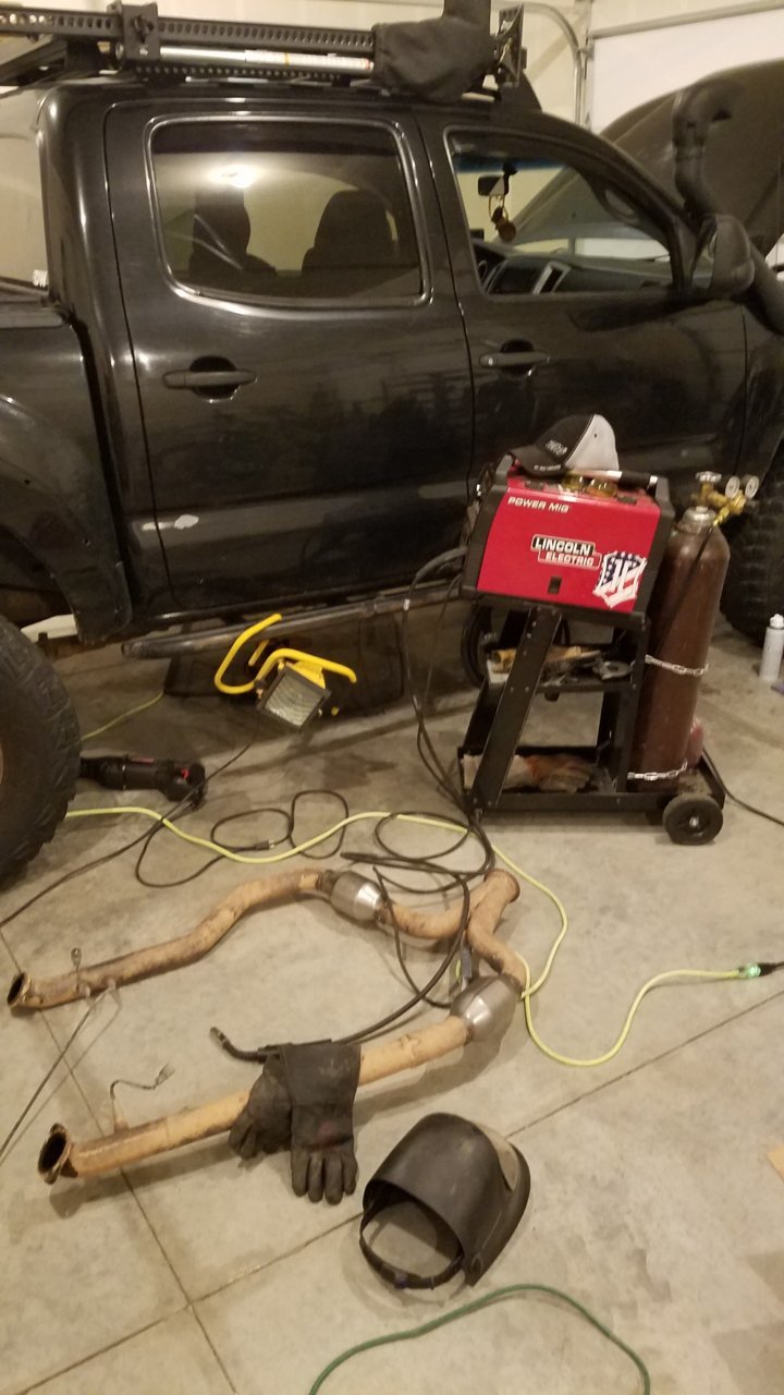

    Couple more stitches left. I really hope it finally sounds good. Lol

    Man, those are little guys aren't they. Yeah, sure hope it takes the buzz off.
    Make sure you check for clearance to the transfer case actuator. You may want a heat shield of some sort.

    It totally took the buzz away and it sounds like a straight six now. Definitely going to make a heat shield of sorts. And my ass dyno says it was what it needed. Took a pull onto the freeway and the AFR only dipped into the 9's instead of the 8's.
