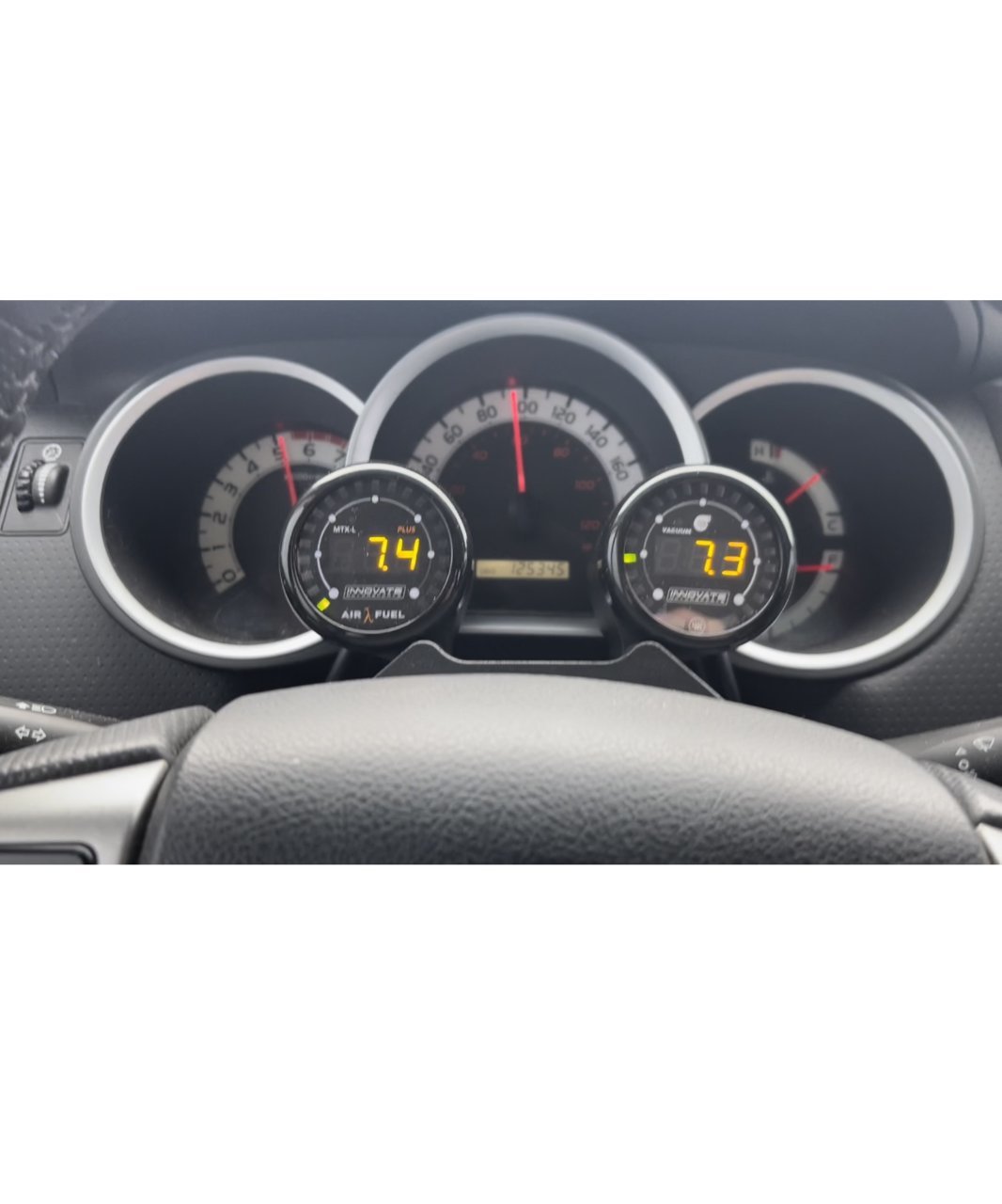

    Hey guys. Just put my supercharger on my 13’ last week. Uploaded the Trd tune onto it and all went well.
    I have the innovate wideband installed in the “y” pipe where they join to 1. (Calibrated the sensor as per manual)
    Took the truck for a few pulls and noticed at WOT I’m running 7.4AFR at 6.5-7psi boost. This is crazy rich??? Sensor works great till I’m WOT it goes to 7.4 under boost and stays at that.
    Anyone ever have this issue?

    The TRD tune is really rich. A good tune will correct that.

    even mine wasnt that rich with methanol overload on trd. possibly dirty air filter or just how those gauges read. better than too lean!

    Are those wide bands? Wow, that looks really rich but seems hard to believe

    Oh boy. You're using innovates. Those gauges are a big no no because they are known to read incorrectly and have general E8 errors at random. They also run Bosch sensors and those are horrid as well because they have a tendency to just die for no reason. Just because they feel like it.
    There is a big chance those gauges could be wrong, but based on the fact that you are seeing similar readings on bank 1 and 2 that is telling me you have a huge overfueling issue. You may have something hooked up wrong. Regardless, it would be smart to hook up a scanner and check your STFT's and LTFT's. I can assist you more on what you need to do following that, but from here you need to do that first.
    Did you perform the FPR mod (AKA boost reference the fuel pressure regulator) on an otherwise currently factory setup? What type of fuel pump are you running?

    I thought Innovate was good for AFR but not so good for boost? minus the sensors.
