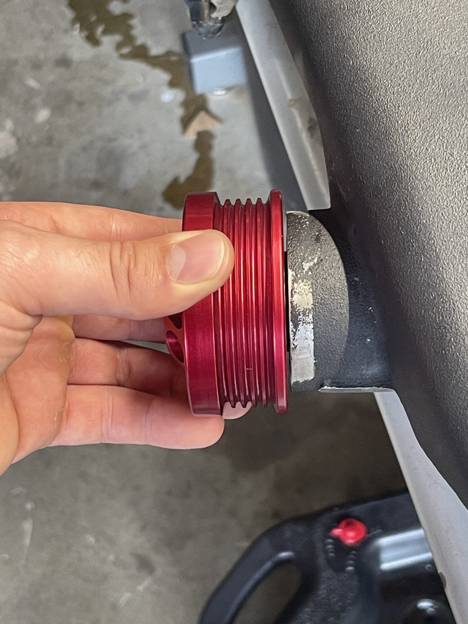

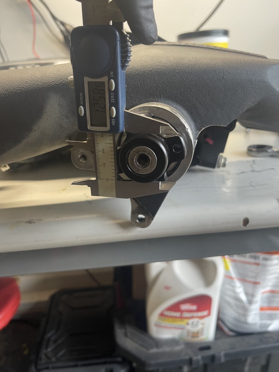

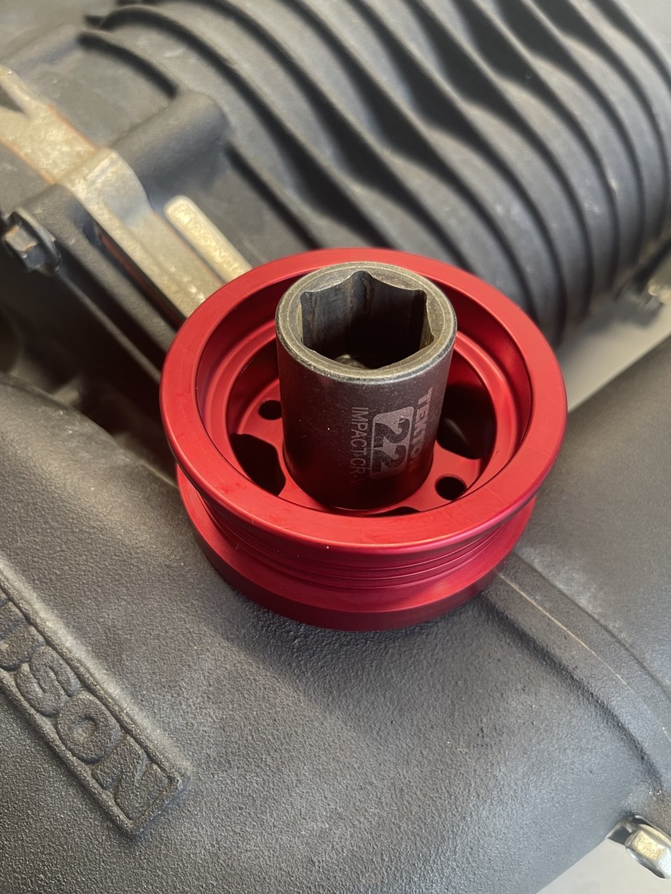

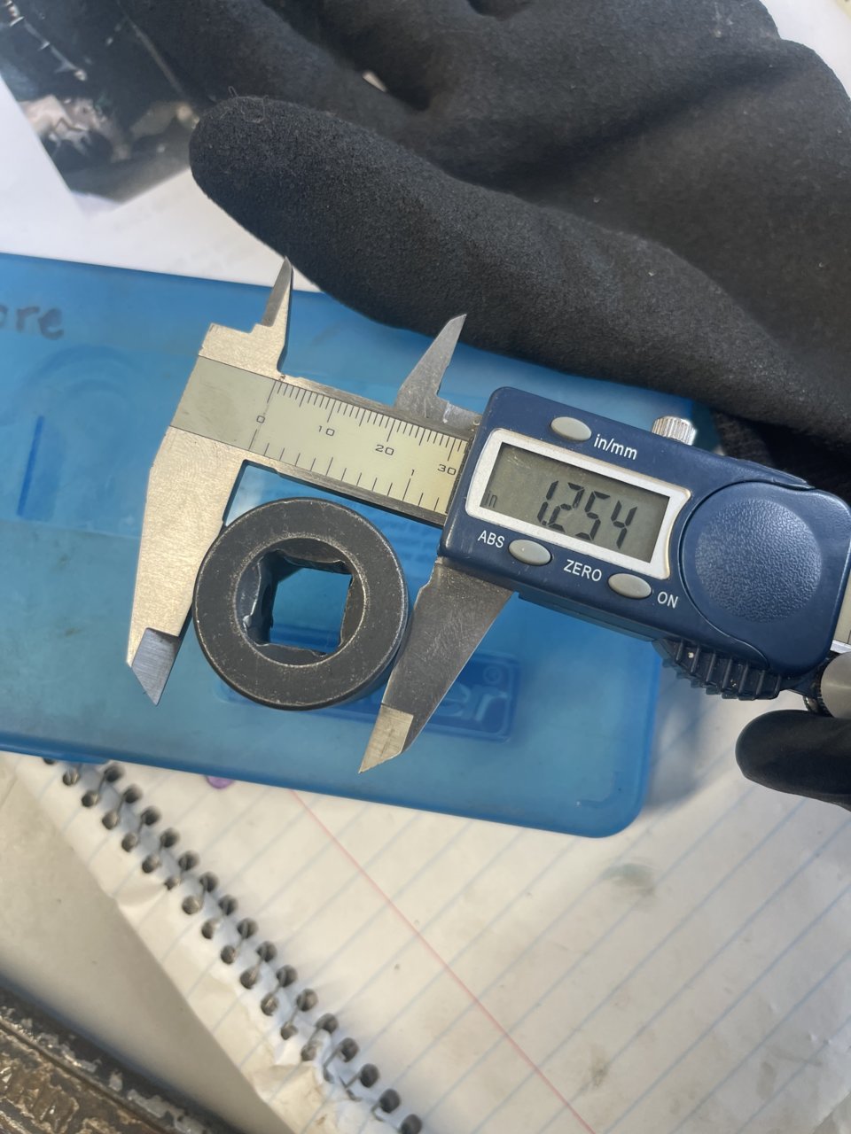

    Anyone have issues with the URD quick change pulley not fitting? Pressed the hub on and go to bolt the pulley to the hub and it won’t fit. Should have checked fitment of the hub to pulley before I pressed the hub on but I assumed it was properly machined and would fit… Emailed URD to resolve but figured I’d ask here too
    Fortunately the whole top of the engine is still disassembled so it’s not putting me down but still a little annoying
    1.258” - Hub OD
    Didn’t have correct calipers to reach into bore of pulley but a 1.254” socket wouldn’t fit
    ….kinda defeats the purpose of ‘quick’ and ‘change’ if it has to be pressed onto the hub :bananadead:

    Your snout doesn’t look trimmed down.

    Not required for a 2.8” pulley
    Snout dia - 2.406”
    Pulley ID - 2.466”
