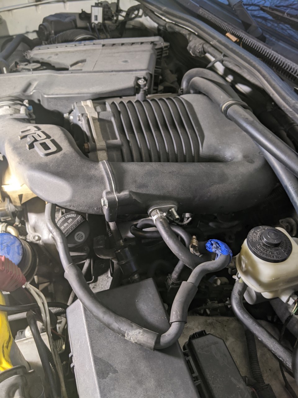

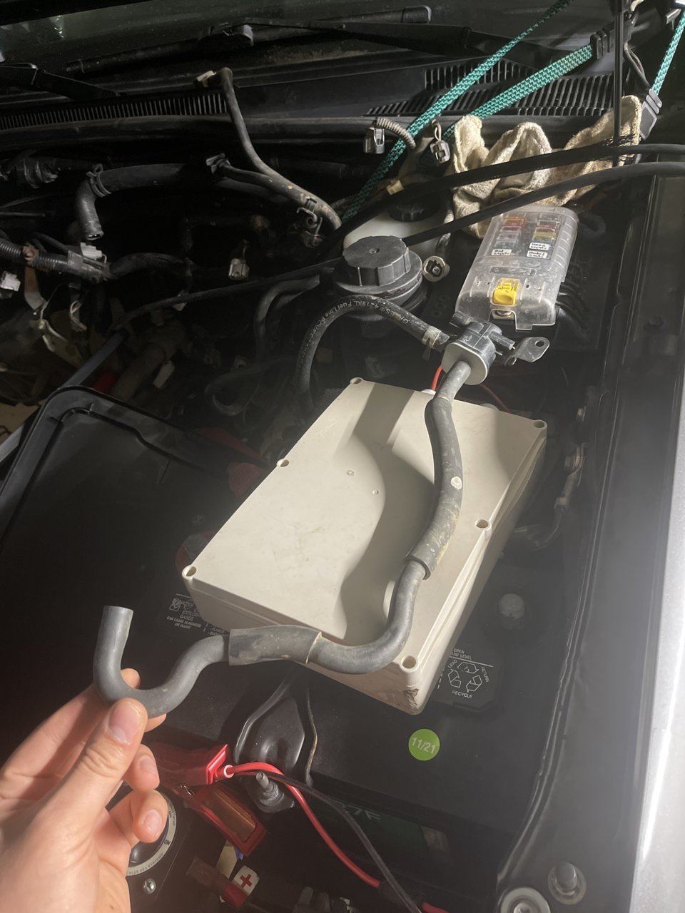

    Yes
    Long side goes to this guy that’s mounted below the SC, near the oil filler tube. Curved side goes to the expose nipple that is in your pic

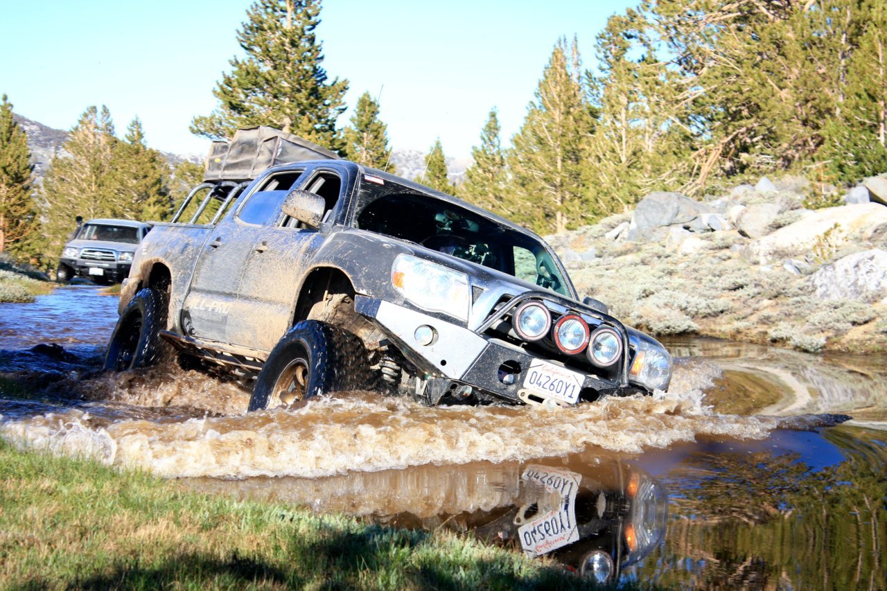

    Speaking of water crossings again... We went back out to the same spot we scouted Wednesday to camp this weekend, where I attempted the crossing and boogered my URD Sims. Well.. we checked it out again and long story short.. idk if the water did it.. or it just finally fully dried out with the heat and wheeling all day.. but it fixed itself.. no more codes.. lol
    and we definitely werent able to cross again.. still too much water. We will be going back in a month or 2 when its lower. Our buddy we were with in his 3rd gen 4Runner attempted it first this time as well and the front end started to float not even halfway across and got water in the cab.. so we bailed until next time. I need to get those Sims up into the cab and make sure other stuff is sealed properly for sure.

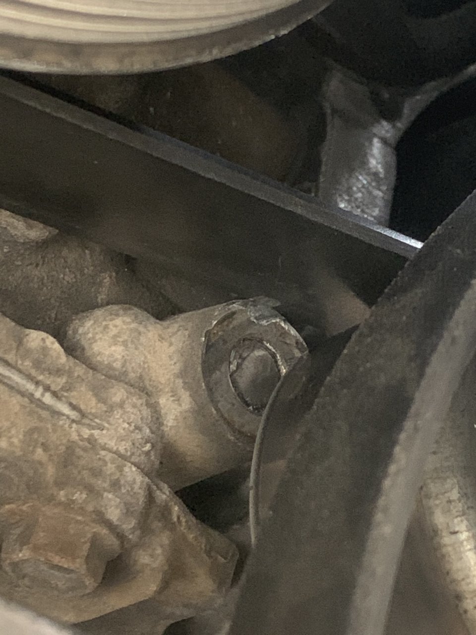

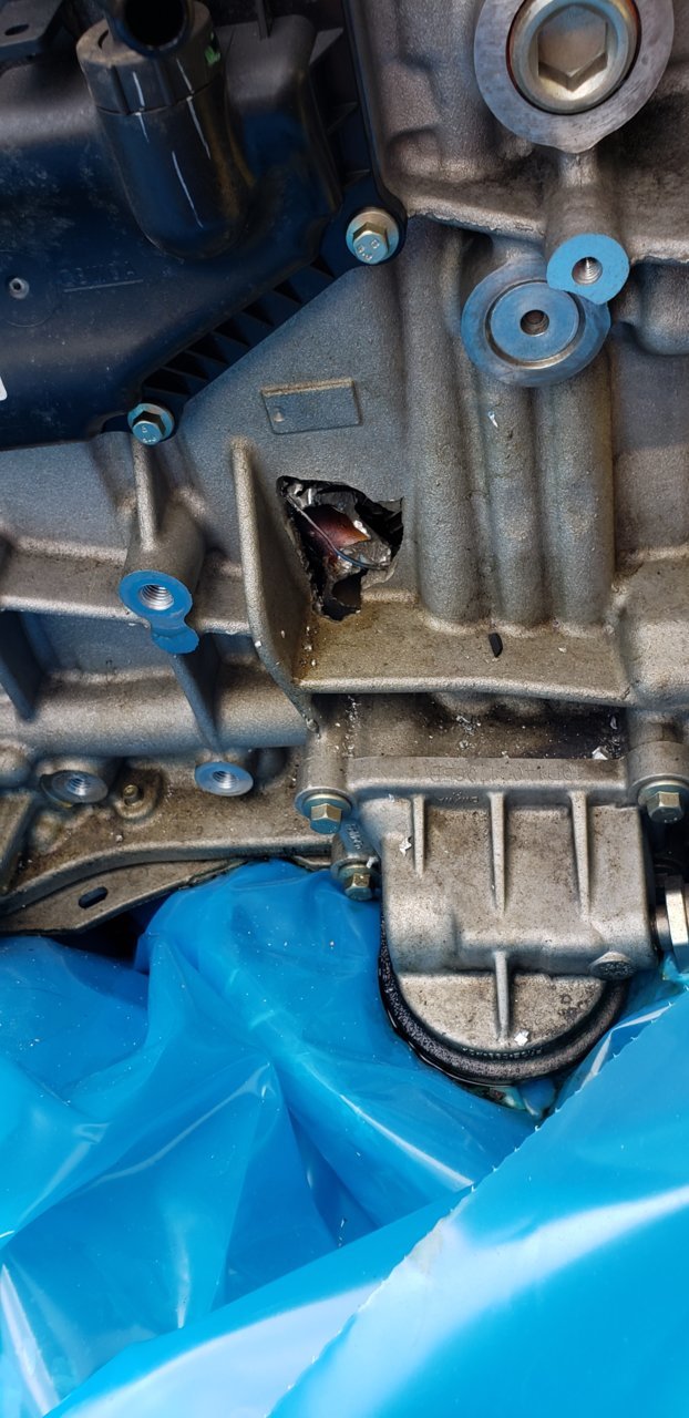

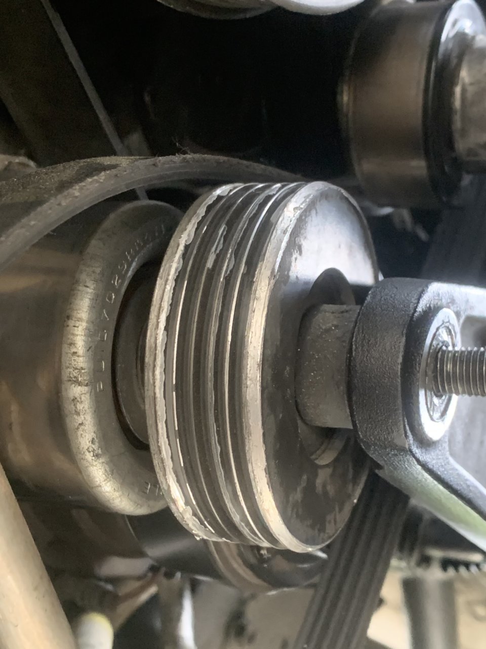

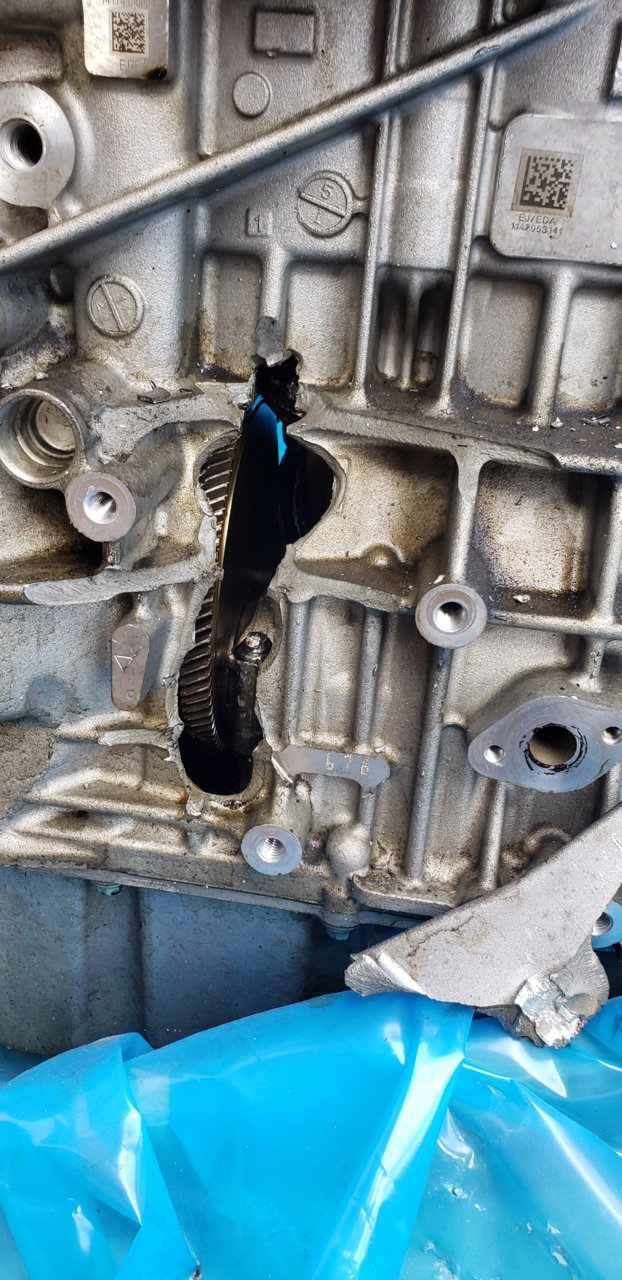

    Uh oh. We got another member with a snapped lower pulley retention stud on the timing cover. For sake of anonymity, I'm going to keep their name concealed unless they chime in openly about it, but here are the pictures of their damage.
    Currently unknown what sort of tensioner was being used.

  14. Apr 19, 2022 at 11:21 AM
    Murphinator
    Murphinator Well-Known Member
    Mar 1, 2015
    #149903
    3,335
    Anthony
    SoCal
    14 DCSB 4x4
    Pictures aren’t loading, did it snap in the same spot that yours did?
  15. Apr 19, 2022 at 11:22 AM
    12TRDTacoma
    12TRDTacoma [OP] Powered by Ford, GM, VW, and Mercedes
    Aug 20, 2012
    #85133
    16,680
    Rob
    Concordia
    12 TRD Sport DCLB 4x4 Supercharged
    Boosted
    Yes it did, in the exact same fashion. OE TENSIONER. :eek:

  19. Apr 19, 2022 at 11:26 AM
    Murphinator
    Mar 1, 2015
    #149903
    3,335
    Anthony
    SoCal
    14 DCSB 4x4
    What pulley size are they using on the supercharger, and are they using any of the nst pulleys? If not oe 3.0 pulley what belt were they running?
    Just trying to cut out as many variables as we can, that way we can get an idea on what particular parts may be conflicting or if it’s just a bad batch of studs?

  20. Apr 19, 2022 at 11:26 AM
    12TRDTacoma
    Aug 20, 2012
    #85133
    16,680
    Rob
    Concordia
    Boosted
    Indeed. We might have an issue going on here boys. That stud may need to become a regular maintenance item.
