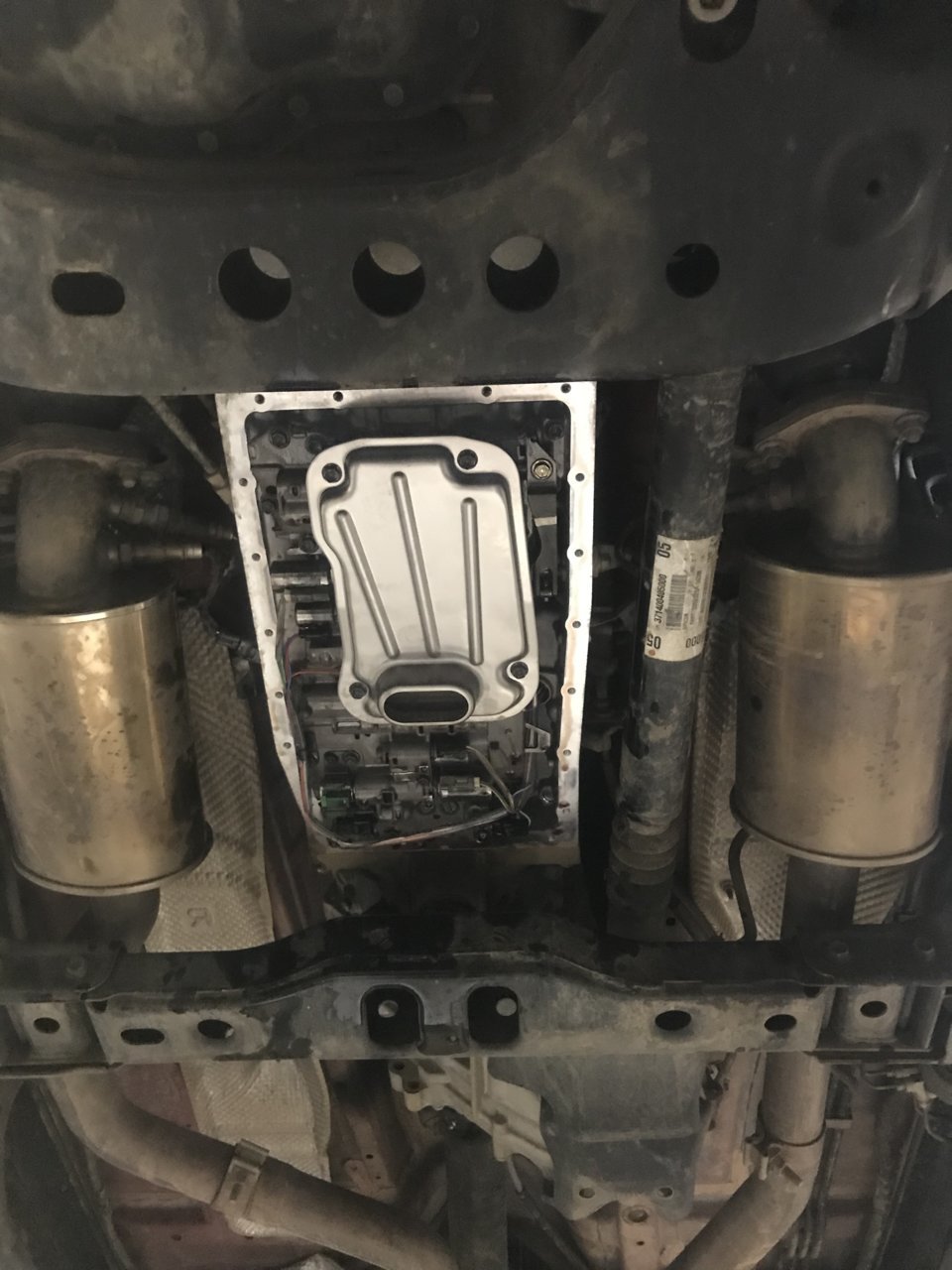

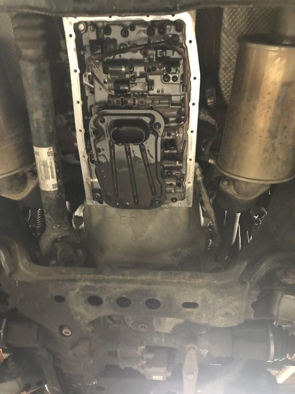

    Here goes nothing

    Easy peasy. I promise you it is well worth it. Git'er done man! :thumbsup:

    Time to fill her back up and see what we’ve done

    Whatcha got there? Some Vibrant Ultra quiets on a spec-u system? How quiet is it?

    Sure is. I’m running the ultra quiets up front and replaced the 3” ultra quiet with a center in/out 14” 4x9 maganflow. Headers drone a little in the cab but all you hear outside is s/c whine. I’m gonna redo a lot of it when I do my rear suspension, but I’ve been very happy with it so far. I used to own an exhaust shop back in the day. I’m not a huge fan of how our trucks sound opened up so I’m trying to keep as free flowing as possible while sounding as stock as possible.

    Your sensors are in a different soot than mine on my spec.u. Mine are a little father back from the flange. I didn't even have 8" between the sensor and the first bend on the passenger side for the little baby cats I put in last night. But mine is all super quiet now with the cats and the 18" glasspack added after the axle.

    After 50 or so miles on the Ratiotek kit I’m pretty happy. Haven’t pushed the truck hard yet but when I’ve gotten on it, I’ve been happy with the results. Definitely one of the best mods I’ve done since the S/C so far.
    Install was pretty easy but definitely nerve racking. I’d say if you don’t feel confident in installing something like cam gears then this may not be a job you want to attempt. If you follow the instructions and the write up it’s pretty simple, just be mindful of where and how you set parts down. If you dropped a part of the valve body after you’ve opened it up it could be disastrous.

    Looking forward to doing mine towards the end of summer. Looks like it only took you like 2hrs?

    If you include draining and filling it took 3
