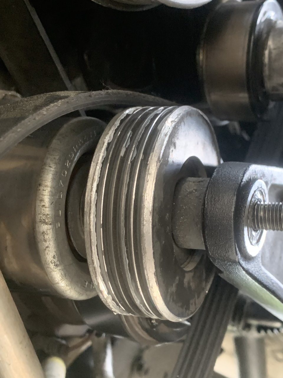

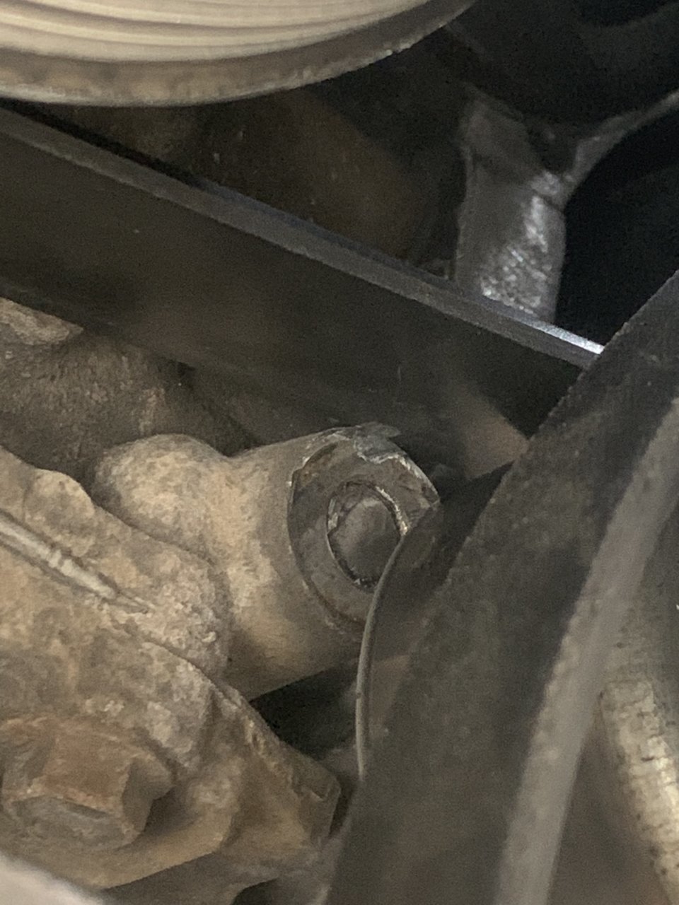

    MY assumption judging by the damage, is that the stud snapped, the continued force for however long it was broken wasted the support bracket and once it was gone the belt rubbed the outer lip of my pulley until it was shredded smooth btw. Seems to be the logical steps.

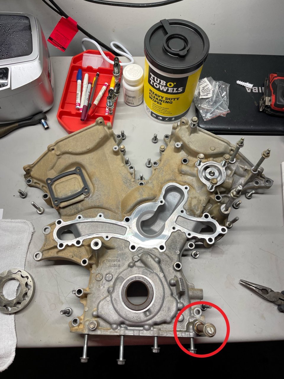

    One more little footnote, that lower stud breaks off in the timing cover not the T- case.

    Yeah I read that on the front page. Debating on seeing if it might just be worth it to call and just get a whole new C bag at this point. Waiting to hear back from Mag on whether they have a C bag in stock

    To be absolutely certain, the circled stud is the problem child, correct?
    I have the M-71-76-10-134 stud coming my way from Superchargers Online but just want to make sure I am replacing the right one.
  8. Apr 21, 2022 at 12:50 PM
    MightyMouseTom
    MightyMouseTom Balance off road vs on road performance
    Jul 11, 2019
    #298971
    1,119
    Tom
    San Antonio, Texas
    2013 Black DCSB
    2inch lift, 285/75/17 Nitto Trails Grapplers, Billy 6112/5100s AAL, Alpine Design Cab mount relocation, TRD Supercharger w/URD pulley, Volant Ram Air Intake, TRD Exhaust, Katzkin, TechDeck, Ram mounts, Audio w/hideaway kicker amp, CBI skid, Custom grille, and SS3 fogs
    Correct.

    Yep.

    I too have been a victim of the idler pulley #1 stud being broken recently. I'm currently at 47k miles on the charger.
    The replacement idler pulley from superchargers.com is at least 4 weeks backordered. I was at least able to order the replacement stud. I ordered the Dayco 89515 pulley and timken 6230-2rsc3 bearings for a temp replacement.
    I needed to extract the bolt from the timing cover. I used a 90 degree drill attachment to get in between that tight space, then used an extractor.
    I am currently reusing the old ribbed idler pulley, even though its a little damaged. I have no choice until the Dayco pulley and Timken bearings comes in.
    Now I dont trust those studs and looking for a better alternative.
