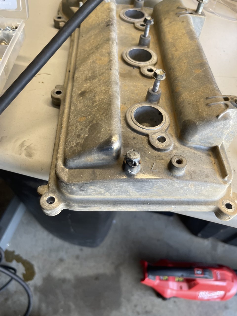

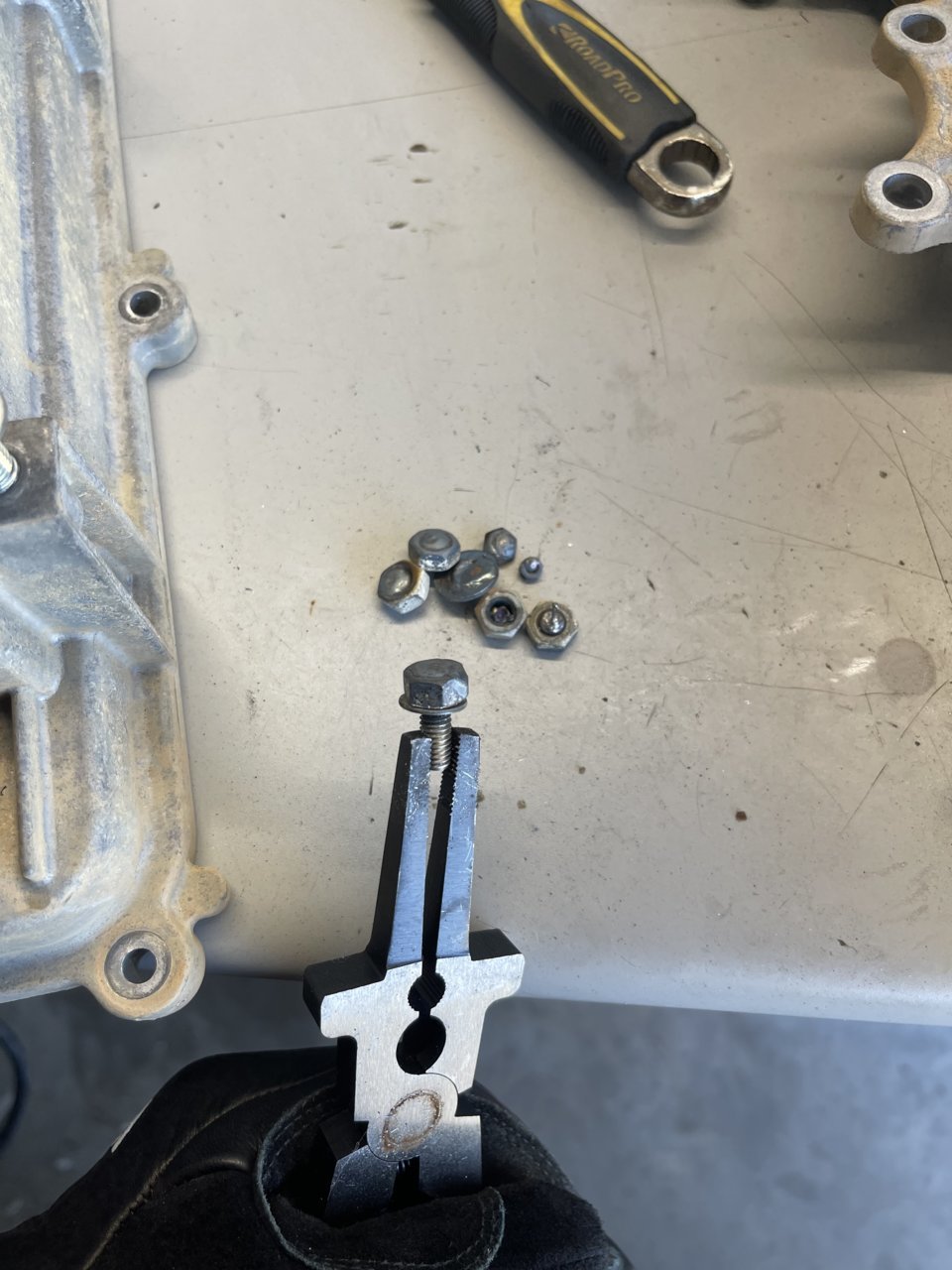

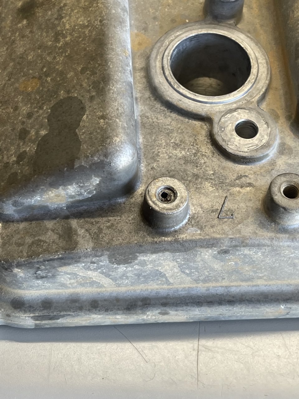

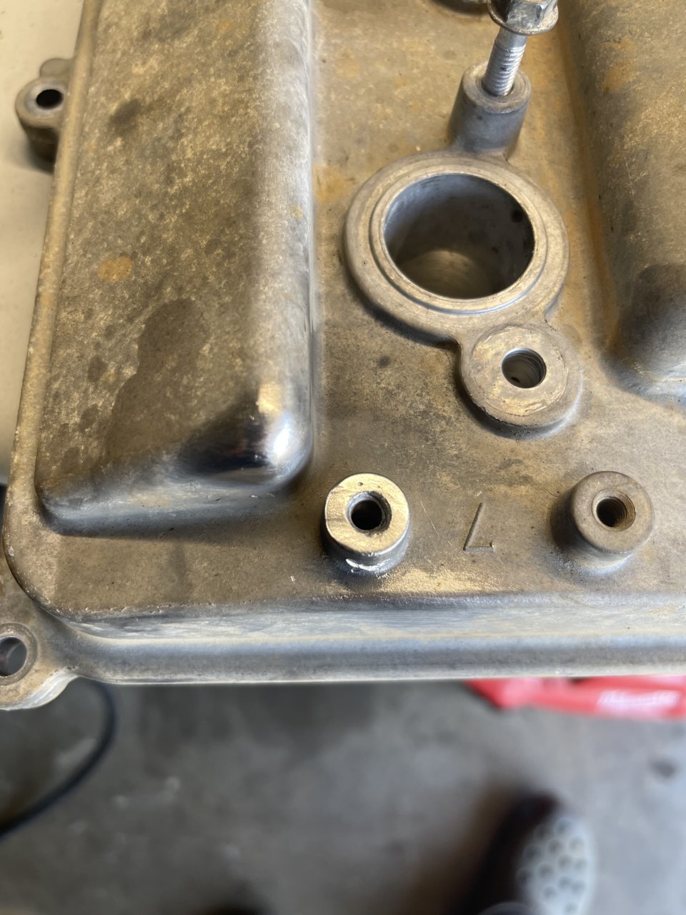

    Had to do this earlier today with a bolt the PO broke off in the valve cover… took a few attempts but it finally came out. I’d imagine it should work for you if you can get a solid weld on the broken bolt

    That's a grade 5 bolts that broke off in the valve cover. Very soft. The bolt that is broken inside of his T-cover is so hardened that it's basically the equal to a chromoly bolt.
    Extracting one versus the other is like comparing an apple to an orange.

    I’m a prolific nut welder for extraction. Should be especially good in this case because it’s such a large bolt that you can use a smaller nut and not risk getting into the aluminum. Aluminum is a great material for transferring heat, you should be good. I’d have a go at it for sure.
