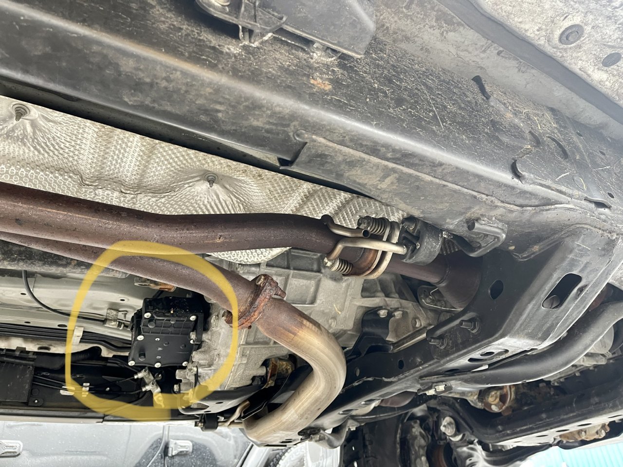

    Do you guys know what this is…..not my truck.

    thats the put it in 4wd motor actuator thing
