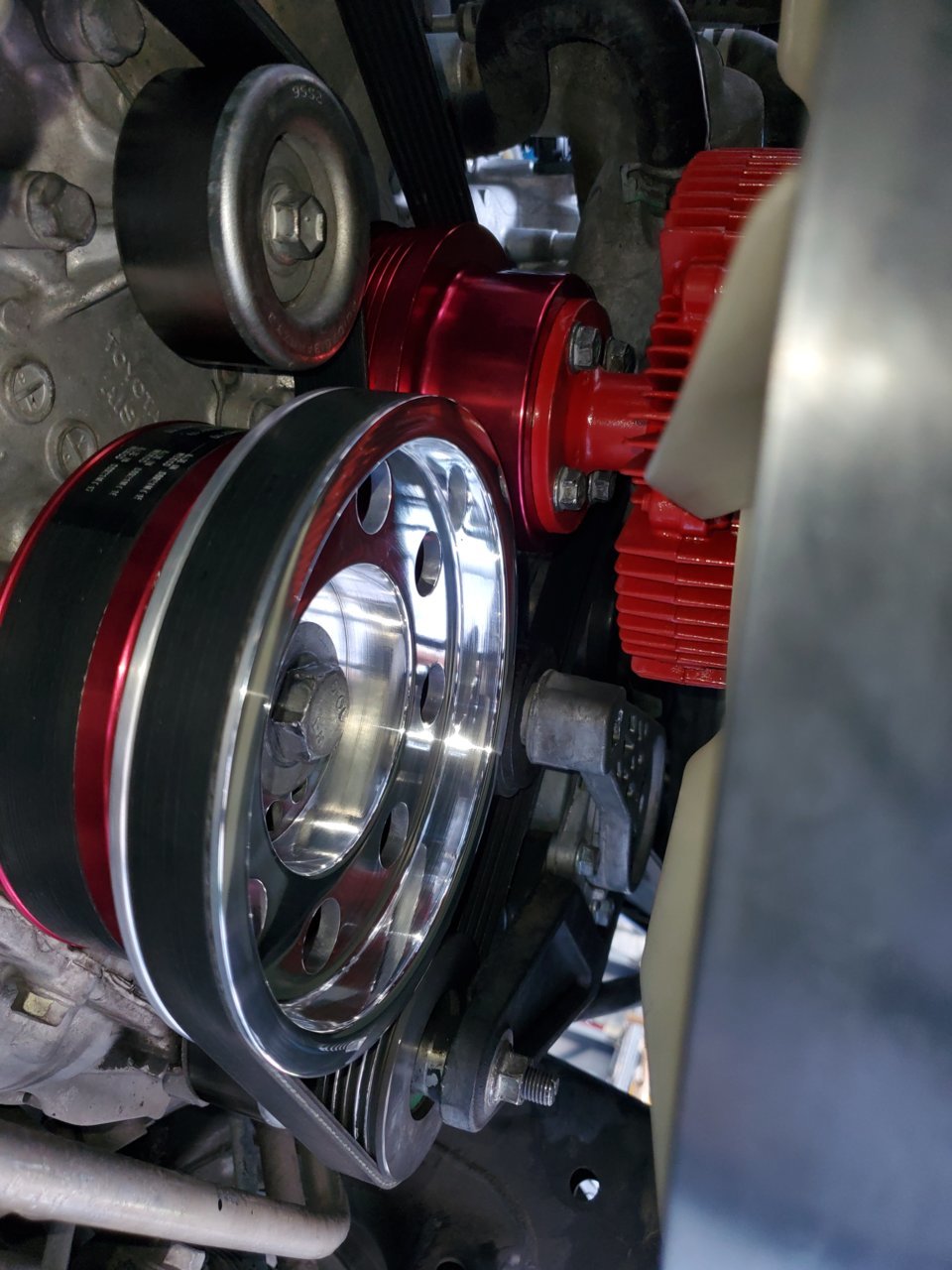

    Saturday Morning little project full set of aluminum pulleys!!

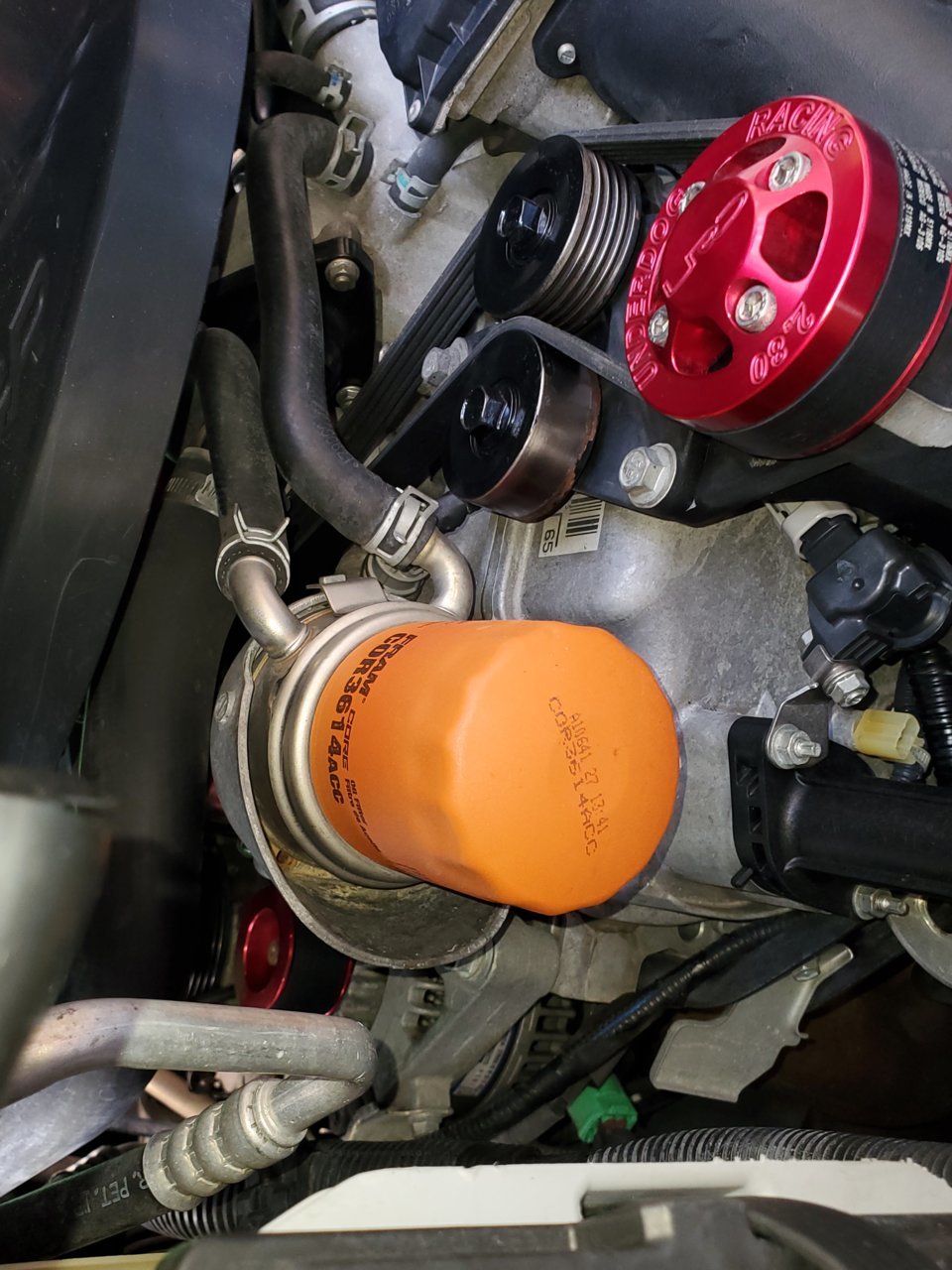

    For the guys using the Dayco pulley 89515 for idler pulley #1, which bearing are you using? I tried the Timken 6203-2RS-C3 bearing but seems a tad bit too small. Slides right in without having to press it.

    I am using the OE bearing that it came with. It can handle supercharger pulley sizes up to a 2.7 without an issue, so it's a good solution which is capable of speeds handling most of our applications. If you are higher altitude and are using a smaller pulley or are running higher levels of boost in general then you will need to replace the bearing for sure.
    I was having a lot of issues grabbing a Timken bearing, so I never tried it.

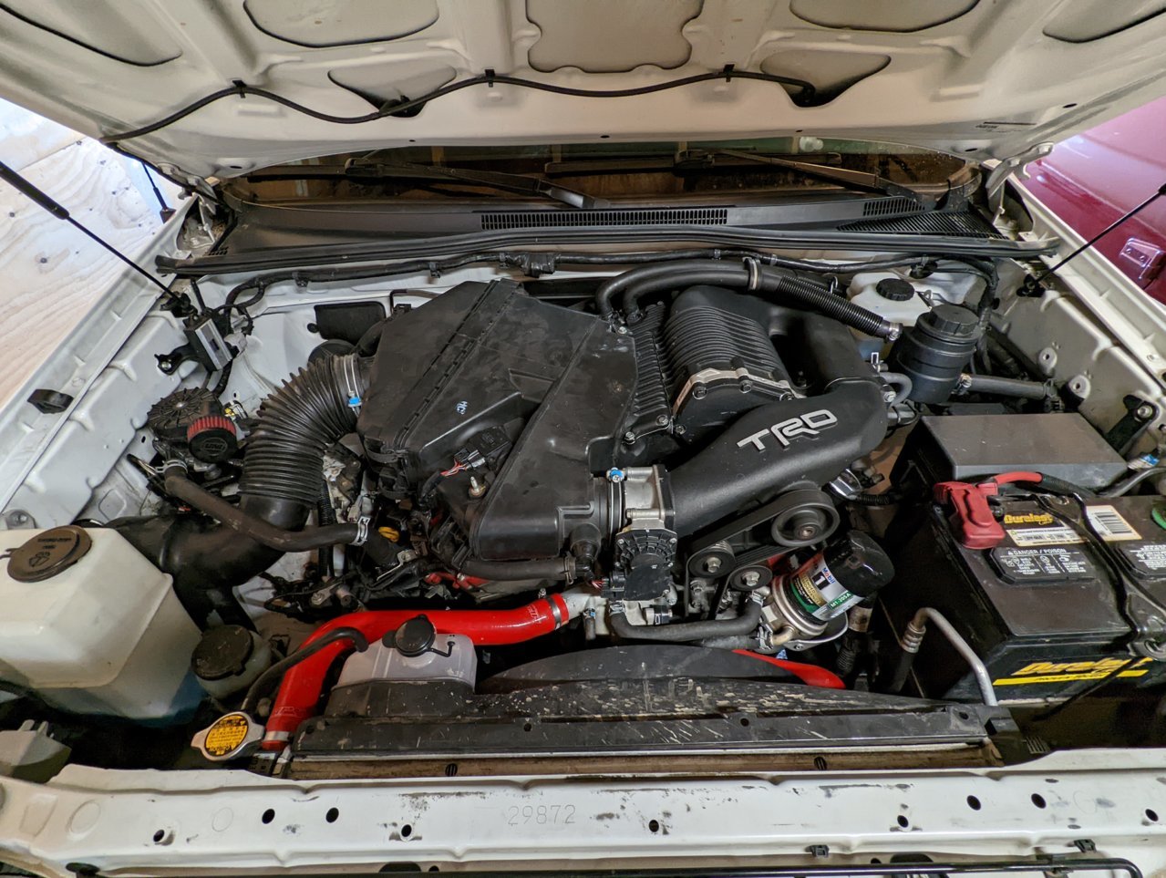

    Need to go clean it again, but the engine is back to stock-ish. Cam gears and lt headers staying in. But ready to sell
