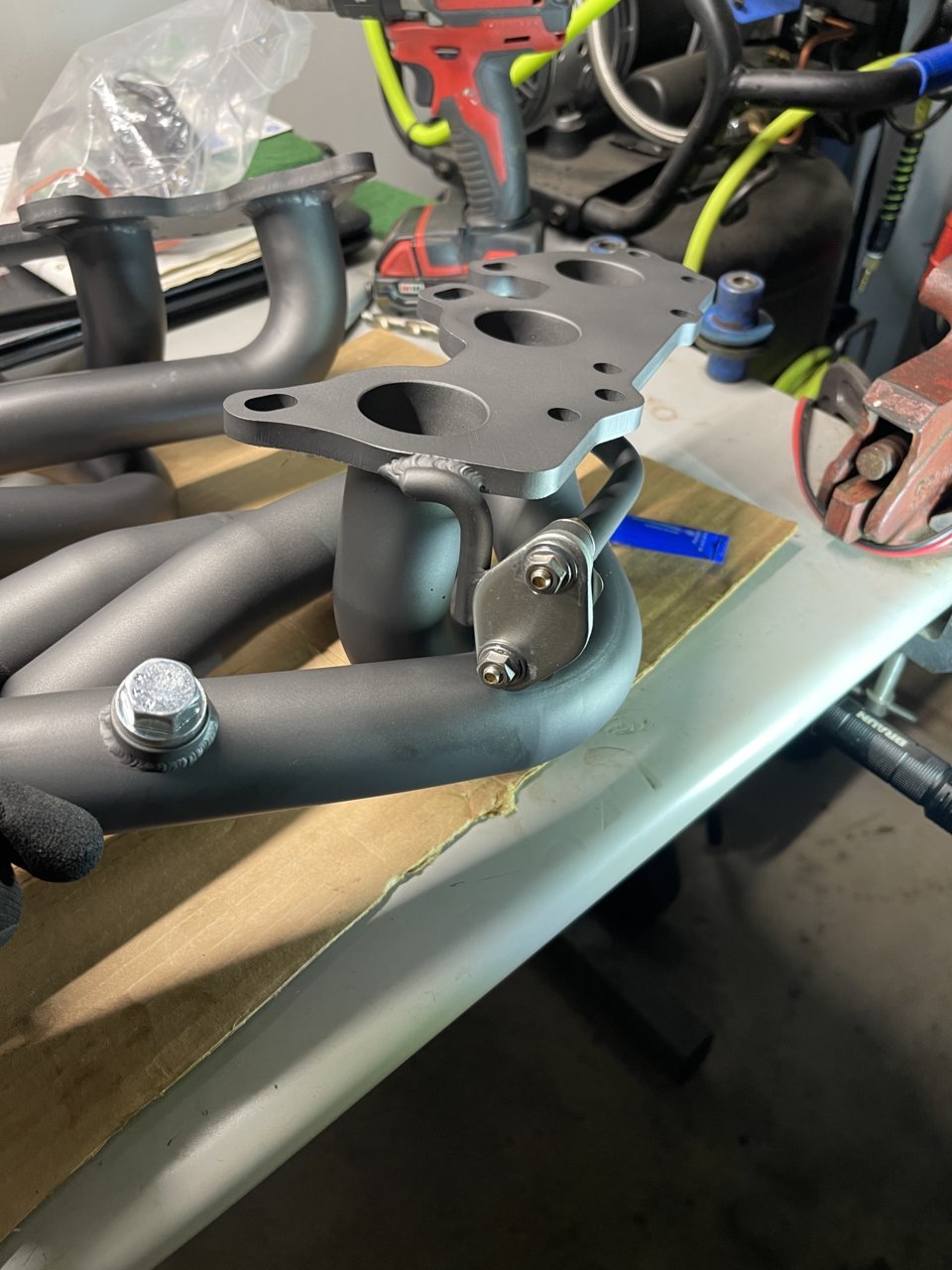

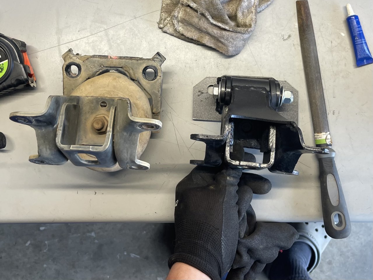

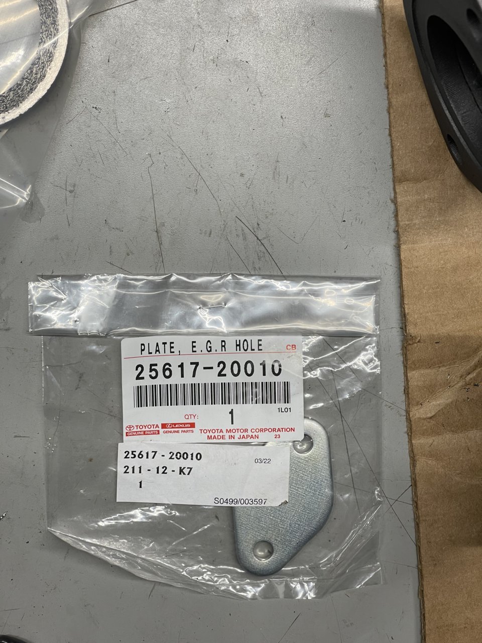

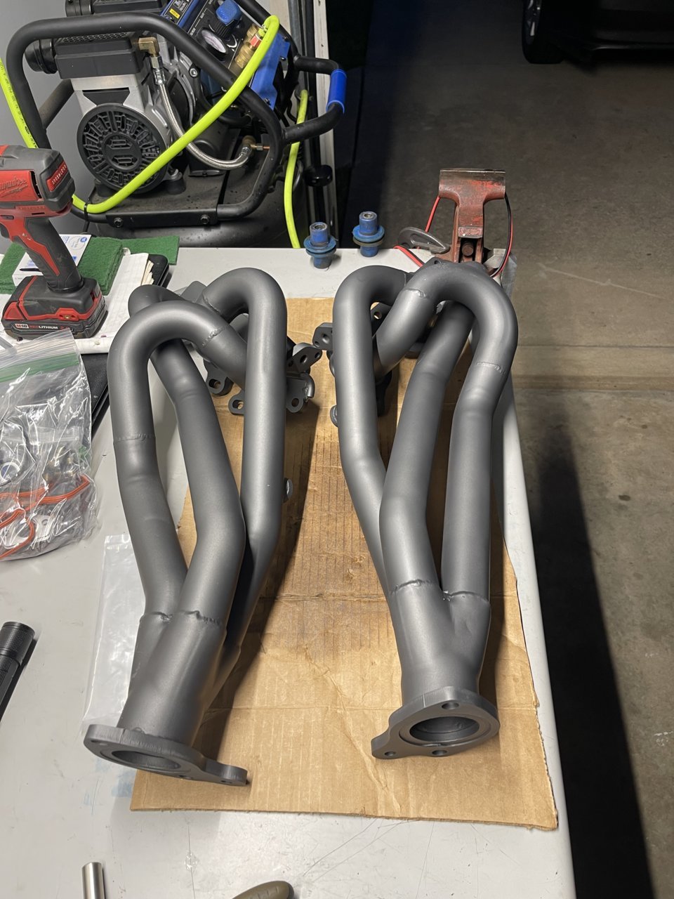

    We’re almost to the point of reassembling the engine!! Just gotta clean and prep the deck/block… New steering rack installed, solid engine mounts installed, cam gears installed, rebuilt the starter, new oil strainers and hardware in the heads, and got the SAIS block off plates installed on the URD headers… also had to chase the threads on the lower bracket mounting point on them. Used the plates below and drilled the holes out from 1/4” to 3/8” and they worked perfectly
    6E227A25-84D7-4075-9CBA-A6529DEE4C0E.jpg E4EC3F23-4B1B-44BC-BD35-052E9482137A.jpg 4F66941B-F164-48F7-8761-43A0432009F0.jpg 6F93E320-207D-44A2-B5D1-28781F8FA8DA.jpg
    BC0A9CC6-00E2-4FD4-9C7A-BFC87374BCD1.jpg AFFAF59C-7046-47D0-9613-00C83AFE89DE.jpg 3106F029-70CA-493B-933E-EA7AE3D8E80A.jpg 40AA3BF9-973D-4A10-B4C6-7F254EDEC256.jpg 48A2B7AA-89D6-4163-A231-A84E8D73575F.jpg

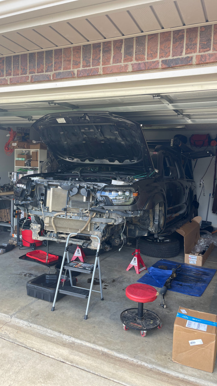

    I thought this group might be interested to see how my 440+ HP Magnuson boost adventures ended in the Gladiator:

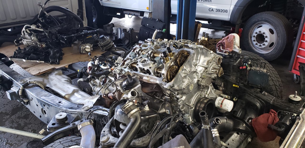

    I'm thinking a hole in the piston on #2 on this EcoBoost , we'll find out Monday when I pull the head off..
