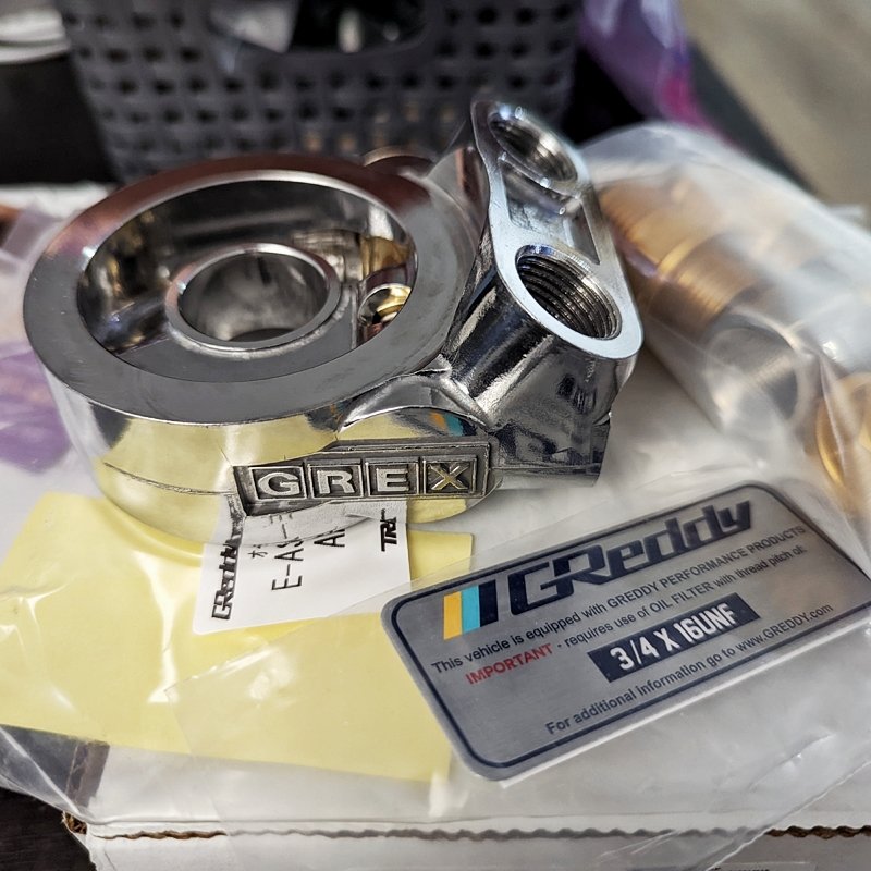

    @jamesepoop if you want to go the above route, hit me up. I have one of these TRUST (Greddy) oil plates.

    Thanks dudes. Exactly what I was looking for. I'll settle for a 2nd heat exchanger for the oil that should take less space and absorb a few degrees. Mainly just dragging my feet on installing lol
    Doh. I was looking for those. Ended up chancing it with an online vendor <vet owned business) and the thermo plate and box look legit.

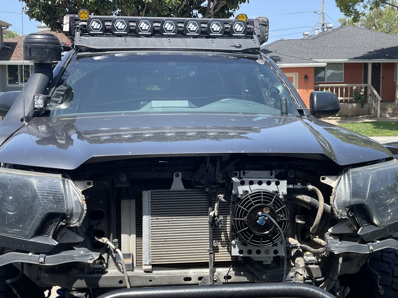

    Nice! I have the stock trans cooler but installing a single setup to replace the OEM trans cooler. Just mocked up for now.

    Looks good. I was going to try a similar set up with a setrab cooler but couldn't get it to sit as close as I wanted but I see your going to use it as a pusher fan? Are you going to use a thermoswitch or manual button for operation?

    You can use it as a pusher or puller fan but yes I’ll have it setup as a pusher setup. I have a Thermo in the top I let in the pic. But will also wire it up with a switch. Will kick on at 180 and turn off at 165. For now I’ll run inline with rad but may swap to direct later. once I get the main e fan setup.

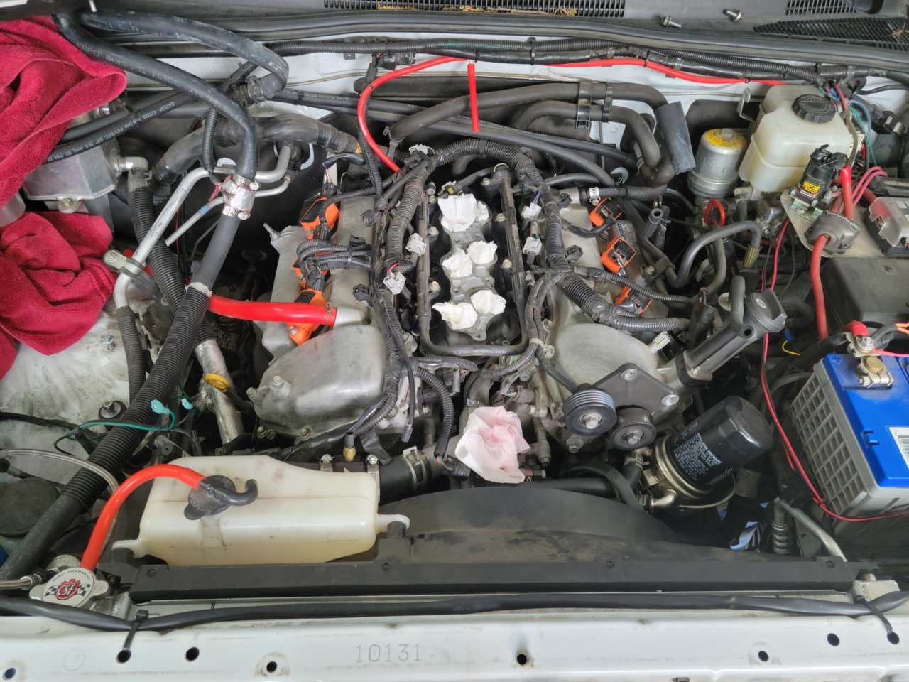

    Made some good progress today. Both head bolted on and torqued to spec. Got all the wires & hoses behind the heads buttoned up. Finished with the passenger side header before I had to break off for the sisters birthday
