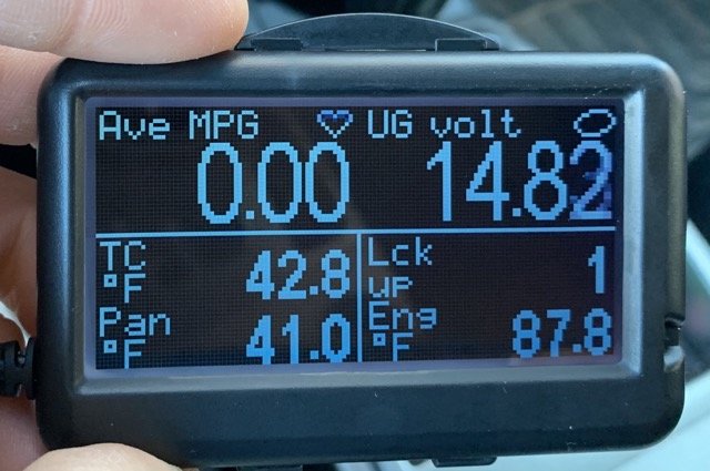

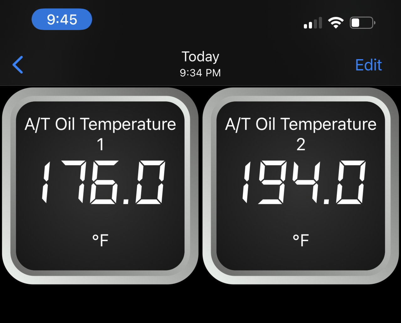

    Just finished up a drain and fill. Quote a bit came out which was surprising almost 5 quarts. I added some extra to account for the new trans cooler and let is drains. Overall fluid looks pretty good. Some darkness but still very red (was changed last year but had some high heat issues).
    Monitoring on the ultra gauge which is the one that I should pay attention to? I think Trans 1 is the TC and Trans 2 is the Pan but either way the lower of the 2 is the important one.

    I've always paid attention to the pan temp.
    nudavinci64[QUOTED] likes this.

    Not hot out but did a few pulls and hit some hills around town and TC topped around 202 but I could not get the Pan over 180ish in current conditions. I’d say so far trans cooler is helping big time. I’m hoping that the combine mix of it all was a fight that couldn’t cool. Once the trans would heat up it would warm the radiator and keep everything hot.
    wasn’t able to trigger the fan (185) so that’s a good thing but we’ll see ok a hot day.
    siting at idle after I got back it sat at around 149-150.
    also if anyone wants I got my ultra gauge setup for Pan and TC. I was comparing on ODBB fusion but also tie constant is nice.
    settings if you have a later 2nd gen.

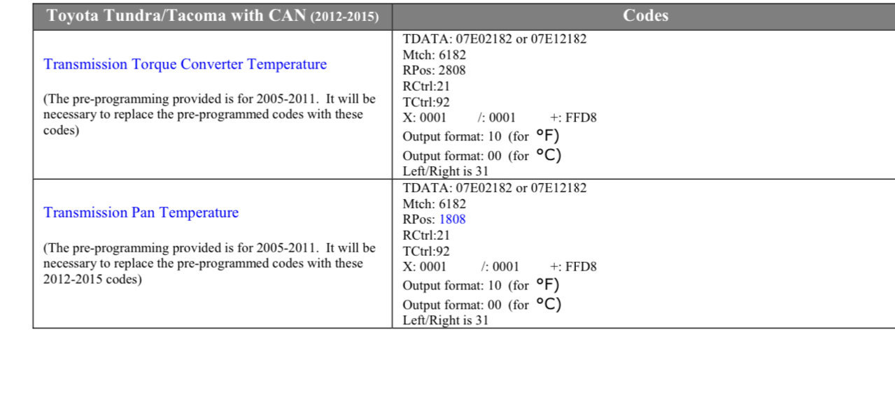

    never thought of looking up the lock-up value. The previous note on setting I found in the UG 1.4 guide from the company for the Pan. rather than guessing they seem to have those dialed now which I saw you had. I had not seen that one before. So super high was the TC for sure but even then the Pan was still high.
