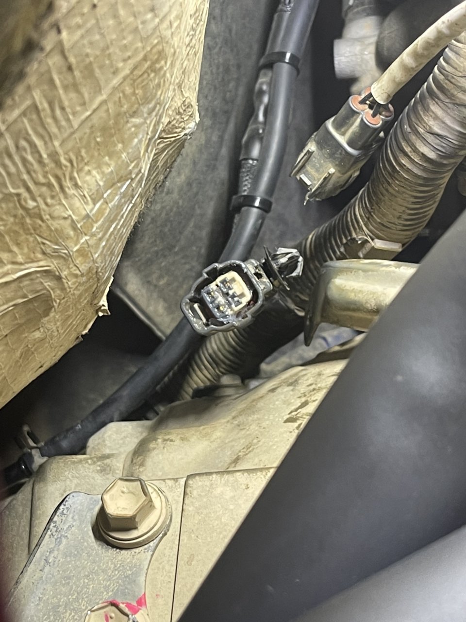

  5. May 5, 2022 at 12:24 AM
    HappyGilmore
    HappyGilmore LambTek Innovations
    Dec 24, 2018
    #276792
    2,978
    Huntsville, AL
    2013 SC’d DCSB TRD OR 4x4 | 2012 Lexus IS-F
    Yes
    Just a few small things to button up, some fresh fluids and she’s ready to crank…
    A couple questions, for the crank pulley, what are y’all using to torque it down? A tool or a few ugga duggas and some loctite?
    Secondly…. Those again with URD headers. Were able to plug the o2 sensor into the ‘factory’ location on the passenger side without an extension harness? No way in the world is it plugging in without breaking the wires… waiting on my extensions to ship with my replacement quick change pulley so opted for the factory location so I can start it to make sure it runs but it looks like I may not even be able to do that since the o2 sensor doesn’t reach… I’ve had a lot of frustration with these URD products…

  7. May 5, 2022 at 7:25 AM
    TodayWasTHeDaY
    TodayWasTHeDaY Hoser
    Jul 10, 2017
    #223673
    2,059
    Russ
    Calgary
    2015 DCSB SC M/T TRD Sport
    I needed the extensions for the O2 sensors. The headers should just ship with them as an option or state somehow that they are required.
    HappyGilmore[QUOTED] likes this.

  9. May 5, 2022 at 7:45 AM
    HappyGilmore
    Dec 24, 2018
    #276792
    2,978
    Huntsville, AL
    Yes
    Agreed… I requested them as compensation towards a tool I broke trying to remove the quick change pulley hub from the SC input shaft… he’s working on updating the design to avoid the problem in the future but gave me no timeframe at all so just wanting to run the stock locations for now… like I mentioned my experience has not been wonderful so far… have been waiting to see what the resolution would be without getting to deep into details on here
    thats the plan long term, need harness extensions and to figure out the passenger side sensor fitment issue. For initial startup shake down she’ll be sniffing from a single cylinder on each bank :)
  10. May 5, 2022 at 7:47 AM
    JustDSM
    JustDSM Oderint Dum Metuant
    Jan 16, 2015
    #146525
    3,261
    Justin
    Ogden, UT
    That'll be fine. When I first installed mine I drove home (3hrs) and for another week while I waited on my extensions. You'll be ok, just know your fueling might be slightly less stable. Nothing to worry about though..

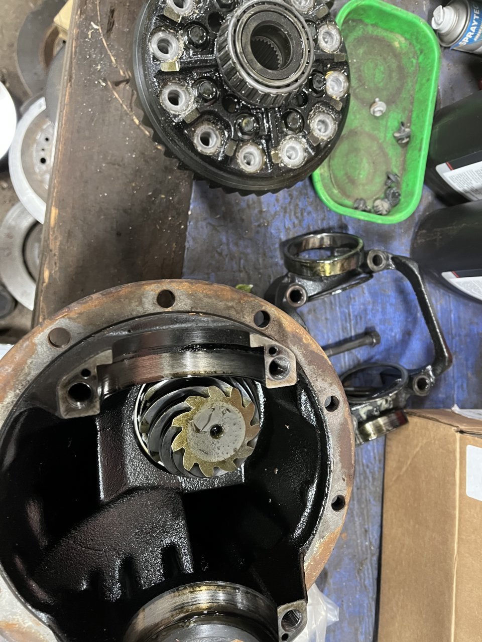

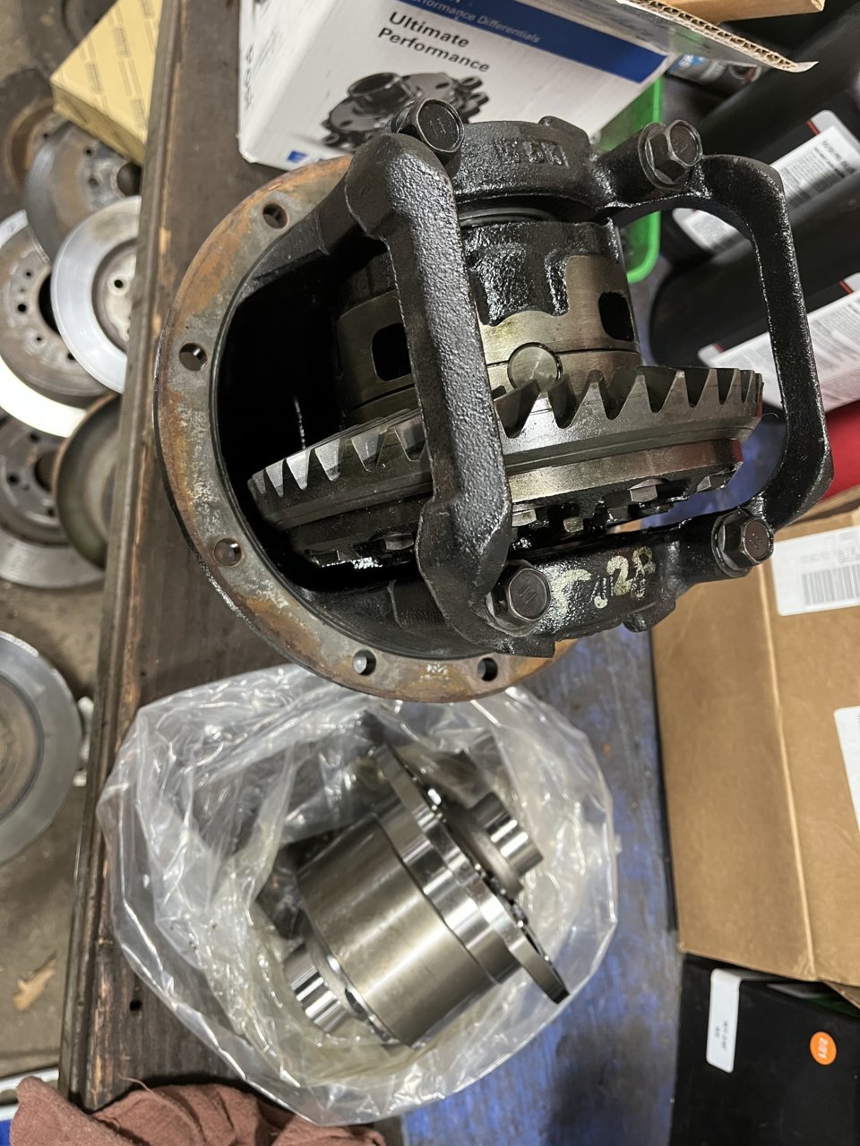

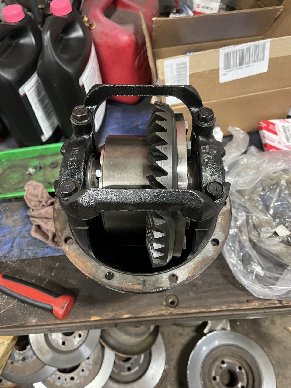

  15. May 5, 2022 at 8:25 AM
    o0opackersfano0o
    o0opackersfano0o Well-Known Member
    Oct 18, 2016
    #200102
    2,053
    Tony
    North Berwick, ME
    2005 xrunner swb
    Magnuson supercharger, 2.6 quick change pulley, 76mm throttle body, Doug thorley long tubes, urd y pipe, wot box with 2 step, 170 thermostat, airaid intake, urd short throw, djm 3/4

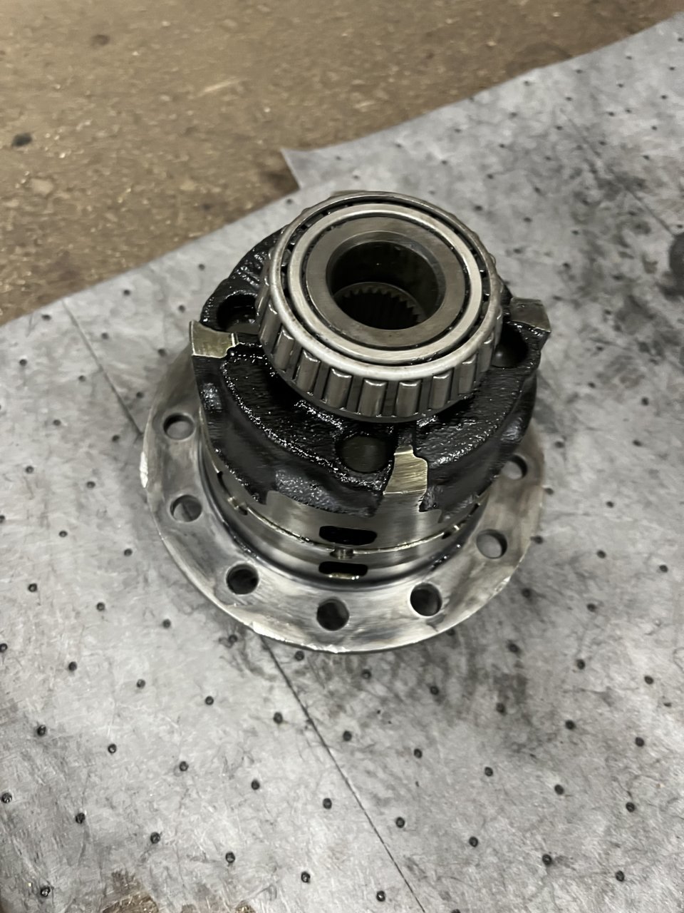

    Got the true trac in yesterday. Will be installing next week. What’s the stock lsd worth? BD146149-C7A0-491D-8CB6-9320B79C05F0.jpg5F39CB20-F88C-47E1-9A73-B5603994D5E5.jpgE69EAFD4-9981-42D2-ABF5-4D1AD7DC809C.jpg96520CE6-A872-4F42-A027-75421E573396.jpg

  17. May 5, 2022 at 8:25 AM
    Lucario Runner
    Lucario Runner Resident Truck/SUV racer
    Jun 29, 2011
    #59067
    7,196
    Robert
    San Antonio, TX or nearest race track
    06 Toyota 4Runner
    AFE stage II intake, APR X1, URD 70mm Throttle Valve (ported and knife edged), NST intake manifold spacer, URD spec U headers, Denso IKH20, URD fuel pump, APR fuel rail, URD Y pipe, URD spec u catback, lightweight water pump pulley, Greddy sandwich cooler plate, Earls oil cooler, IPT valve body, FJ TRD shocks, Cusco front and rear sway bars, Energy Suspension rear track rod bushings and rear link bushings, Carbotech pads, Stoptech ss brake lines, Stoptech slotted rotors, Motul 600 rbf, Limited Grill, Painted hatch cover by me, Painted valve covers by me, Cobra CB, TRD rad and oil cap, Escort 8500, Autometer oil psi and temp gauges, AEM wideband afr gauge, Flexpod, Pioneer 400w speakers.
    Tree fidy

  19. May 5, 2022 at 8:28 AM
    TheFang
    TheFang No Big Deal
    Jul 15, 2014
    #133985
    2,642
    SoCal
    Tacoma TRD Sport
    TRD Exhaust, URD Short Shift, TRD Supercharger, Hellwig rear sway bar, TWM shift knob, limo tint, URD Y-pipe, URD LT Headers, URD Rear O2 Sim, Custom tube front and rear bumpers, LED spot pods, K&N CAI
    It's only worth anything if you want it sitting in your garage for a hot minute. Post it up on Ebay. I had a OEM wheel bearing for my civic for years before someone bought it. But that was easy to store in a drawer.
    12TRDTacoma[OP] likes this.
  20. May 5, 2022 at 8:37 AM
    o0opackersfano0o
    Oct 18, 2016
    #200102
    2,053
    Tony
    North Berwick, ME
    2005 xrunner swb
    Anyone on here need it? Would rather just help you guys out.
