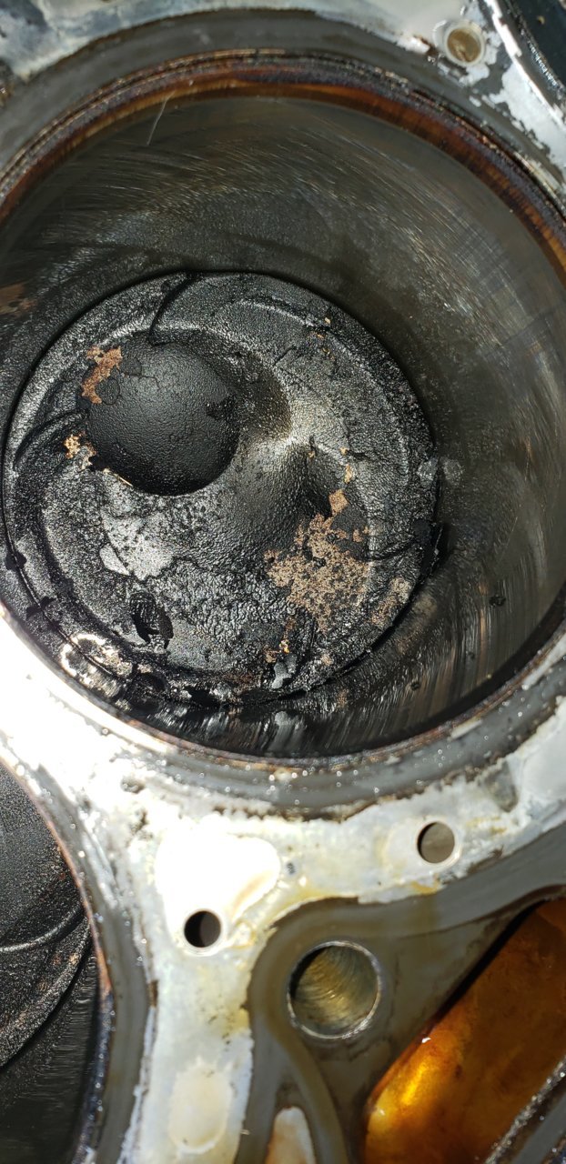

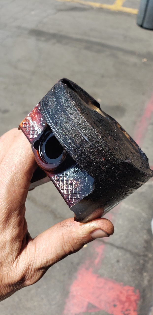

    3.5L Ecoboost with very low compression at #2, increased compression with oil added.
    jamesepoop likes this.

    So Ford beat Nissan at that variable compression engine huh...

    ...one way to achieve a VCR motor lmao. Just add layers of carbon at the rings ....

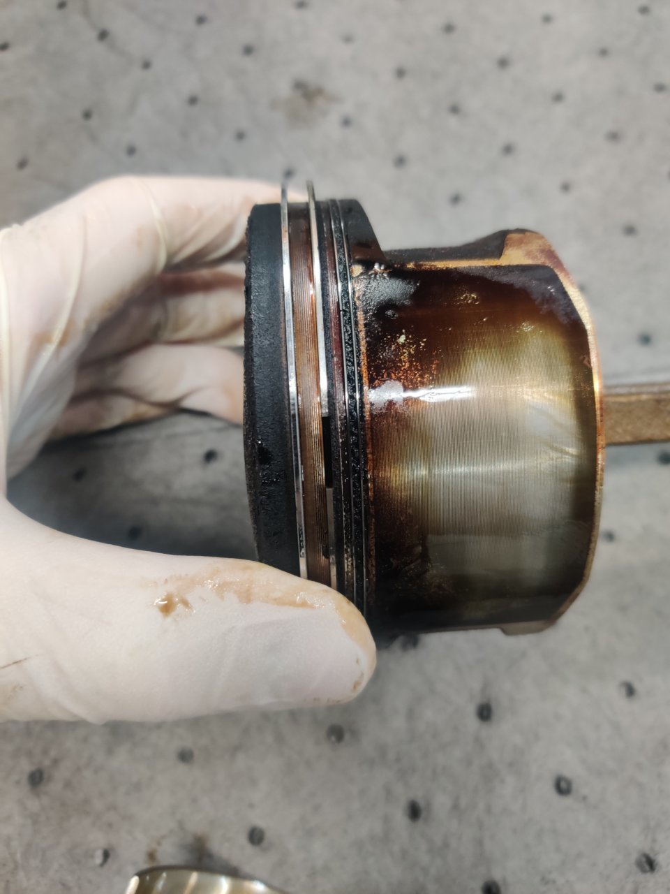

    Well that beats the oil ring on my engine. :pIMG_20211117_191150.jpg

    How many miles on that thing?

    70k-ish, typical fleet vehicle

    Direct injection?
    Why so much build up?

    This motor is direct and port injected (1each for every piston for a total of 12 injectors). System works pretty good as a whole. Pretty sure 2017 is the first year this was introduced on the F150 3.5L Ecoboost.
    This Carbon build-up is a one-off, I don't have an explanation yet. Top of the piston was thick and had flaky carbon, never experienced this kinda build-up before. The rings won't budge, even with force from a pick. Took a good while of cleaning and scraping to find the gap in the middle ring. The piston just kinda slid out without much resistance, shows how closed the rings were. And the top of the head/valves appears fine.
