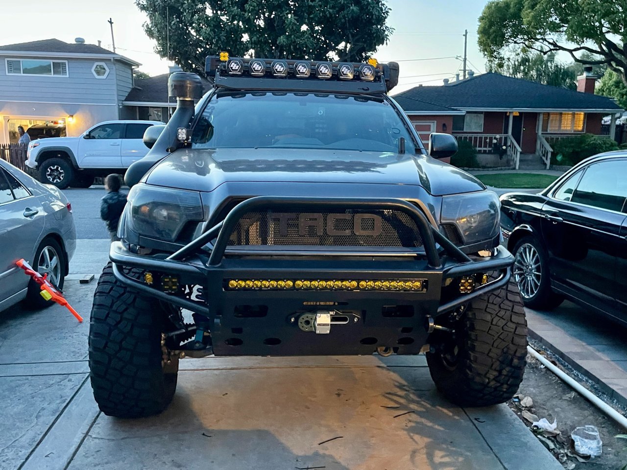

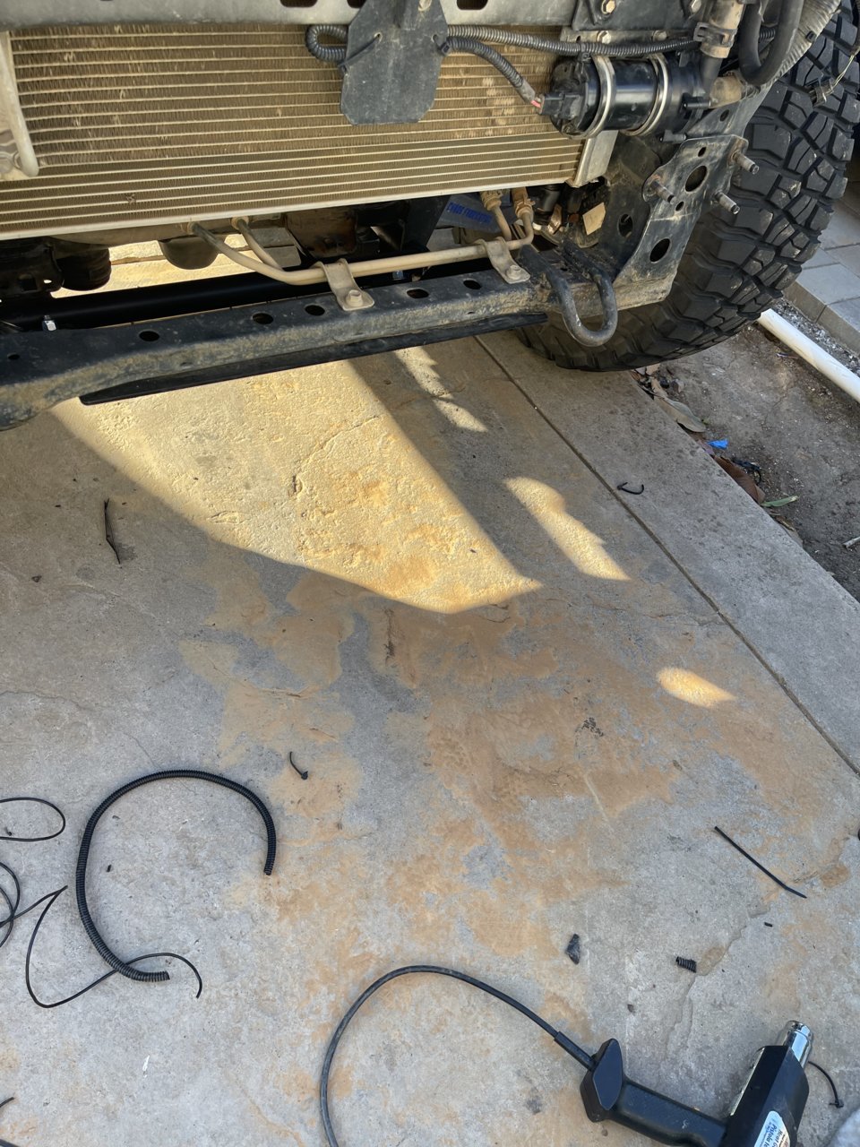

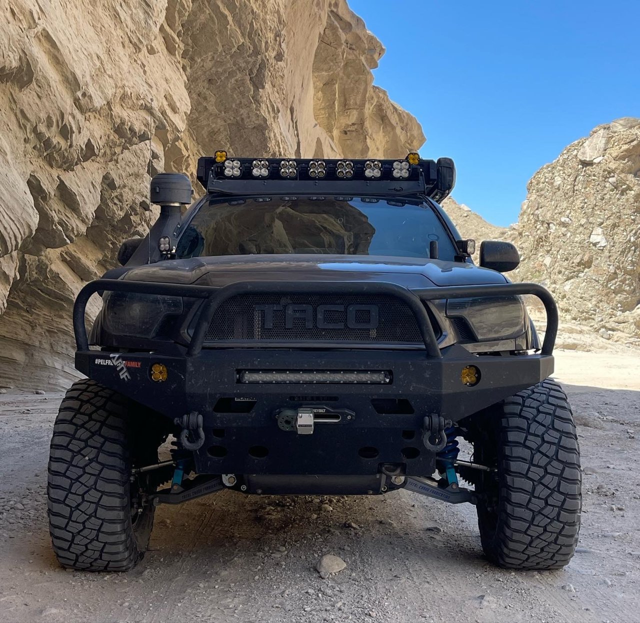

    Def working my way back. Its been cooler but driven it a few times and the transmission is much happier now with the new cooler. I just put a new bumper on as well so in general I am getting more airflow and bigger cooler so far helps. I jerry-rigged my new setup. It was looking good but naturally the winch just touched it. With some fitness and mounting the bumper slightly lower it works. Good thing it doesn't flex or it would be an issue. I need a better mount for sure but was able to reuse some of the stock locations and where I mounted my S/C pump.
    also rinsed the radiator since I had the front off. A decent amount of dirt on was sitting in the lower half blocked by the bumper and Likely more still.
    new front vs old front
    new
    Old

    That's one clean hybrid rally bumper. Digging it. You may have solved your overheating issue as well!

    Def digging it. I’ll miss the old one but hopefully it helps. still need to pull my shroud and redo it but so far so good. this and pending e fan I will be shocked if I still have heat issues

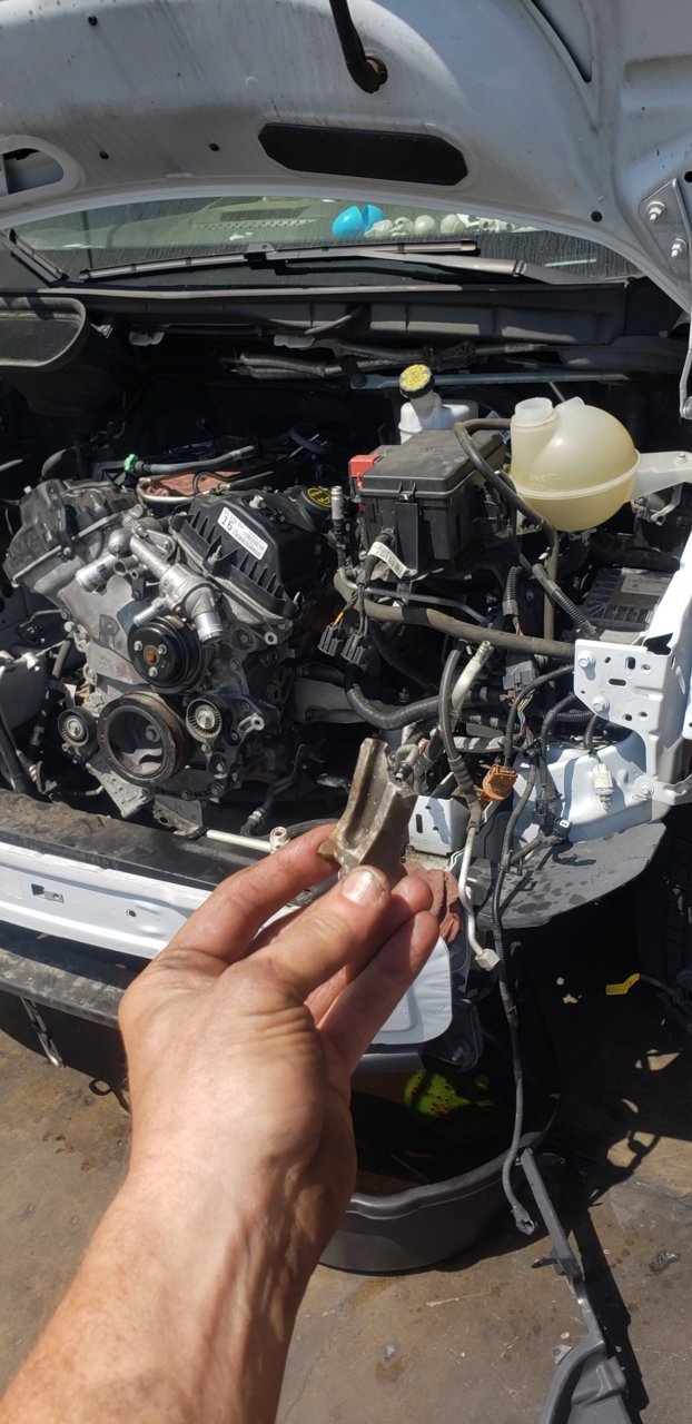

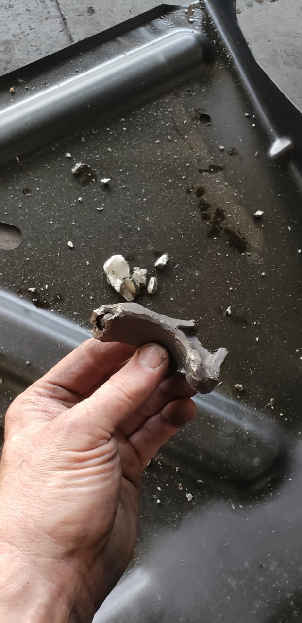

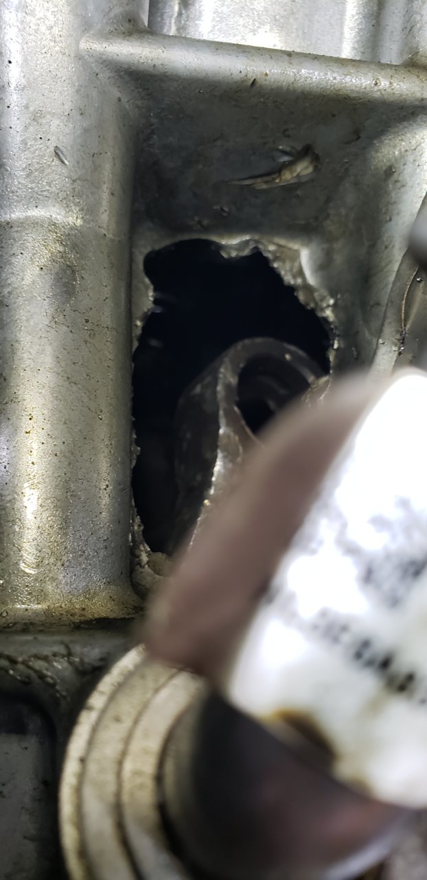

    More 3.5L Ecoboost carnage, on a Raptor this time..
    Connecting Rod shrapnel on top of the skid plate..
    #6 says :wave:

    More like peekaboom :violent::violent::violent:

    That just displacement on demand. No prob.

    What causes this? Too much cylinder pressure (or foreign object) upon piston movement reducing the volume and then the rod snaps?

    I haven't gotten far enough for the root cause, That's next week.
    I have 3 other motors going on at the same time to complete first..
    Replace a Jasper Reman that failed after 10k miles on a F550, Jasper motors are not what they used to be!
    The F150 with the piston..
    And this Transit that I've been waiting for a Long Block for will over 6 months that I finaly started this morning..
    Anyone guess on what's the cause of the knocking noise?
    Buut most likely the DI was stuck open and hydro lock occured.

    Which part?
    Bumper = BAMF
    Radiator = CSF
    Trans Cooler = Derale
