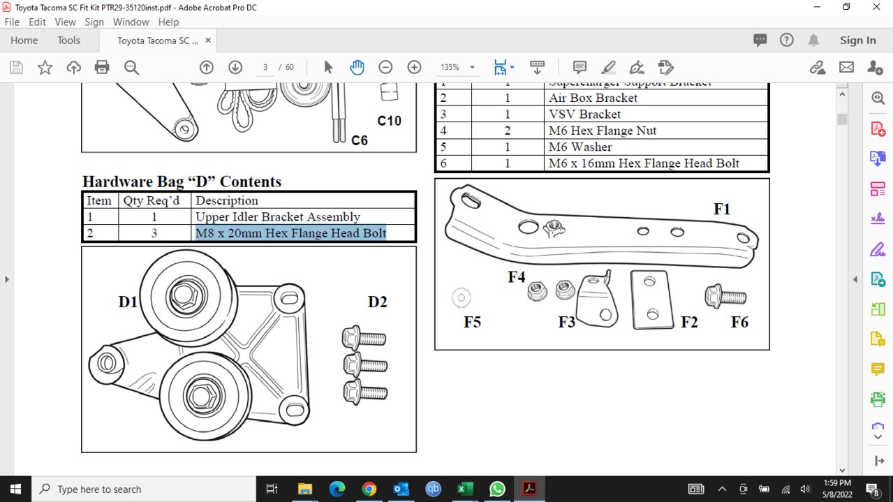

    Bolts: I'd like to remove the Roostfactor pulley wrap. - What are the specs for the stock bolts for the upper idler assembly? (I don't have these since the Roostfactor replaces them) ANSWER: M8 x 20mm Hex Flange Head Bolt

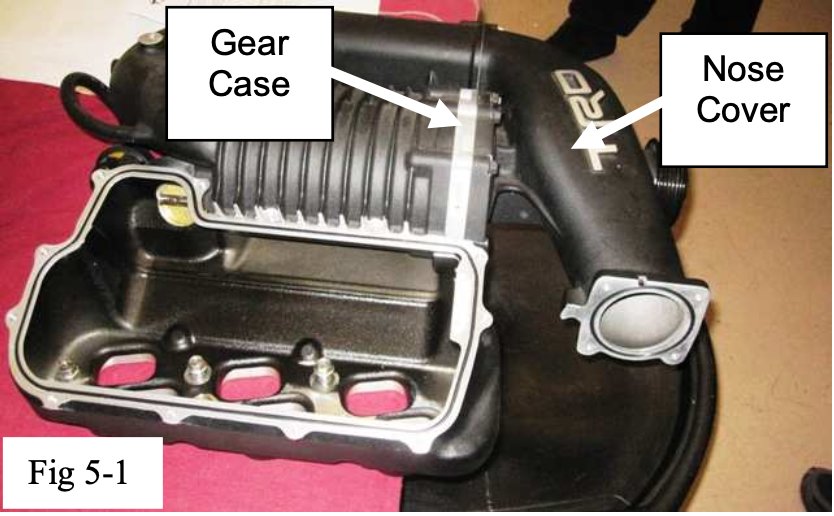

    Here's the snout oil change Toyota document T-AI-1178-D.pdf "Oil Service Kit PTR29-35073". The kit itself from Toyota is almost $300!!!
    We should probably add this on the first page in the maintenance section alongside the 3-part video series.
    A refill is only 120mL? I thought the recomendation was like two 4-oz GM Supercharger Oil bottles (this is 236.59 mL).
    There are also good photos and instructions on how to properly seat and align the spring loaded OEM coupler, which someone asked recently.

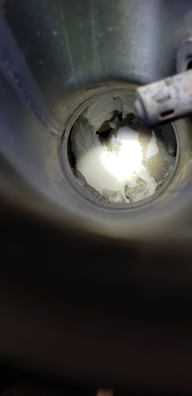

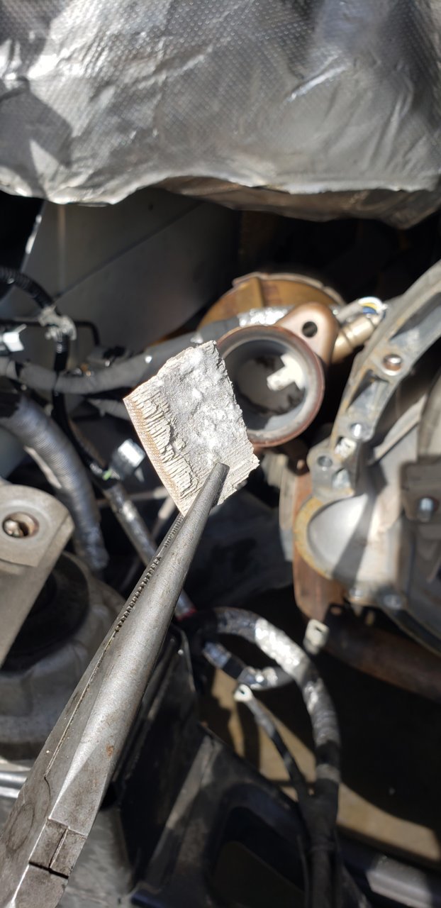

    So I'm aligning the torque converter studs to the flywheel on the Transit motor swap, and noticed that the cat converter is toast. I love this kinda carnage..

    If you are talking about changing the oil that you drain and fill through the little bolt holes in the front of the SC... (without having to remove it the SC) then just fill it back up till it overflows out the little fill hole. Mine came OEM with barely any in there...

    Because a little bit is left in the snout, I'd say it's more like 200ml for a change.

    It takes one bottle @JasonLee
    If it's dripping out of the top, then you are done.

    You got me wondering, I could have sworn I always use 1.5 bottles. I'm due for a change so I'll have to go do it and let you know...

    I used 1.5 bottles too. 1 bottle was not enough to drip out
