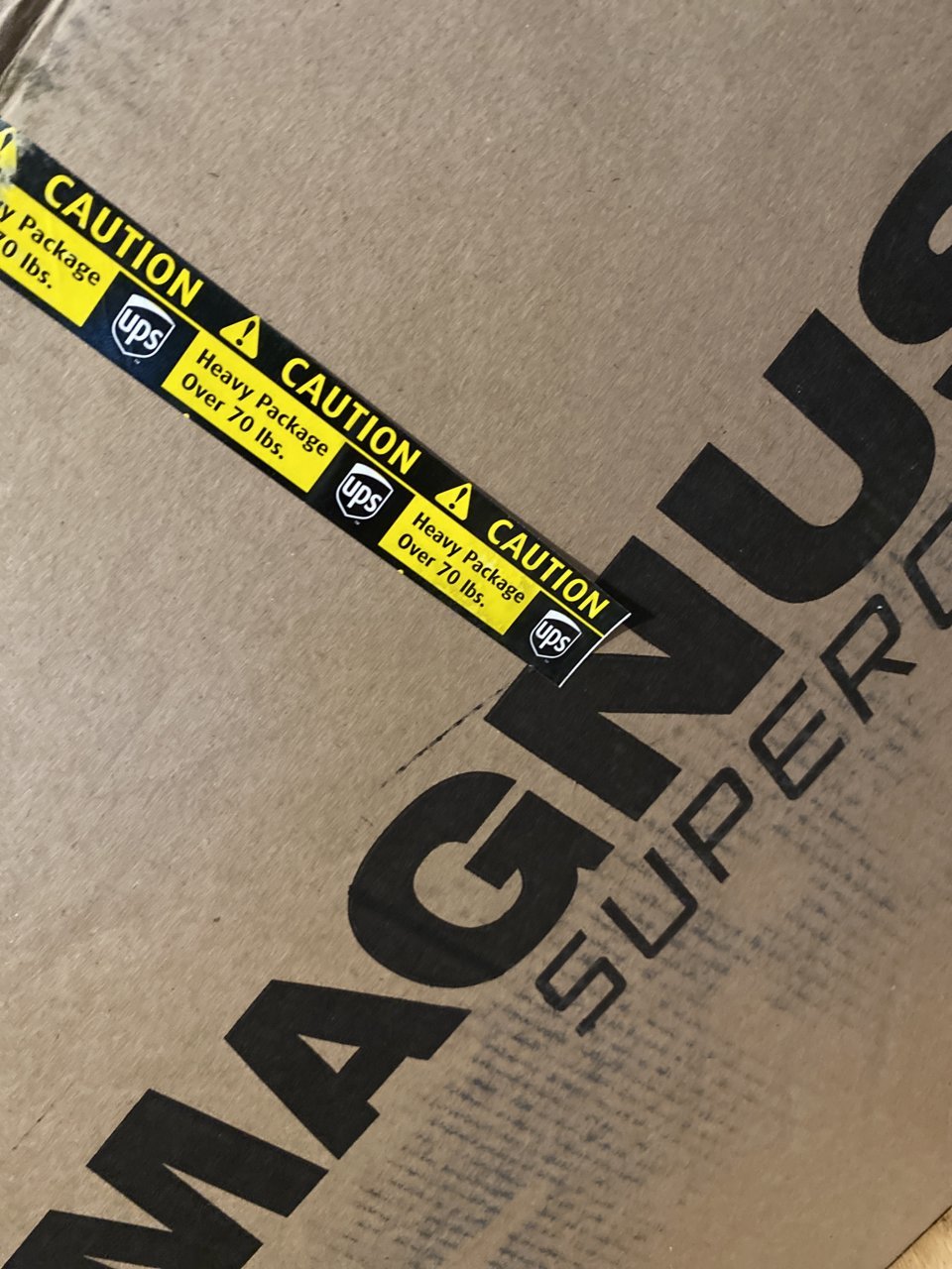

    Pretty sure I saw the shipping weight was 56 lbs. But I don't own a taco anymore, so I'm no longer a trusted source of information

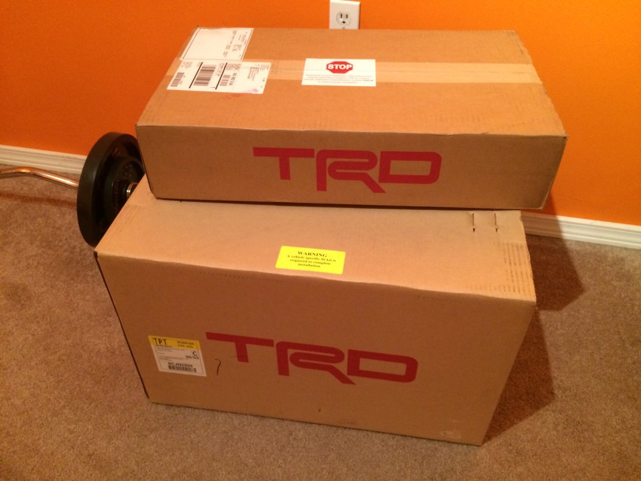

    IIRC it was just over 70lbs.

    Magnusun Supercharger SHIPPING INFORMATION
    • Requires Shipping: Item Requires Shipping
    • Weight: 65.0 lbs.
    • Package Dimensions: W24.0000” x H12.0000” x L12.0000”
    • Shipping: Free Basic Shipping
    • Shipping Note: This item ships in its own box.
    • Shipping Remarks: FREE continental USA ground shipping on ALL Magnuson Supercharger Systems!
    Unfortunately we have no winner in this week's contest in our Guess the Weight game.

    Didn’t it come in 2 boxes? The large Supercharger box, and the fit kit in a separate box. At least from TRD. I swear the 2 boxes combined were over 70lbs.
    Edit, yes in 2 boxes from Toyota.

    The magnuson kit is still in 2 boxes. I just weighed both boxes...97.9lbs Including the packaging material.
    The large box with the blower is 83.7lbs and the small fit kit box is 14.2lbs.

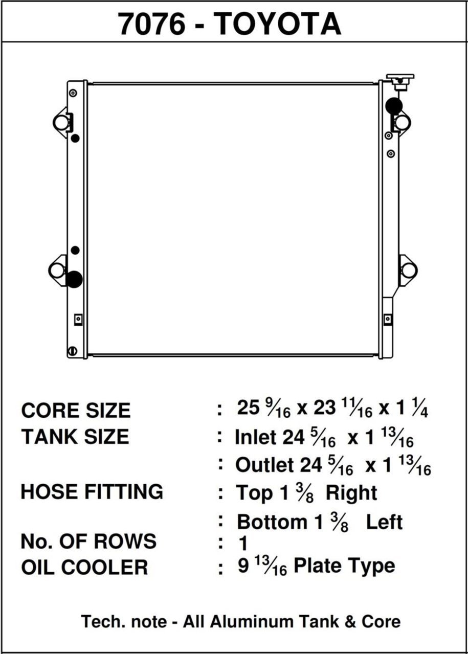

    Cool, so my increased front end weight over stock is probably still under 200lbs for:
    • Supercharger
    • Aluminum intercooler reservoir
    • FJ radiator/shroud/coolant overflow reservoir
    • AGM
    • Afe intake system
    and I’ll be dropping at least 16lbs up front with a new wheelset.
    basically, for aftermarket suspension I’ll probably go with “OEM weight” for the coil springs.
