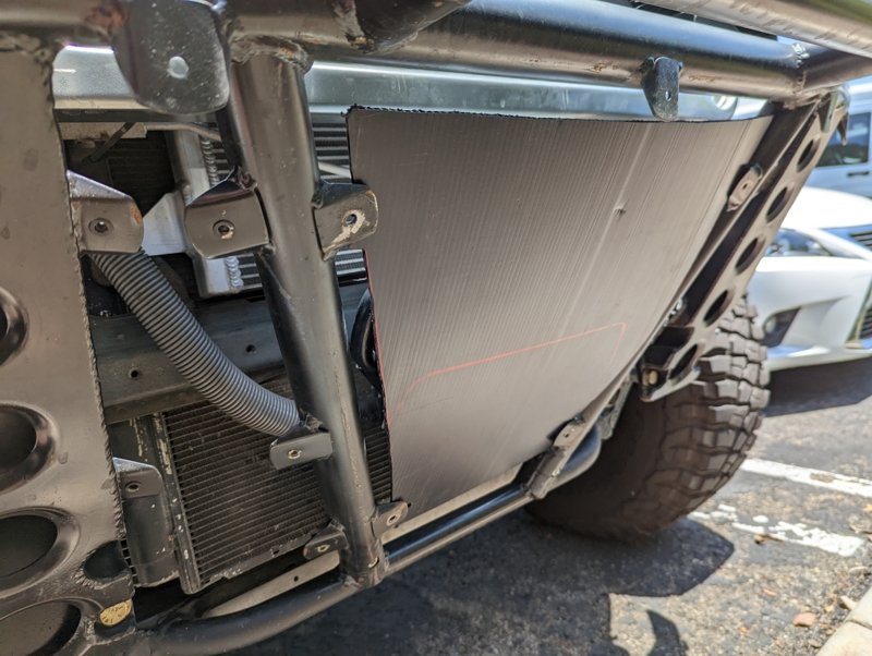

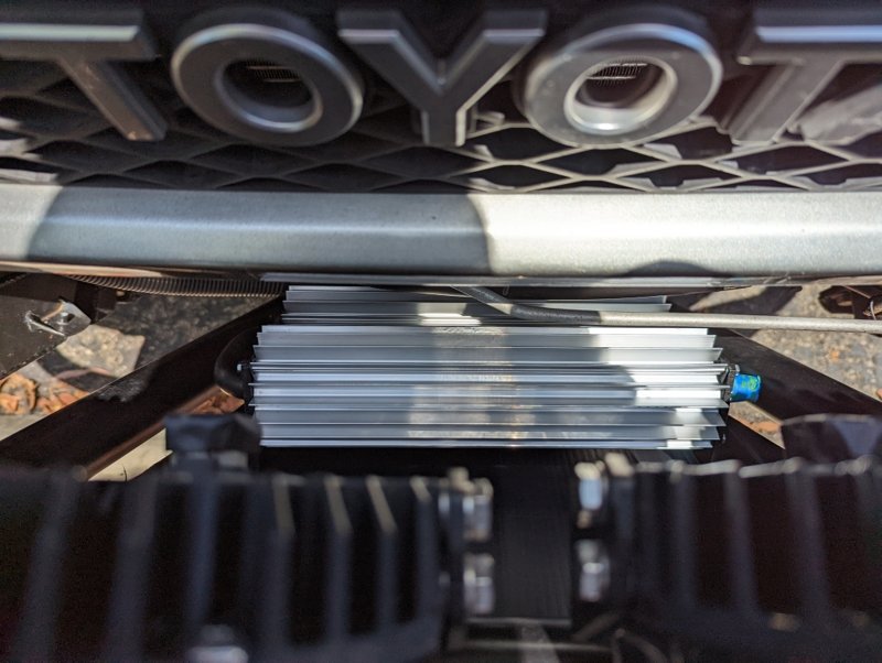

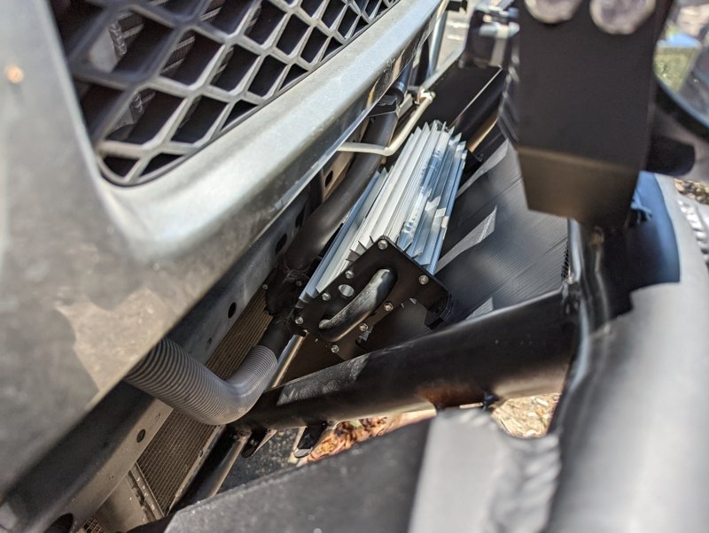

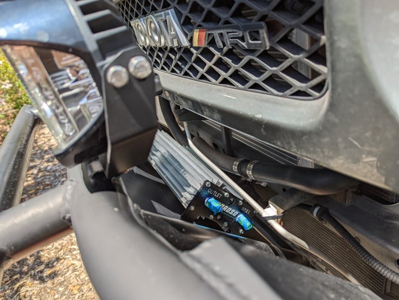

    If any one needs ideas on a trans cooler. I went with a dual pass heat sink for less turbulence therefore fluid flows back a little easier to the transmission. My understanding is that the tube and fin have more pass/turns to create more turbulence to pull out heat. Heat sinks are supposed to better when little to no air flow is present but when moving, will fully benefit. Preferred not to stack in front of all the radiators so I'll cut vents in the front skid. The black plastic board is mock up for the metal bracket I'll "fab". Above the trans cooler is enough space for an engine oil cooler
