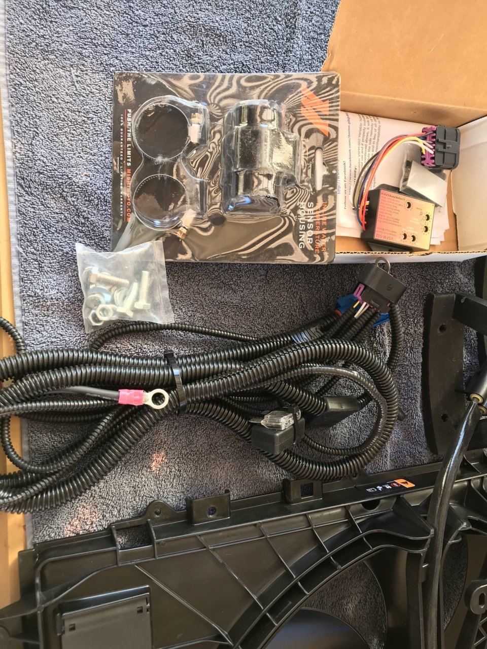

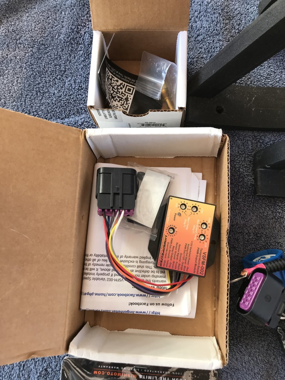

    For my setup, using the Camaro fan with GM 213-4333 sensor. All dip switches down, device select 0 and yellow PWM wire. Fan working good.
    I set the max speed temp to a high temp (250F). The engine will probably never see that so the fan won't be at 100% drawing 70 amps and constantly sounding like a jet engine..
    For A/C activation you can use the white override wire if you like cold A/C, dead battery and jet engine sounds. If those are deal breakers, the Autocoolguy Icebox or a PAC TR-7 can be used as a pulse stretcher to turn the compressor clutch signal from on-off-on-off-on into a constant input to trigger a couple of standard SPDT relays that will isolate the temp sensor from the controller and instead inject a chosen resistor value to trick the Lingenfelter into commanding a speed lower than 100%.
