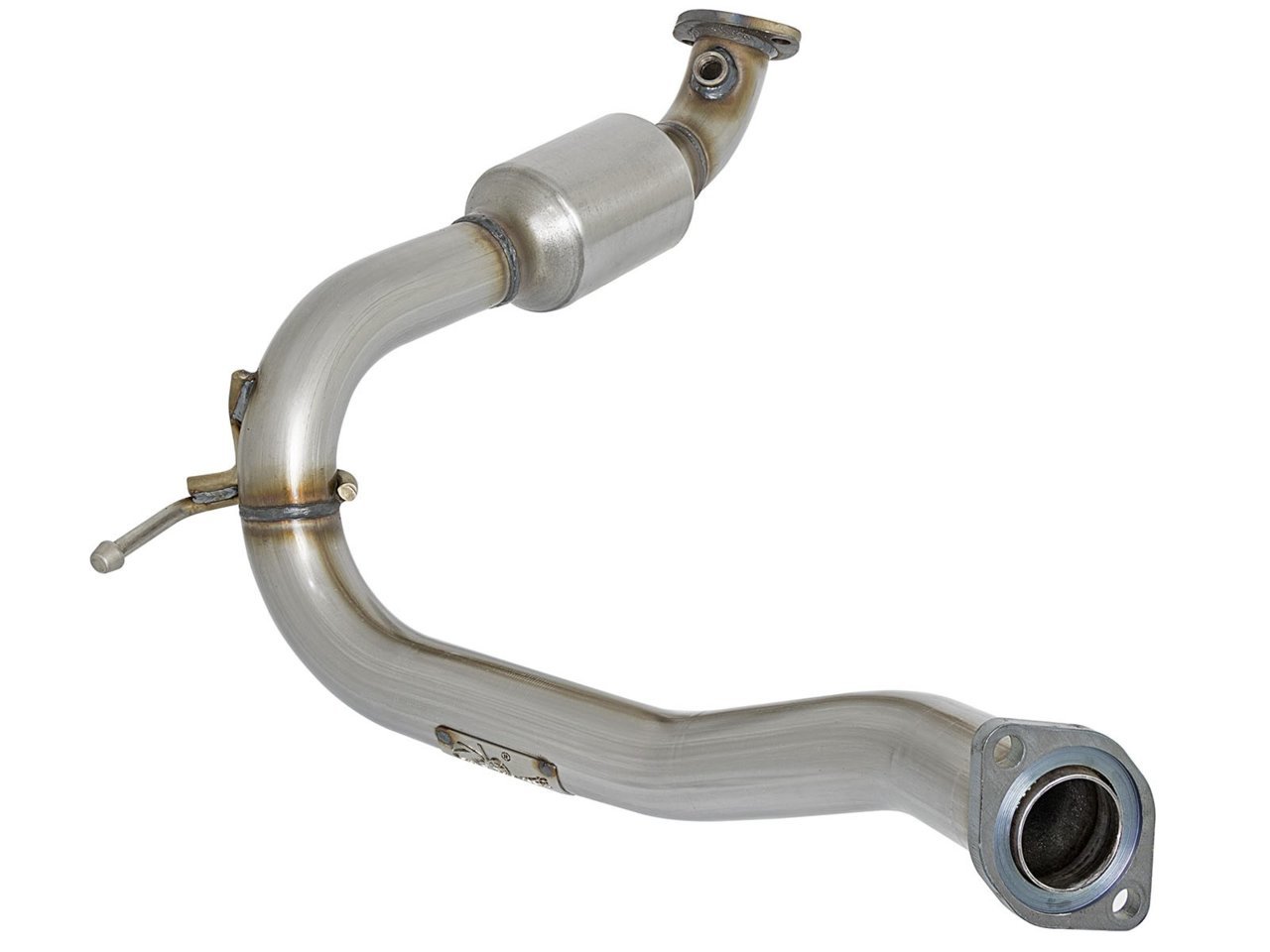

    Curious how that will work out. have you tried to smog with the GM cat? That may not pass and the Y won't either if they look at it. I figure keep the stock Y and just delete it until I need to smog. I have DT shorties I will add (pending carb). JBA no longer makes the 12-15 headers. Me and @12TRDTacoma both tried and basically they said no way will they ever make them again. they sold a handful a year and said it was not worth it.
    DT shorties they have been pending for a few years. SEMA helps them get approval but so far the state is not responding to any of the approvals it seems. I picked up anyway since better chance and if I have stock cats may slip by.

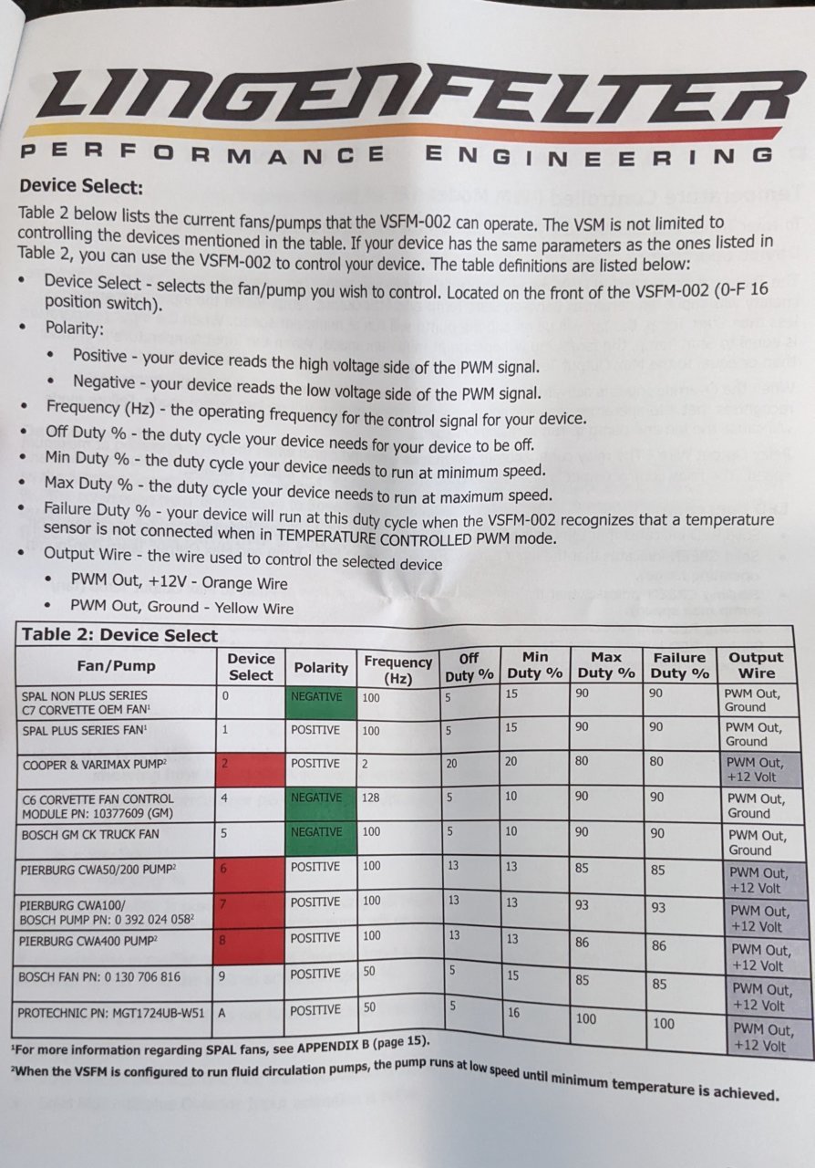

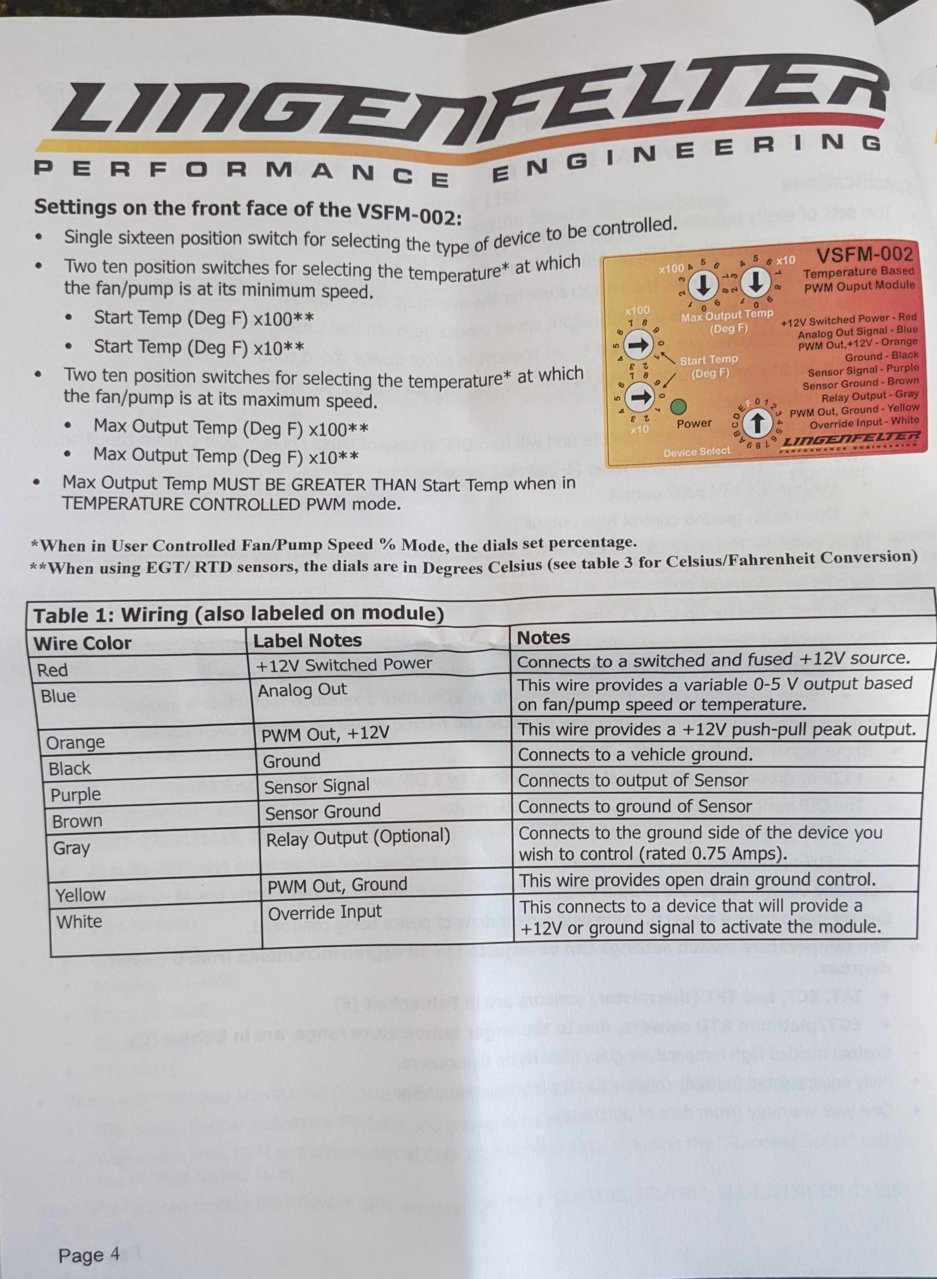

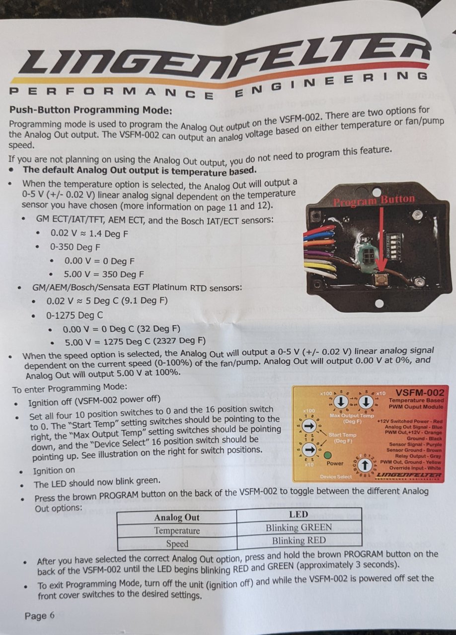

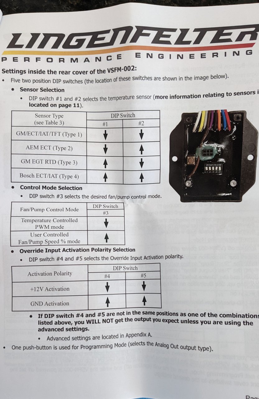

    @loginfailed I hope this helps setting up the Lingenfelter module. Mode 0 on the face of the module, AEM temperature sensor (unless you are using a different brand temp sensor), Corvette C7 SPAL fan, ground controlled PWM.

    Depends on the shop. I don't remember the shop rolling under the car. Nor do I remember them climbing in the engine bay. Possibly (someone correct me) ignition coil packs need to be OEM but the rips don't have a carb eo#. I had my Magnuson sticker on last time and no questions after he eyeballed but couldn't reach into the engine bay. Same for the y pipe, no questions on the DT y pipe I had at the time. I'll keep the stock y pipe until i can pass or not. My aftermarket cats don't have a CA tax stamp I'll get JBA carb stickers as well but hoping they don't roll under the vehicle to inspect further. The AFE ones look fairly stock but going to paint them in VHT paint and hopefully they'll weather some.

    Yep, thanks. I was originally using the settings for the plus series fan. That's where I went wrong.
