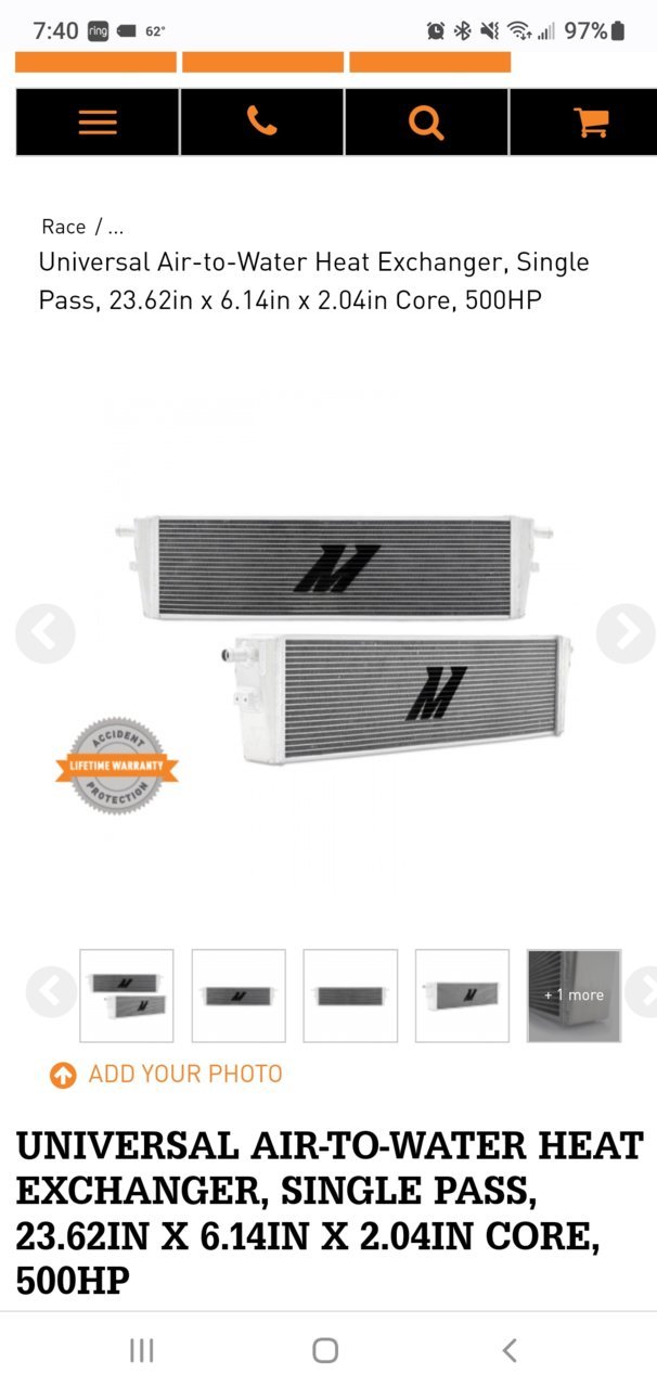

    o0opackersfano0o
    o0opackersfano0o Well-Known Member
    Oct 18, 2016
    #200102
    2,053
    Tony
