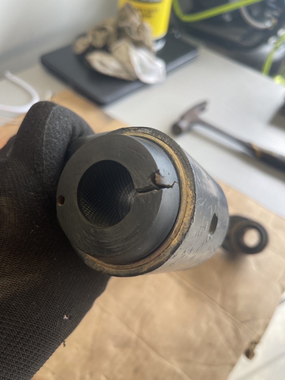

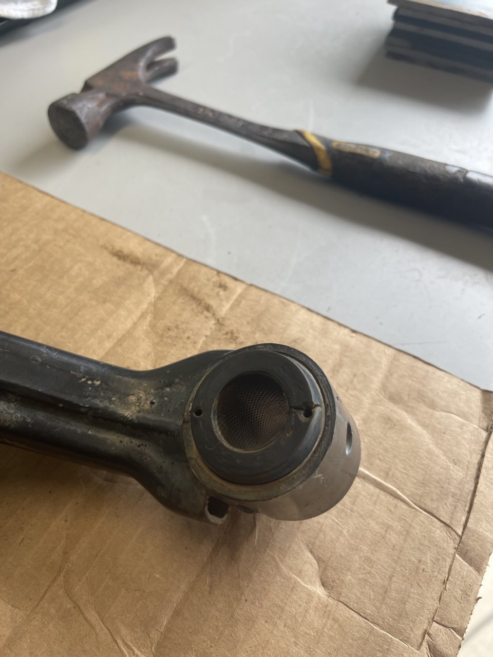

    Whitelines from what I read everywhere online were great. I just pulled my LCA’s after 31,000 miles of the whitelines being installed and had some splitting on some of the high stress areas. I honestly am not sure if there’s any bushing aside from a uniball/spherical bearing type would hold up to the abuse I put them through. Take my experience and do with it what you will. I am pretty confident if I drove mostly on the road and did light off-roading they would still be mint.
    All this being said I didn’t feel like dealing with replacing them right this second so I tossed them back on the truck. There is no obvious/excessive play even with the splitting.
    I’ll probably go with some MOOG LCA’s in the future to save myself the hassle or maybe JD Fab LT kit it’s honestly a toss up :rofl:
    As far as the ES stuff, I can’t comment directly for the LCA bushings but I’ll say I’ve had a trash experience with their steering rack bushings they offer… I could see them splitting and falling apart rather quickly in the LCA if you’re abusing them
