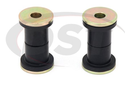

    I've ran Energy Bushings for years on everything on the Taco, including swapping out the rack bushings for Energy, and some on the Minitruck and don't have any issues or squeaks.. Conditions and Use are big factors I'm assuming. They haven't failed or worn.

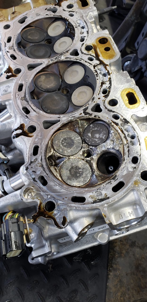

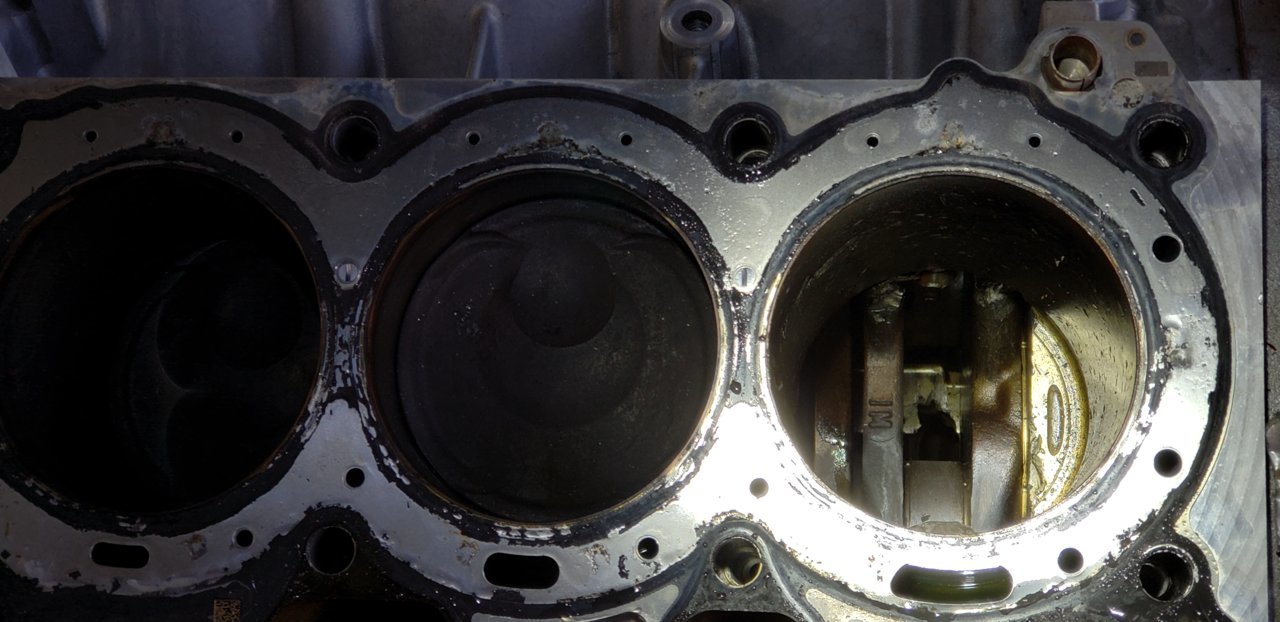

    You've scared me away from ever buying a factory turbo'd anything lol

    Man. Raptors look so cool. Say it ain't so

    I've never bought anything turbo'd for a reason.

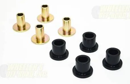

    Maybe you can suggest something different that I do... I have poly bushings still in my rack that are all whacked out, and poly bushings in my leaf springs that make noise - need to add zerks in the spring eyes when I put in my deavers... and I want to replace my engine mounts but just fearing poly at this point...

    Can you show me? I don't see either for rack bushings. Hopefully you see more than I do, and hopefully you aren't mistaken with 1st gen tacoma parts. I do see that whiteline has body mount bushings... but the kit looks identical in form to the energy one, and I am so much more happy with new OEM, I wouldn't consider changing to poly again for those at this point.
    https://superprousa.com/collections/all/2005-toyota-tacoma-base-esi6400396
    https://whitelineperformance.com/collections/all/2005-toyota-tacoma-base-esi4321788
    for some reason both websites list more products when you select 'base' models compared to prerunner or xrunner.
    conceptually, I don't like the poly body mount setup..too many parts and rubbing/contact of metal/metal is inevitable. I do wish you could body lift more with stock bushings... I'd totally take a 1/2" more of body lift if I could. OEM stock bushings have different durometer rubber front/rear/radiator for a reason, they aren't that expensive, and the front radiator bushings need to flex way more than the poly allows for, else the core support and fenders will take all the flex and start cracking. But, I digress, everyone that thinks poly is better is super convinced of it and since they spent money on aftermarket it must be the best thing since sliced bread. If stock mounts are collapsing after 100k miles,,, just replace them is my advice. I get it that others have different experiences. My truck is really heavy... I don't feel that I beat on it hard, but it does take abuse for sure. For me, OEM for the win on this one. And I am usually a proponent of customizations and improvements to factory parts.
    The big question, replace motor mounts with stock and get that kind of reliability for another bunch of miles/time, or go to the aftermarket poly and deal with more vibes and stiffness overall.... I want to like poly but I just keep having bad experiences.
    For my steering rack... I think I will put a new set of poly energy bushings in, since the stock are out already it should be easy to replace with the rack in the truck still... and this time I won't lube them. Maybe I had a bunk set of sleeves that didn't fit the bolts well, and perhaps they need to be dry/greasless, and get 'bite' on the metal that way,,, similar to how a CV boot clamped to a greasy axle will move and weep, whereas a dry axle will stay put and not leak...
    But then you have to lubricate some poly, anything with rotation has to have lube on the sleeve and shoulders else squeaking and wear are result. I dunno...

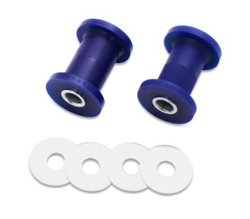

    there is this from superpro which should be compatible.
    https://superpro.com.au/find/superp...25-4wd-/productnr-SPF3144K/cid-999501237/vid-

    good find! it is interesting, different design, although similar, to the energy. Do you know anything on the difference in the superpro blue material compared to energy red or black?
    this has an added metal to metal point, possible movement or noise, where the washer can move on the sleeve. Whereas the energy is a one piece washer/sleeve, but an upper half and lower half. But the superpro has a single sleeve all the way through, instead of a two piece sleeve. So pros/cons...
    When the bushings are really stiff... you get a lot of feedback into the steering wheel, jarring. But that isn't the same as bump steer really. But the shock loads tend to wear out the bushing material. And when the whole bushing/sleeve moves on the frame, the whole rack shifts, and the steering wheel goes crooked until it gets knocked back. I have both problems right now lol.
    Thanks in advance for any real feedback on the difference in design, or material.
