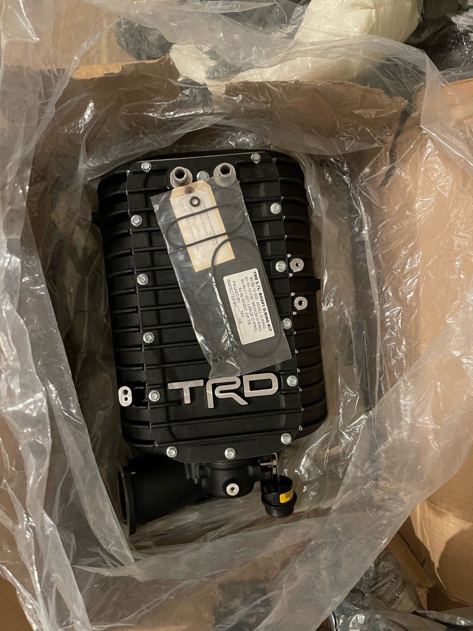

    Got a line on a new never used TRD S/C assembly for $3k for my Tundra. Fit kit is $2500 from dealer. Still about $2k less than new for a full assembly. Second in line for it but sounds like the fist guy may bow out.

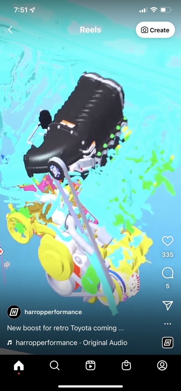

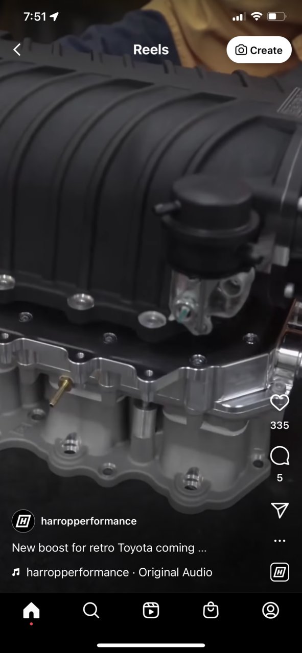

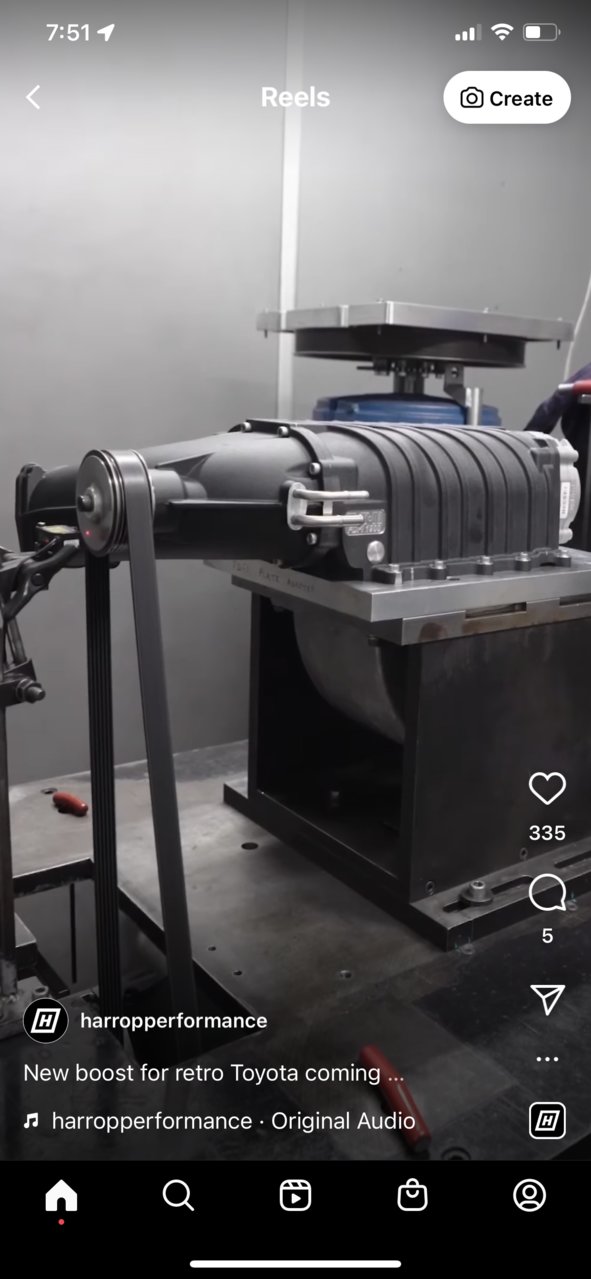

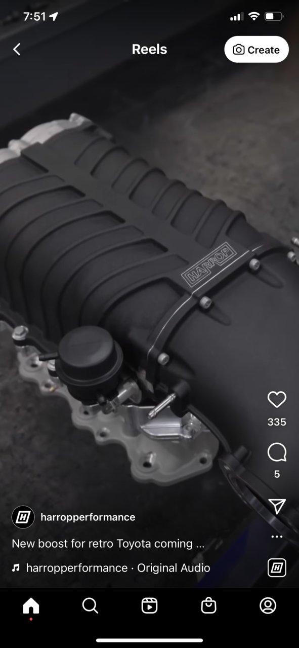

    Looks like y’all beat me to it. Remember when I was babbling on about something like this coming ?
    https://www.instagram.com/reel/CeN7WZxh2Lz/?igshid=YmMyMTA2M2Y=
    Is it the roller rocker or is it our “early” 1gr ?
    They say “Retro” in the description.

    Is this single vvti s/c have that much more to offer then what we all have now??

    The plenum isn't the only issue to resolve.
    Pulleys would need swapping over to a 6 rib and the thermostat housing would need to get modified as well.

    If this is for a single VVTi 1GR, the TVS1900 will have a good bit more headroom over the MP90 rotor pack.

    Sweet, just bought! I wanted the Harrop s/c but at a $2k discount I couldn't really pass this up. Can't wait to get it on!

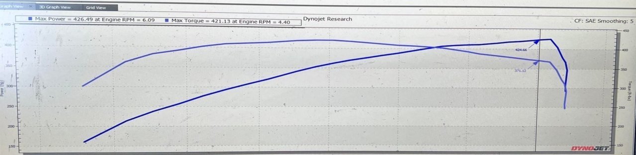

    Just made 426whp on a TVS1900 today. Leaning out (fuel pump needed) slightly and pulling some timing.

    What boost/pulley does it have?

    This was on a 4.0?

    100% Stock Magnuson Kit, I don't have boost data or pulley sizes unfortunately. I'll see if I can dig up the details on the upper/lower pulleys.
    Unfortunately not. 3UR (otherwise stock). The client stated the stock Magnuson supplied VF based tune made ~380whp. This was done on HPTuners.
